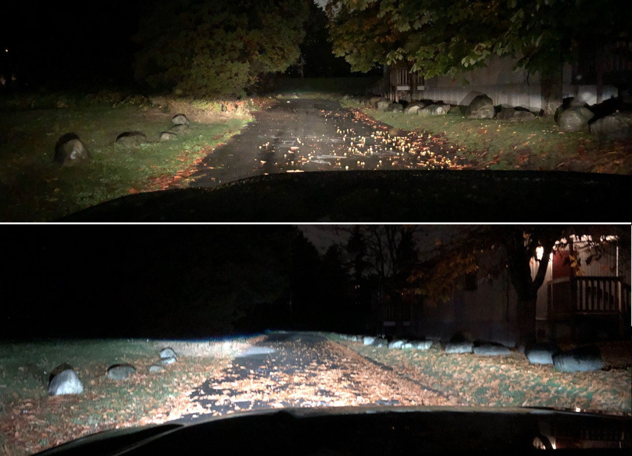

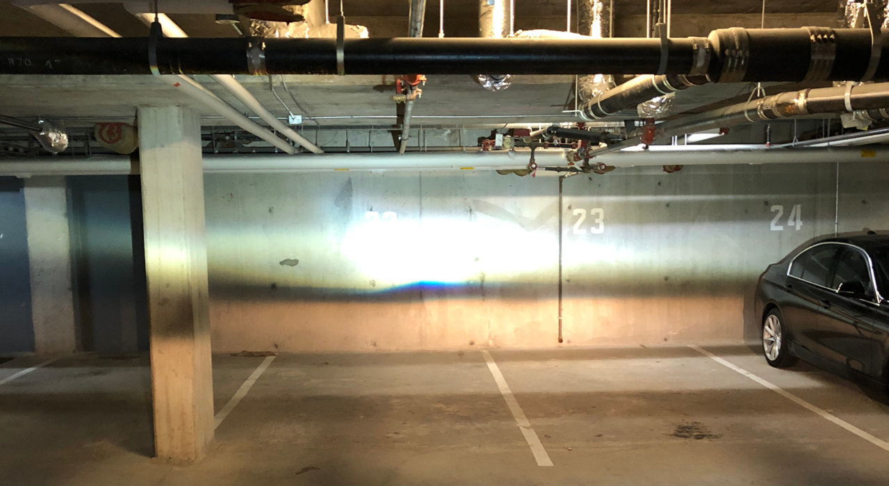

    I didn't touch my camera settings but hope these help for comparisons.
    RX350 STI-R Lens, Osram CBB D2S Bulbs
    1 HID projector vs the 2 stock:
    Full install:
    Video of 1 projector vs 2 stock
    https://imgur.com/a/eX62c3P
    COSTCOHOTDOG and Rome604 like this.

    Thanks man this is exactly what I was looking for! Looks like the light intensity from the RX350 blows away the halogens, I'd be real interested to see how it compares with factory projectors that have been outfitted with HID's.
    I think it's interesting that in the side by side comparison on the road, the light below the cutoff line seems very intense, but I can actually see more with the factory halogens. I'm going to hazard a guess and say that it's just an illusion created by the cameras exposure adjusting for the brightness of the HID's, therefore decreasing what is visible in the dark area of the photo.

    As you pointed out, the very first post in this thread shows a great side-by-side show of stock headlights vs RX350s. A bunch of other people have posted cutoff shots of the RX350s. Considering your stock headlights are the 'before' there's a bunch of 'after' shots in here. I think it's tough to accurately show the side-by-side because our phone cameras auto adjust to the brightness which negates the increase in the upgraded light output.
