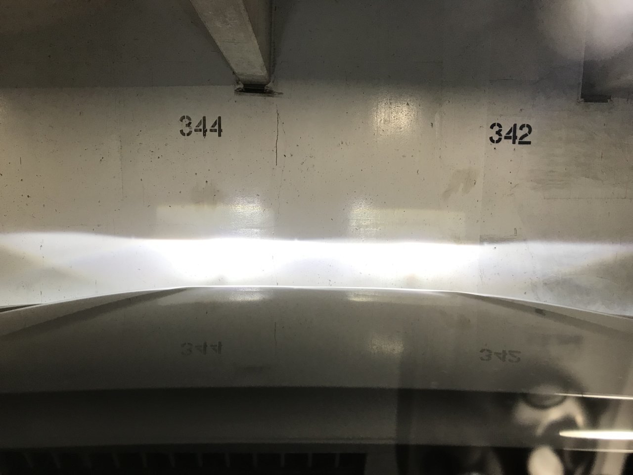

    The first post in the this thread is a comparison that compare BOTH stock low beams to a SINGLE RX350 projector. It’s quite obvious from that picture that the light output is brighter than the factory stock halogen bulbs, but I just think it’s a weird comparison to compare one HID low beam vs two halogen low beams. It’s not really an apples to apples comparison.
    I’m not sure where the myth came about that putting HID’s in projector style headlamps causes blinded drivers. The whole purpose of projector headlamps vs reflector headlamps is that the projectors maintain a distinct cutoff line so you can have intense bright light below that line while not blinding oncoming traffic. The beam pattern does not change, it still maintains a great cutoff line and if properly adjusted, will definitely not blind oncoming drivers. I will fully agree that it’s not as good of a solution as a total retrofit with RX350 projectors, but it still works very well. As long as the measured distance from the base of the bulb to the filament (or in an HID case, gas chamber) is the same, the beam pattern will not change, it will only intensify. Attached you’ll see some pictures of the HID kit I installed in my truck for the time being until I can have the truck not usable for a few days, and as you can see, it still maintains a great cutoff line (albeit not as crisp as the RX350 projectors) and definitely doesn’t blind oncoming drivers.

    I’ve had both an HID kit and now a proper retrofit. There is no comparison between the two. My current setup is far superior in output than the Morimoto HID I had before.
    You have to “see” to believe.

    It's not going to blind oncoming drivers but it isn't proper either. To me the best part of doing the RX350 is getting what basically is a second set of high beams. If you are opening a set of lights to do the BHLM then may as well upgrade the projectors. If you aren't planning on doing the BHLM then to me it's not that yuuuge of an improvement compared to the effort to do it and it'll still be illegal even though it's the correct way to do it

    See how your beam pattern curls up on the sides like a smile? That's a problem for oncoming traffic. Keep in mind, just because you're not being flashed doesn't mean you're not blinding people.
