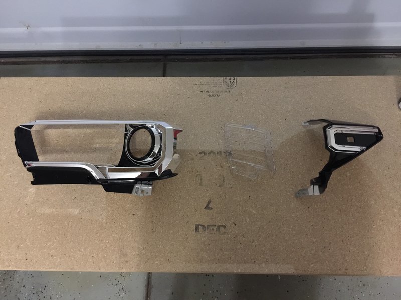

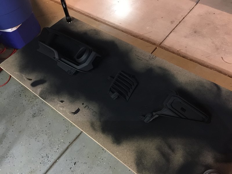

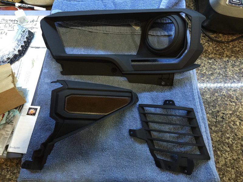

    Making progress

  8. Sep 28, 2016 at 8:19 PM
    #68
    MESO
    MESO [OP] Major Modder Vendor
    Feb 16, 2015
    #148809
    16,294
    State of Jefferson
    2016 DCLB TRD HELLCAT SWAP
    Whatever you do- don't touch the inside of the clear lens!!! Use compressed air to blow it out right before resealing it back together. Looking good! What paint are you using?

    Noted! Thanks for keeping tabs on me...I need it. Krylon plastic bonding matte black. What did you use?

    No prob. I used the same paint. did about 3 good coats.

    Looking better every hour I spend on it.

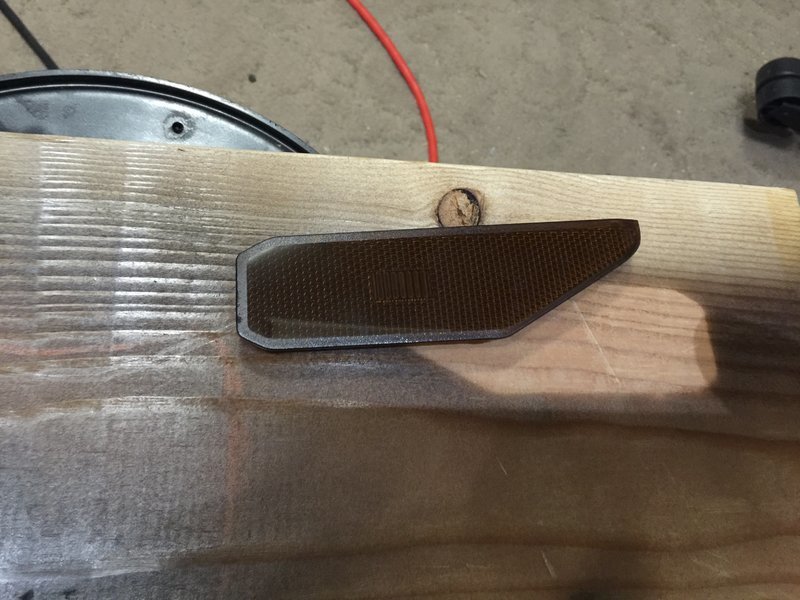

    what did you use to spray the amber side marker?

    Same as OP, krylon lense tint. Walmart 5.88. Worked amazing
