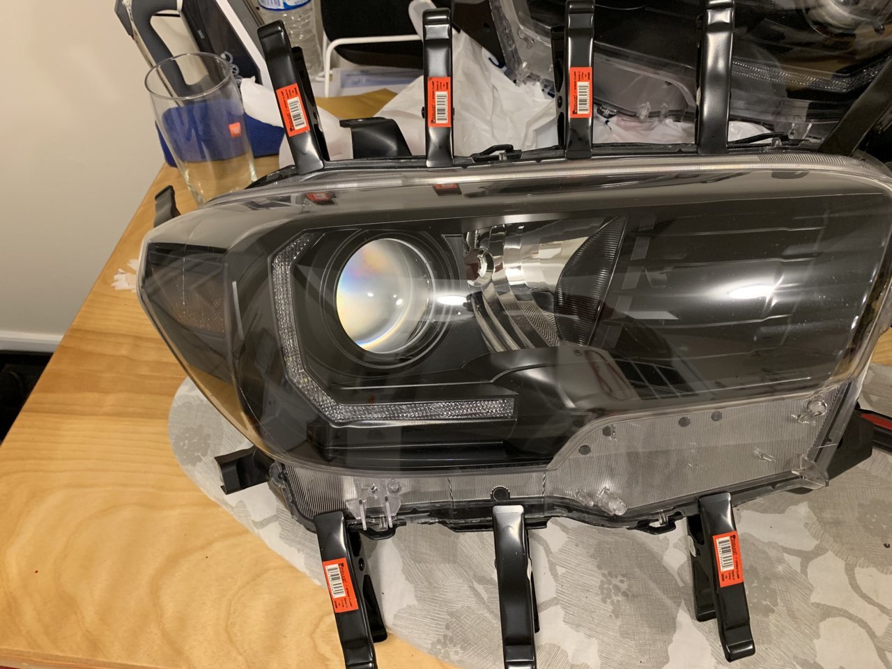

  18. Jan 11, 2019 at 5:20 AM
    #838
    Dee1seven
    Dee1seven Well-Known Member
    Jul 31, 2017
    #225491
    341
    RVA
    '17 DCSB TRD OR - Quicksand
    '15 TRD Pro Bilstein Suspension HS 3 leaf AAL TRD PRO Wheels 285/75r16 BFG KO2’s Truxedo Soft Roll Up cover
    How are you guys getting the silver lense bracket/holder to properly line up with the outer trim ??
    It is super difficult to get them to perfectly line up so they don’t look off center, the picture below is not my light but you can see what I am talking about. I had this issue last night as after I sealed them back up and I noticed the misalignment. I reopened them (thank the lord for butyl) and painted the lense bracket/holder flat black to hopefully try to hide the misalignment of the bracket

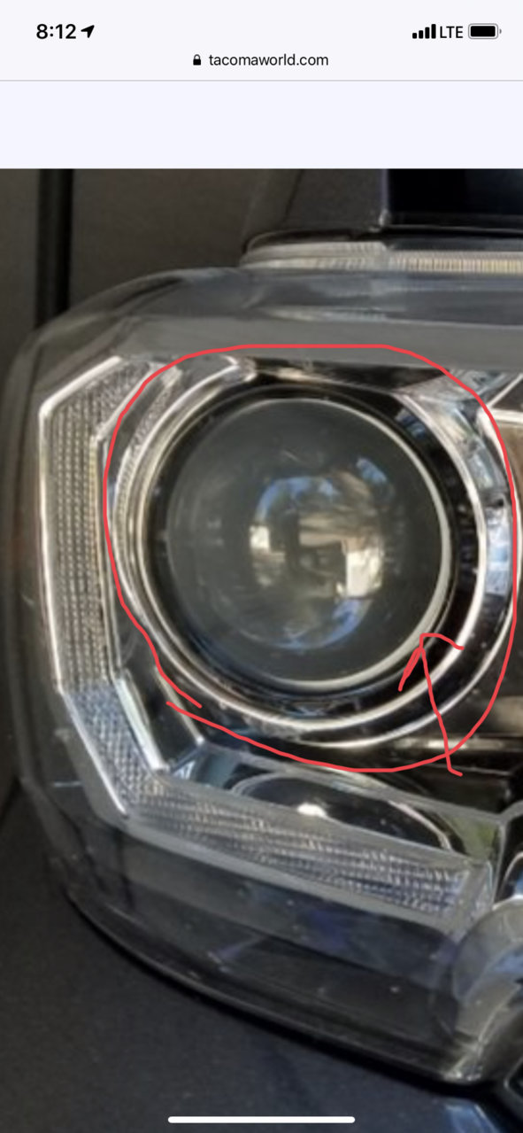

  19. Jan 11, 2019 at 5:22 AM
    #839
    Dee1seven
    Jul 31, 2017
    #225491
    341
    RVA
    These are my lights before I reopened them but you can kind of see the misalignment of the silver lense bracket

  20. Jan 11, 2019 at 5:51 AM
    #840
    no vtec 4me
    no vtec 4me Well-Known Member
    Jan 29, 2017
    #209016
    1,596
    Kevin
    West Chester, Pa
    2017 Tacoma TRD Sport
    There’s not really anything you can do about that. That silver part is what moves to aim/adjust the beam pattern, so when they’re aimed correctly it’s going to be where it needs to be regardless of the bezel.
