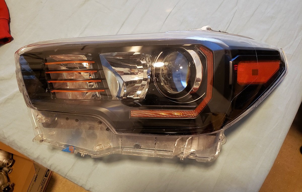

    Messing around:

    Love the amber tinted DRL. How’s the color in front of the stock white LEDS?
    The acrylic strips are a nice touch on the turn bucket fins. At one point I was going to make those illuminated but never got around to it. Would look cool in the amber.

    I've changed the stock white to amber also, so they're full-on amber.
    The strips will be illuminated and aid with signaling. Can't wait to get it done :)

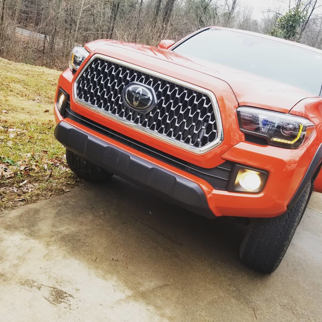

    I did mine like you are talking, the white it's somewhat noticeable but not badIMG_20181230_154515_046.jpg
    20tacoma17 likes this.

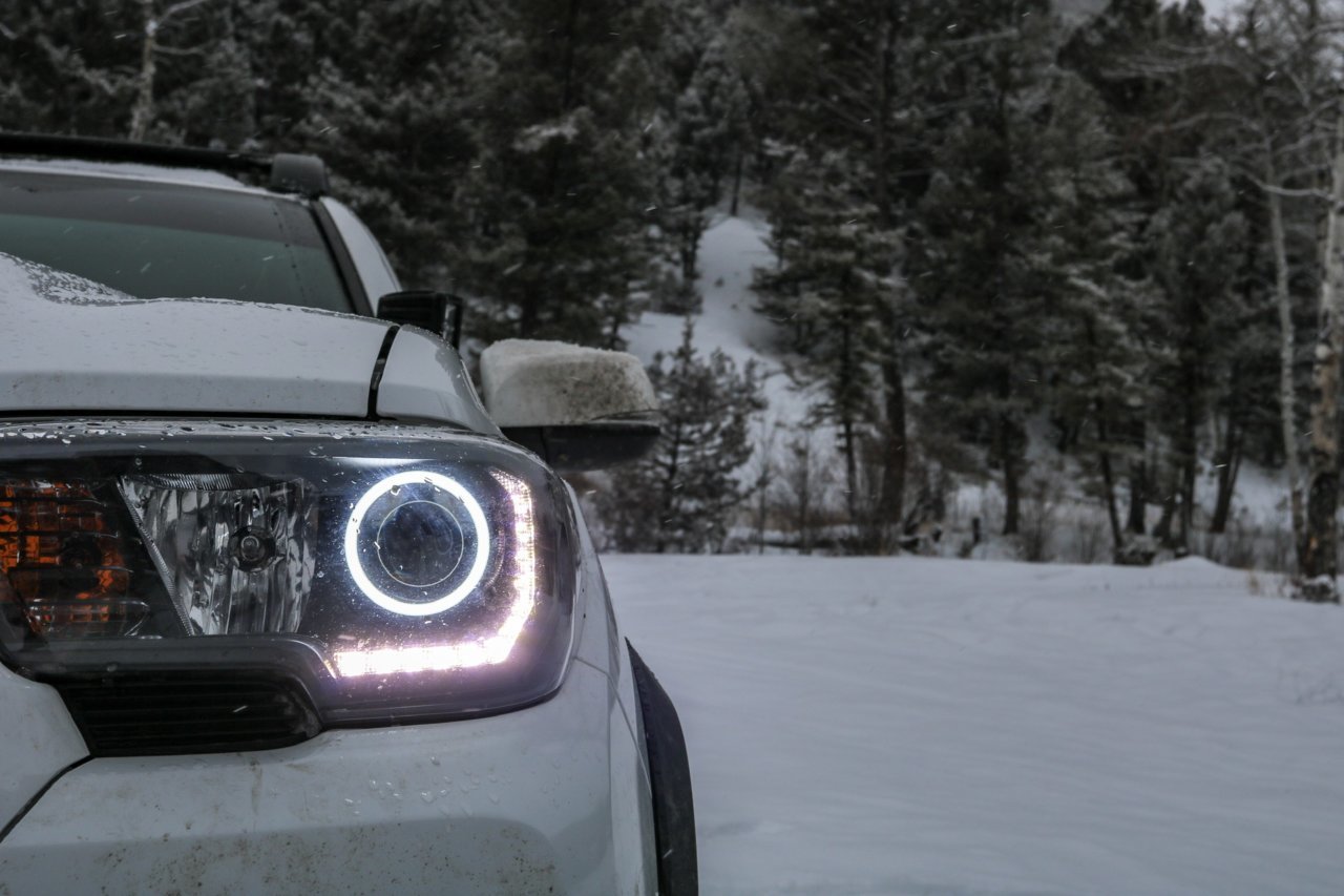

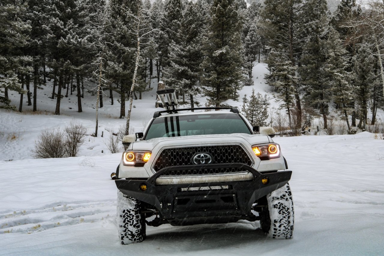

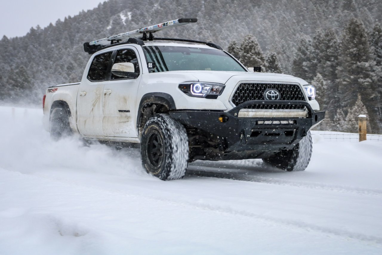

    D5687032-3C60-4267-8462-B9B74F572645.jpg 9C2C9A4B-5A36-42E5-B87B-CDB96FE5D3A9.jpg 3660D2FC-F54C-41E3-A459-B692C50C6CB8.jpg Been wanting to do the BHLM forever and finally got around to it last week. 4 days of on and off work and I couldn’t be happier!
    dskakie, Facts Only, moose309 and 2 others like this.

    This mod was by far the hardest I’ve taken on.
    moose309 likes this.
