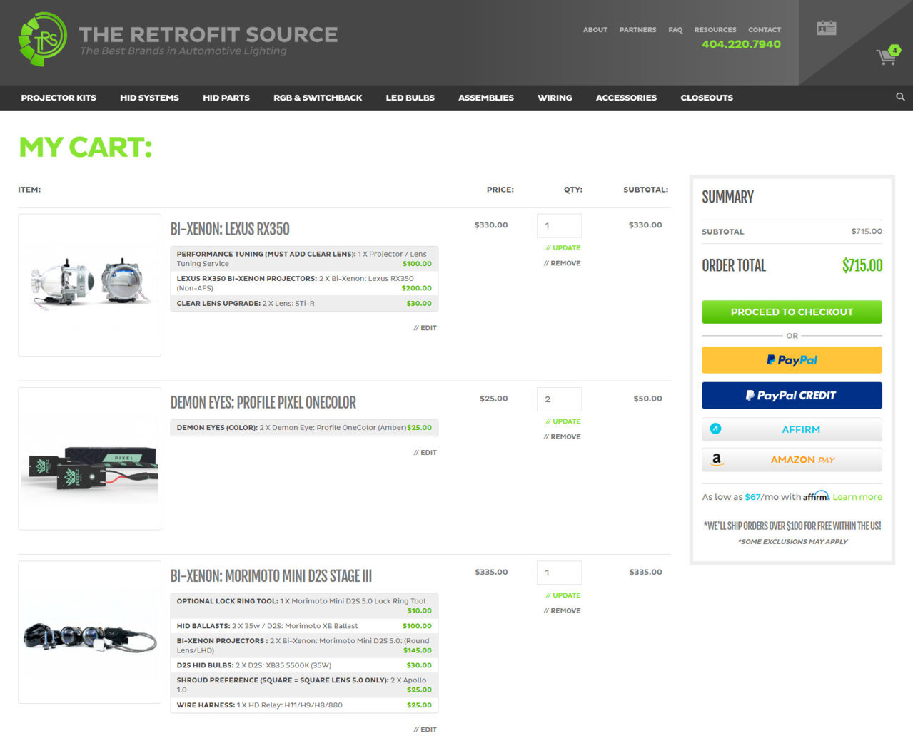

    Need some assistance on confirming this order, just want to make sure that I am not leaving anything out?
    I already have purchased:
    • D/D DRL switchback
    • 80 MM Amber/White Switchback Halo with drivers
    • Retro Rubber
    • Krylon Fusion Matte Black
    ksanti808 likes this.
  15. Sep 5, 2019 at 4:50 AM
    #915
    18BRMTRDSportTaco
    18BRMTRDSportTaco Well-Known Member
    May 17, 2019
    #293532
    234
    Jason
    Sachse, Texas
    18 BRM TRDS DCSB
    TRD Pro SEMA wheels, 265/70/17 Falken Wild Peaks, OEM TRD Pro Grill, OEM Toyota Tundra LED foglights, Morimoto 5500K HID w/Hylux ballast, OEM Black Emblem Overlays.
    ^you don't need the last thing on your list. That is a complete kit with projectors. All you need is ballasts w/D2S igniters and a pair of D2S bulbs.

    Here's a question: where in the heck do y'all put all the drivers with these LED bits?

    So I dont need the HD Harness and this will be 100% PnP?
  19. Sep 5, 2019 at 8:34 AM
    #919
    18BRMTRDSportTaco
    May 17, 2019
    #293532
    234
    Jason
    Sachse, Texas
    18 BRM TRDS DCSB
    The kit will come with everything you need. Just select the D2S kit.
