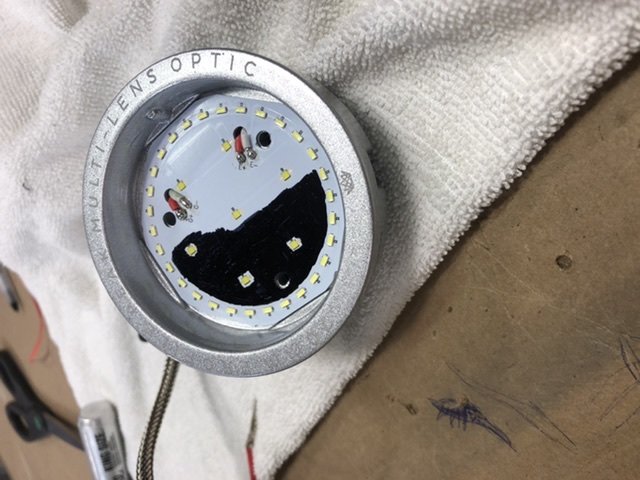

    attempt at blacking out the hi-lens so it’s not so “bright” looking inside the blacked out headlight. Not sure if it will work but worth a try.

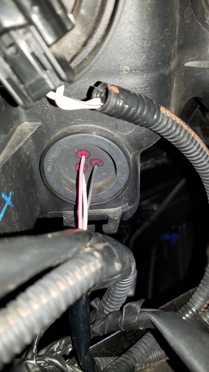

    The inner turn signal... what’d you use?!

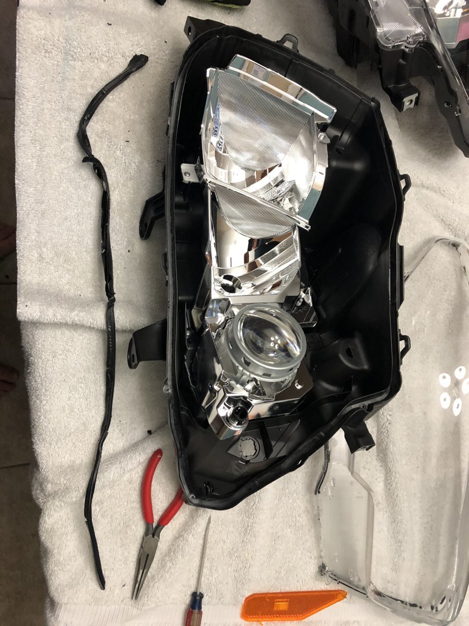

    So Black Lights Matter is the name of my company and I’ve done over 400 sets of these over the 3-4 years. Enough to know what works and what doesn’t. I’ve used krylon fusion for all my jobs and have had zero issues.
    As far as separating the lense...see aforementioned comment. It’s not luck that I’ve turned this into a business. You’ll likely get a few different responses from people, but I will tell you, emphatically, that 300 degrees for 10 minutes and they will peel apart without any tools or prying. You will have to put the man hands on them. Don’t be afraid to pull.

    300 for 10 minutes and they peel apart without tools?! That sounds a lot better than going to town with screw drivers and trim removal pliers. I’m looking forward to trying this.
