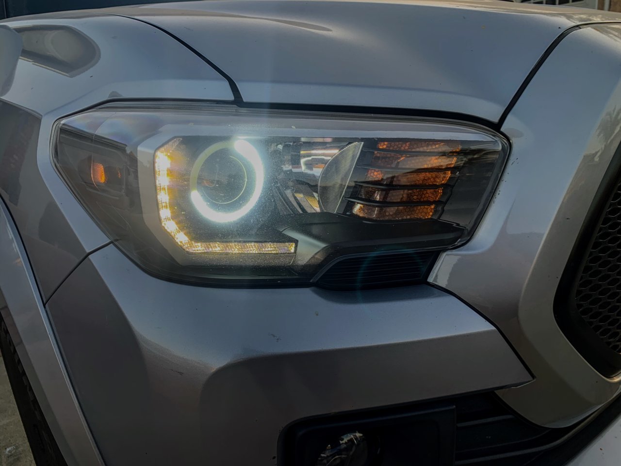

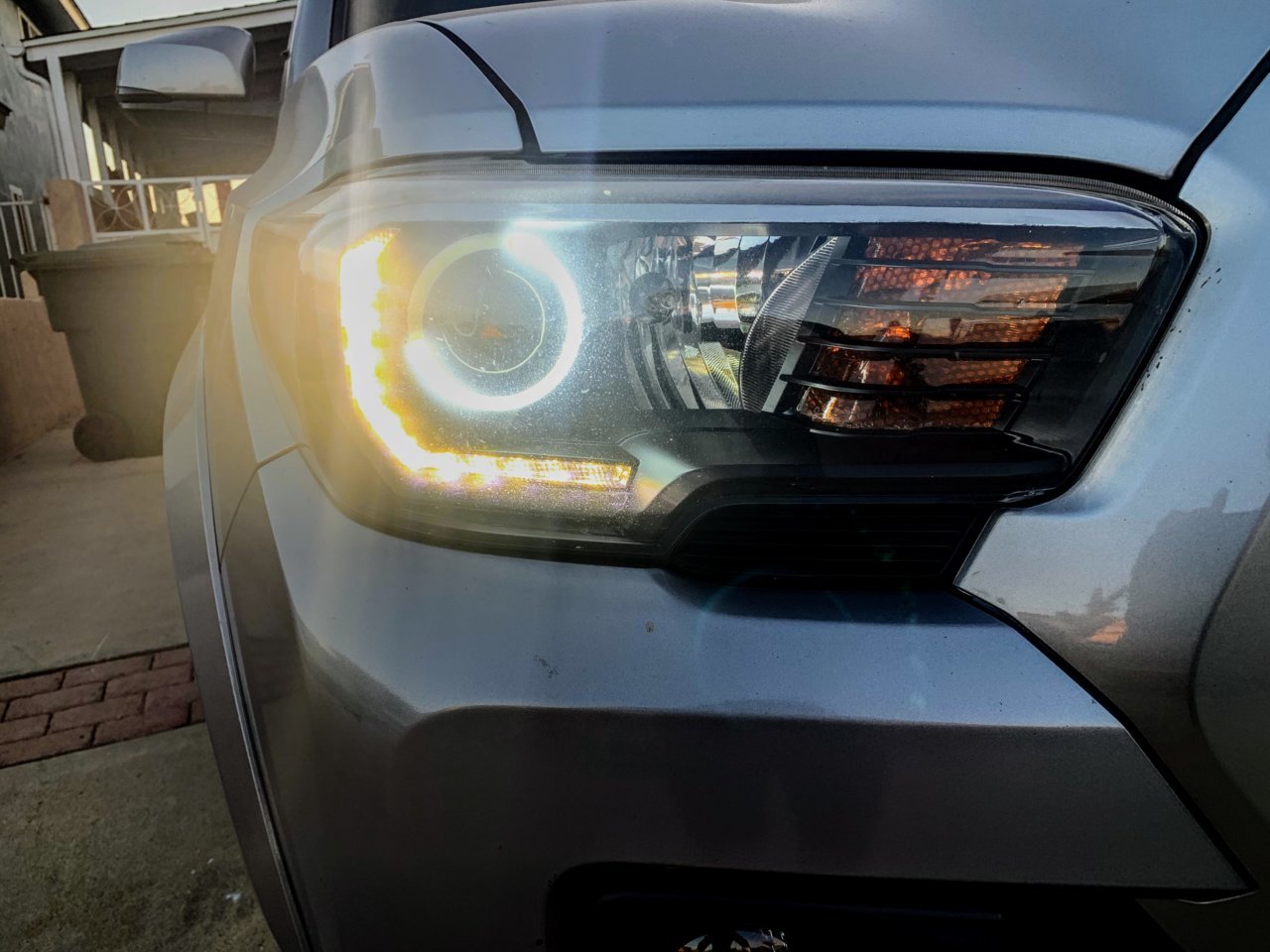

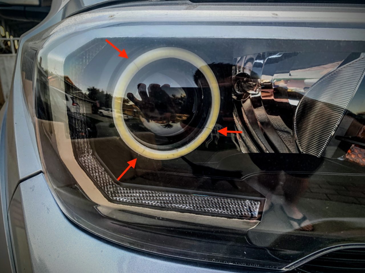

    Noticed the white halo on my right headlight started to go out. They are switchbacks and the amber still functions perfectly. Initially, I thought the wire I used to adhere them was pinching the halo somehow, but the wires aren't touching the affected side. I wouldn't be so annoyed if the inside 1/3rd gave out to give off the angry halo look, but it just looks like my truck has a bad lazy eye. I checked the wiring and everything seems to be in order, but what do I know. I'm definitely not ripping these things apart again so any advice would be much appreciated!

    the halo is shot. Not a wiring issue. LEDS are wired in groups, so that section either has a bad led or the traces are bunk. Sorry but the only way is pulling them apart and replacing:(

    But sheeeeittt, that's exactly what I was hoping not to hear. Since the amber isn't affected should I switch them up to run amber full time? or would I be better off unplugging the white LEDs and getting to most life out of the halos until I can snag a set of 2020s to retrofit

    Unplug white, use it as a turn until you upgrade or have a weekend to split them apart

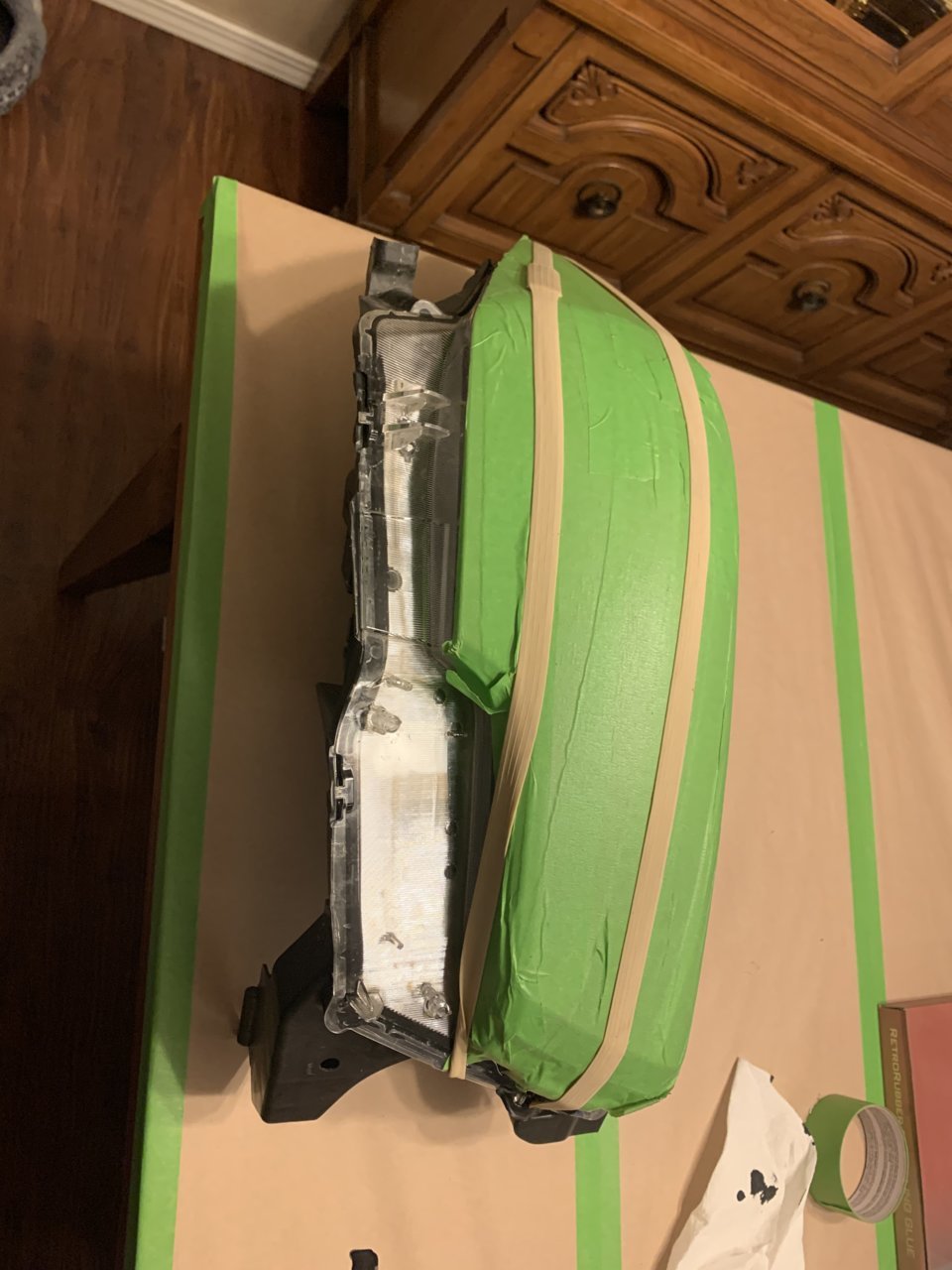

    Thanks! It went pretty well. Didn’t leave the first one in long enough but I put it back in and was able to get them apart. Probably put too much night shade on the reflectors but I’ll just have to deal with it for now. The butyl seal was super easy to use. I tried something different and used some furniture rubber bands from when i moved the last time. I think they worked great. Even pressure and able to go around the whole headlight nicely. Now I just need to start saving for the aftermarket headlights and all the projector retrofit parts.

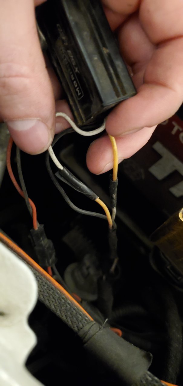

    I have XSB halos as well and had the same issue. I spliced the white wire into the orange wire and vice versa and it runs amber as well as maintaining the turn signal.
    badfish_55 likes this.

    Never thought about that. I appreciate the info and pics for confirmation. I'm just not a fan of running the amber halo with the white DRL, I like your setup with full amber on the 2nd gen
