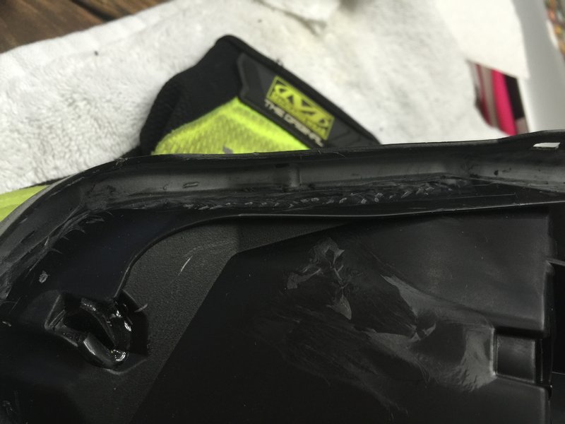

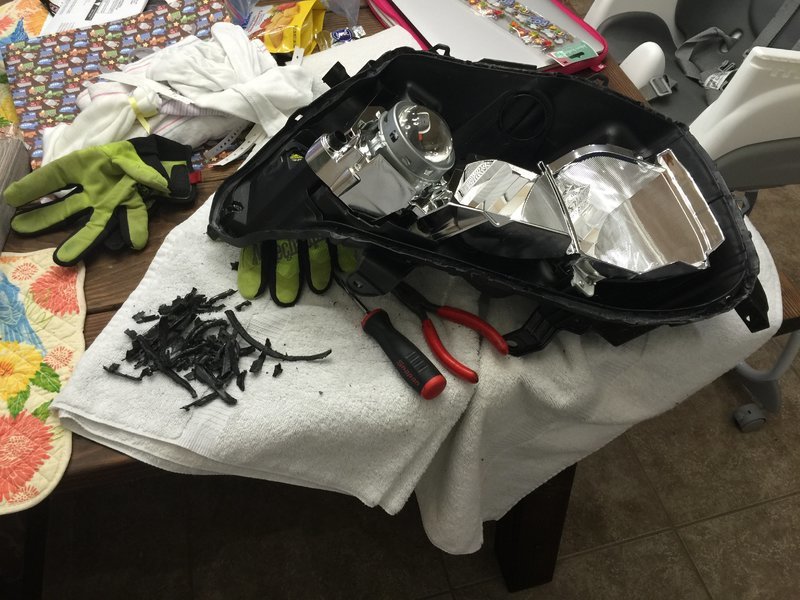

    Well that was a pain in the ass!
    But, came out super clean!!!

    I actually think that was the hardest part. That original sealant is satan's snot. Did you carve it out dry, or heat it up?

    It was way easier to carve it out

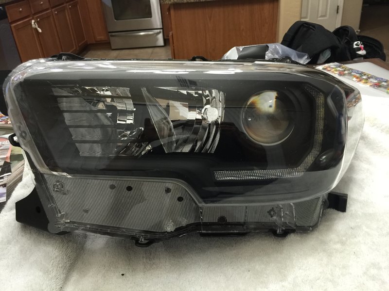

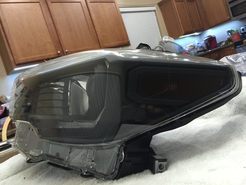

    I'm loving these things. That blacked out turn signal made a HUGE difference. Good call OP!

    11. Many factors involved. Heat, pressure, cost to replace if you break one. There are so many people with an opinion on the best way and there really isn't a best way. You're going to bend some plastic. And getting them apart was the first of many struggles. Removing the sealant literally took hours and hours to do. I have two sets. One for me and one for sale and I'm DONE!

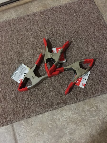

    Yeahhh! Welcome to the BHLM club:thumbsup:
    Have you re-sealed them yet? I have tried various methods; wrapping ties around them, weights on top, etc.
    The best way I have found to apply constant and even(important!)pressure is a few dozen of these guys;
    http://www.homedepot.com/p/HDX-2-in-Spring-Clamp-80002/100027346
    while the housing is hot, clip these around the perimeter and put the screws back in.
  19. Sep 29, 2016 at 10:08 PM
    #99
    motorsport36
    motorsport36 Black Lights Matter
    Mar 25, 2011
    #53674
    2,704
    Jason
    Furnace, AZ
    98 SR5 AC 4x4
    On it! How many would you recommend? I have 5

    16,294
    State of Jefferson
    2016 DCLB TRD HELLCAT SWAP
    Not all spots will accept the clamps(weird angles/surfaces). IIRC, I got about ~8-10 on per light. At $.99, VS having to re-do it all over... I didn't want to take any chances. So far, so good.
