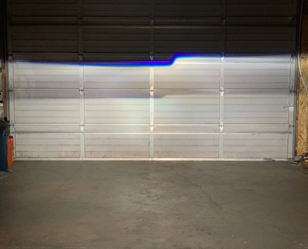

    I had some quads installed and they didnt align them very well at all. Not even close. :annoyed:Should've done it myself. So now have to take apart once I find an oven. This is one headlight. :rant:
