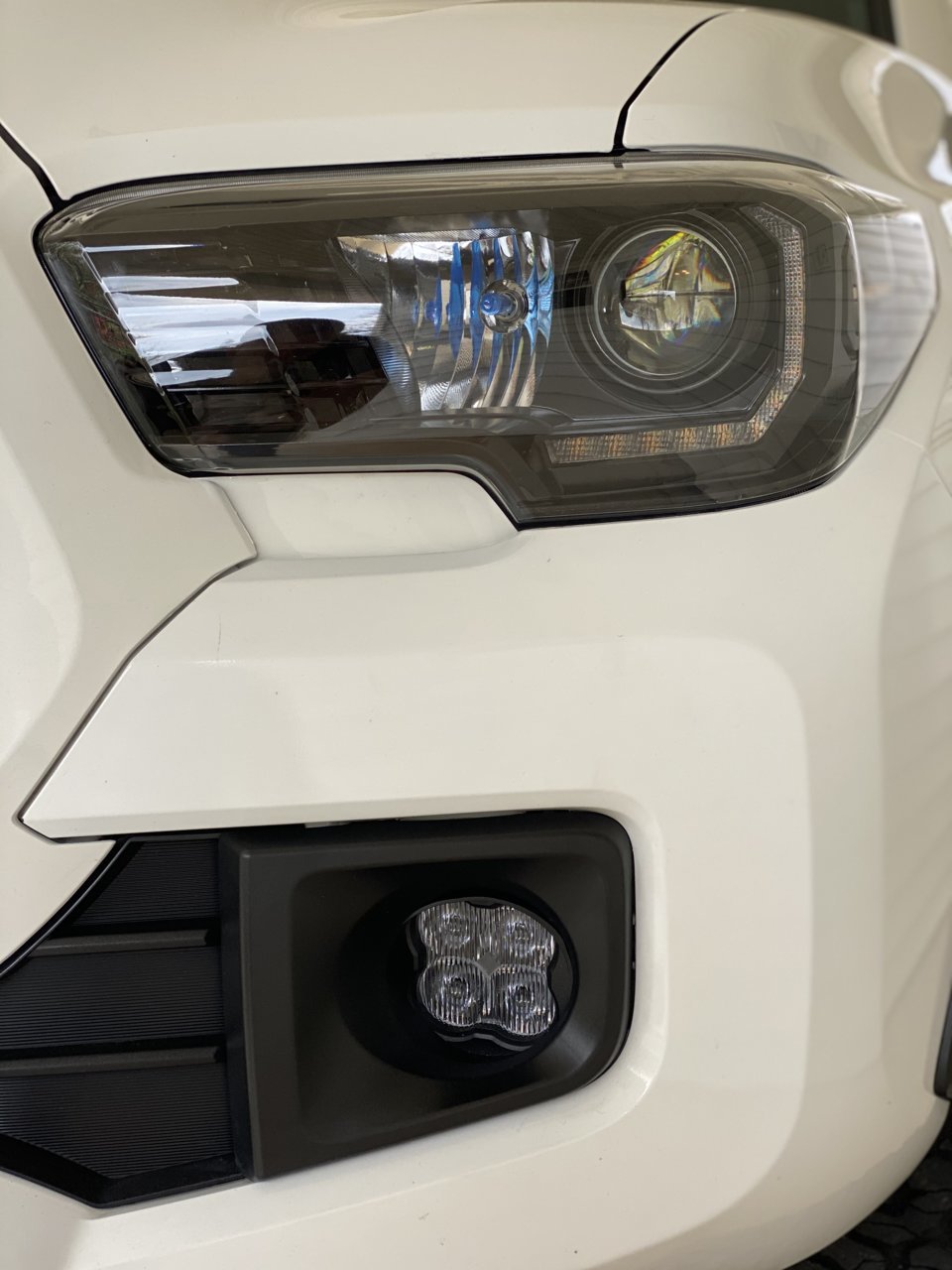

    I’ll whore my lights out in this thread too. Just finished mine the other day. Royal pain but damn it was worth it. Rx350 projectors with Osram CBI 5500k, Morimoto wiring, Meso stage 1 side marker, diode dynamics switchback drl, smoked turn signal covers, high beam splitter with Osram 75w 6000k h9 bulbs. And to top it off Diode dynamics ss3 sport sae fogs.

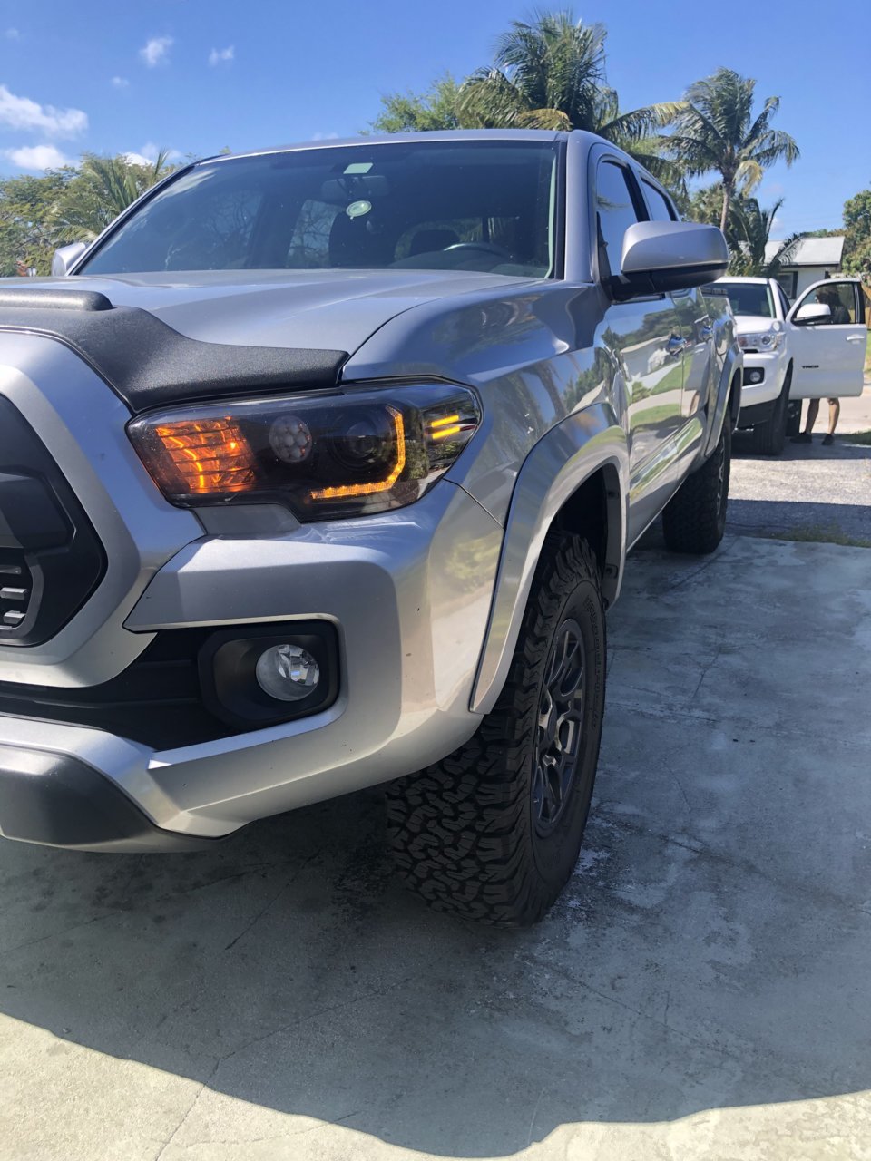

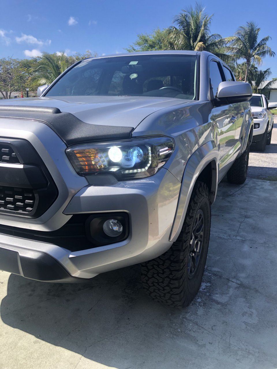

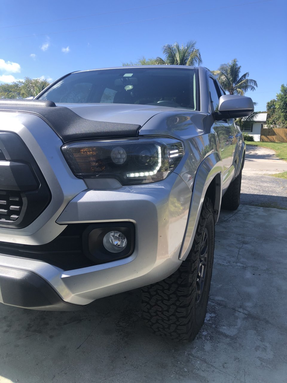

    Finally finished thanks @MESO for the inspiration and how to.
    Not bad for an SR5.

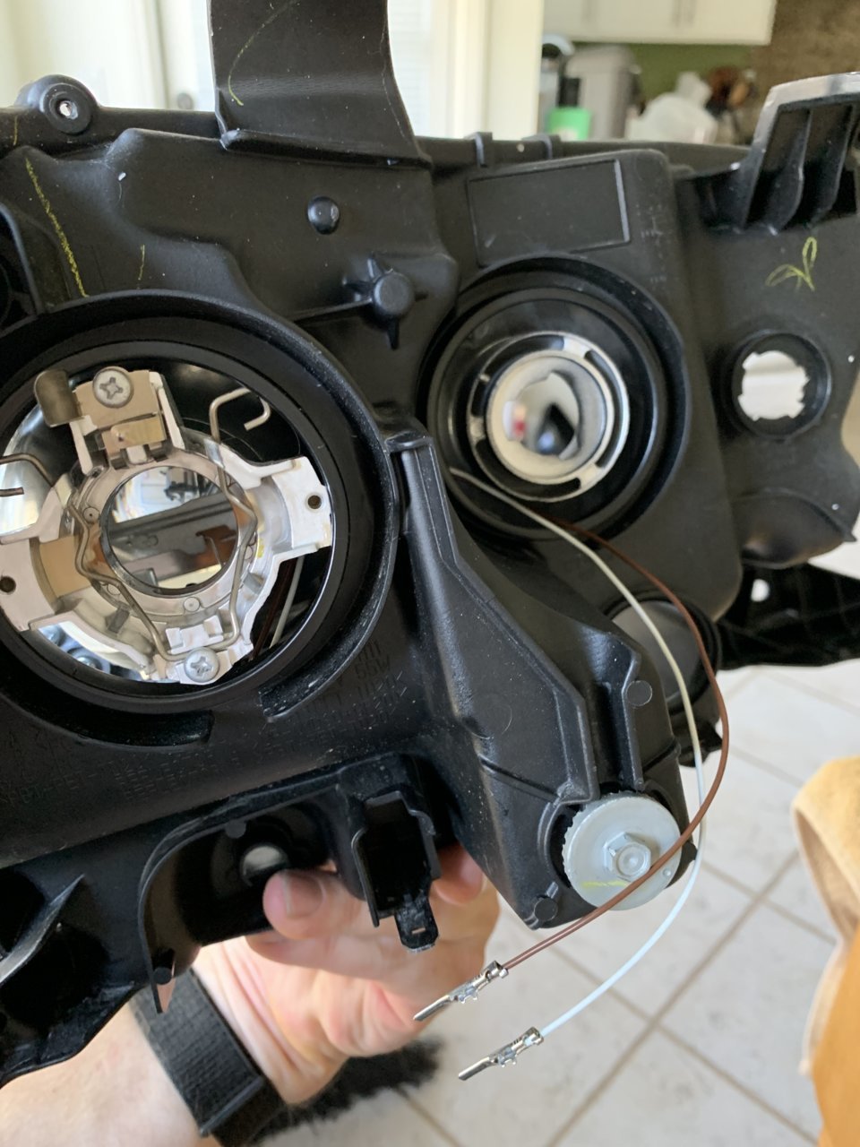

    For got one

    Where did you guys run the projector high beam solenoid wires?

    Exactly where you have them now, then worked the rubber gasket over them.

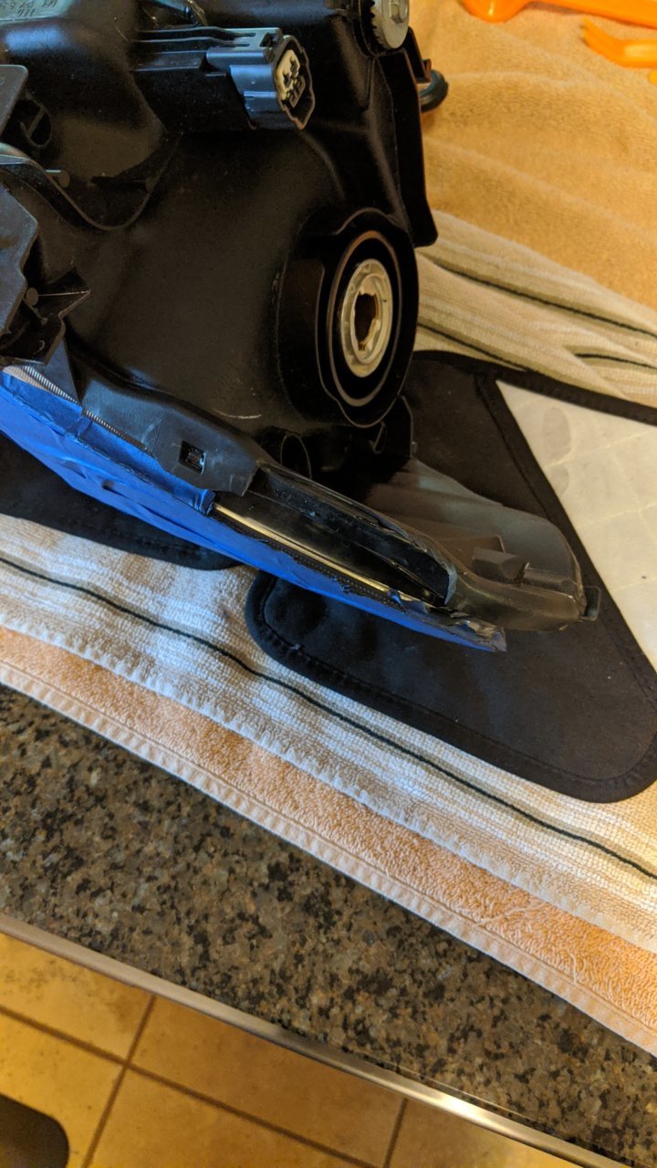

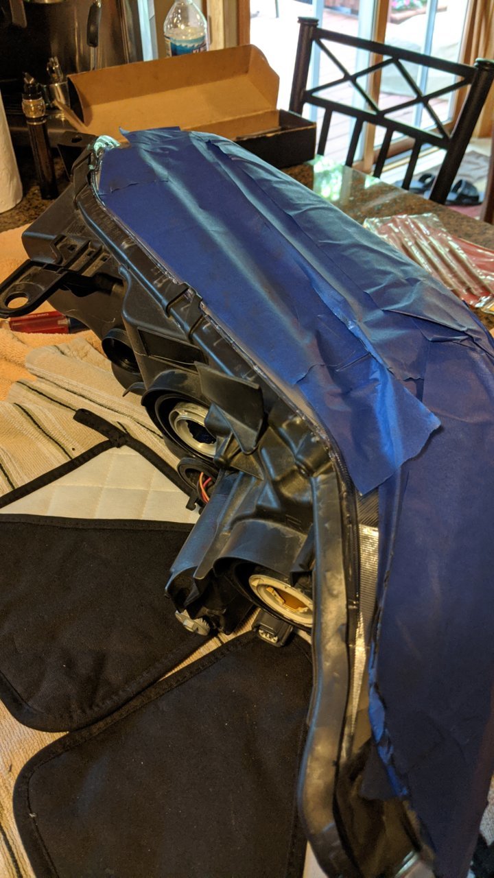

    So I failed at this today. Took a chunk out of the rear housing and broke a tab. Thinking maybe it wasn't warm enough since the permaseal looks pretty intact where i broke it. IDK if the issue is identifiable from the photos. might help others.
    S
