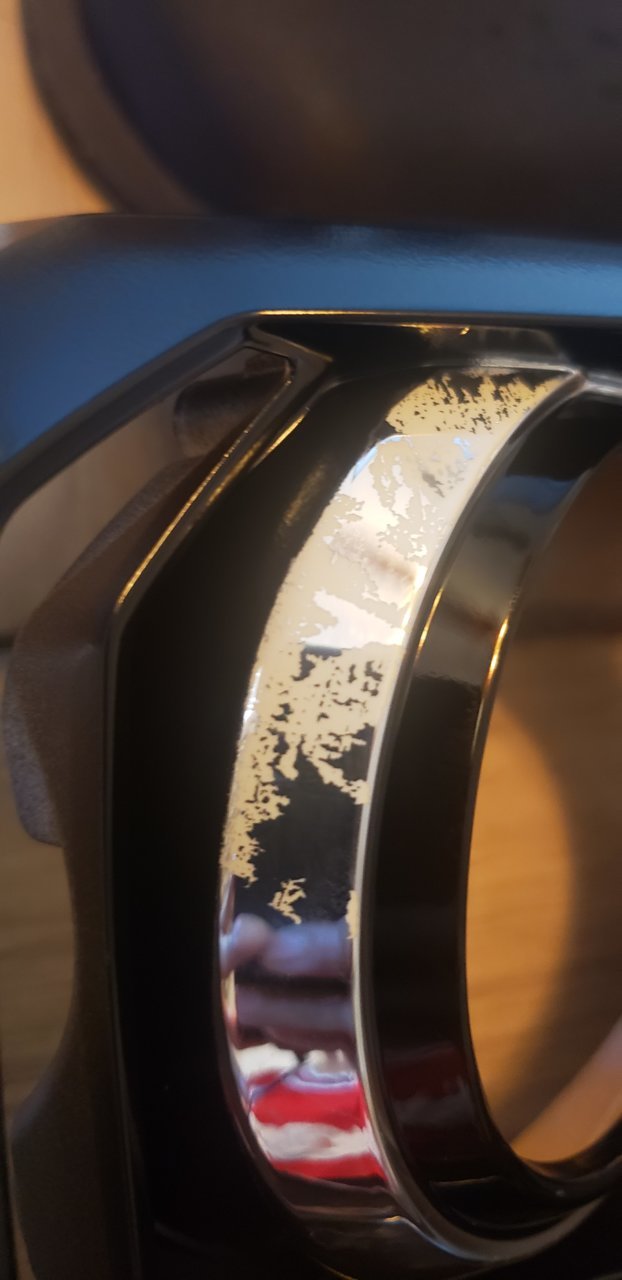

    Anyone have this happen?
    I taped the chrome piece around the projector and some of the chrome finish came off after I peeled the tape off. Anyone have a potential solution to fix? Gonna order a chrome paint pen, im sure its not a direct match but ill use it, if it's close enough ill commit to it. Hopefully you guys have some solutions. Thanks!

    You may not like my answer but honestly I'd say look for another trim piece and start all over with the paint or paint the chrome black or color match to the body. No paint pen will match the chrome that is left and nothing is worse than thinking something is good enough that it won't bother you only to seal it all up and figure out that it still sticks out like a sore thumb so you need to open then back up, fix the issue then seal them back up.

    Funny you say that. I actually have a botched headlight that I have, that I could source the damage piece from. So its not out of the question of doing this.
    So its crossed my mind, all depends on how this "chrome" pen works out.

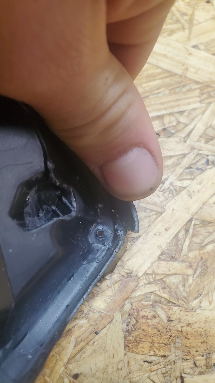

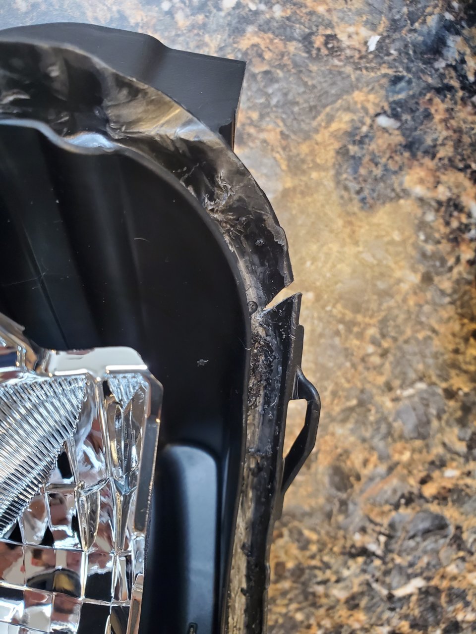

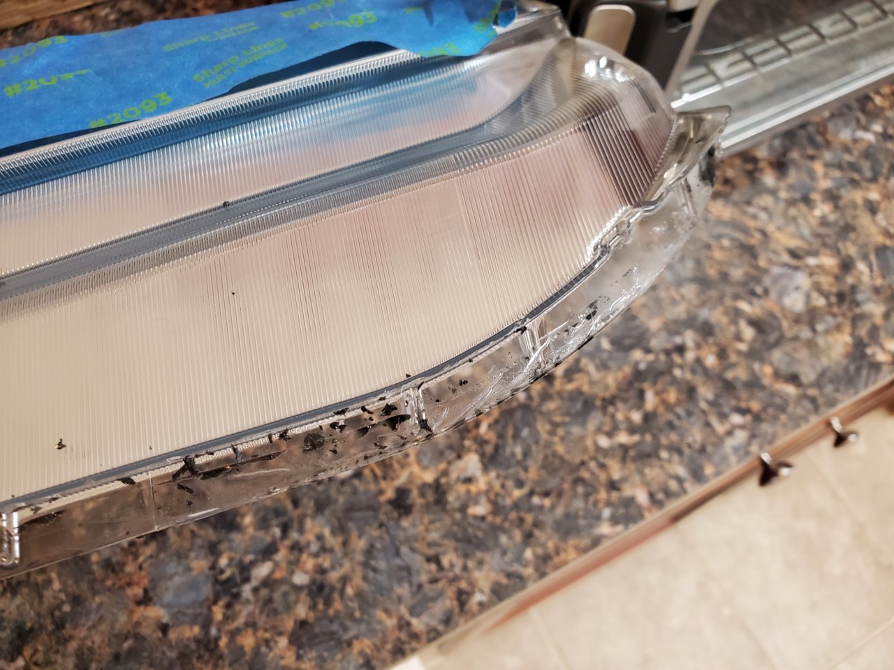

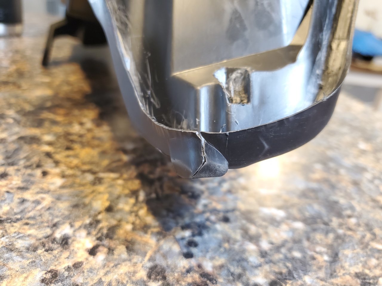

    Well, I finally got these lenses separated from the housings. I was beyond careful and patient, but I still managed to crack a few spots in the plastic housings. I also see these little lines in the lenses, and I can't tell if they're cracks or not. I ended up turning the temp up to 300 F because 250 and 275 wasn't making any progress for me. Will the retro rubber work in spite of the damage? If not, is there anything I can do to semi-fix the housings to the point where moisture won't get in?

  13. Aug 24, 2021 at 12:26 PM

    I am certainly not an expert, but I used JB weld and then covered with black silicone RTV as extra insurance to patch the housings.

    my super cool guy trick that I’ve used for years on these is to use a soldering iron and melt more material into the channel and smooth it out with some sandpaper. Do the inside and the outside. This will give you the best aesthetic appearance. A black lego works amazing. The retro rubber will fill in all the other “gaps” once melted and pressed back together. I’d be more concerned with those cracks in the black housing if they were all the way around to the interior. That’s all exterior cracking. The seal will fill all that in. It won’t look pretty but it will hold. The “cracks” on the clear lense…I wouldn’t be concerned. And I’m 500+ lights opened and sold.
