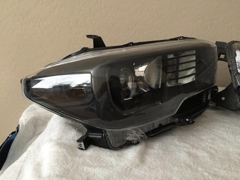

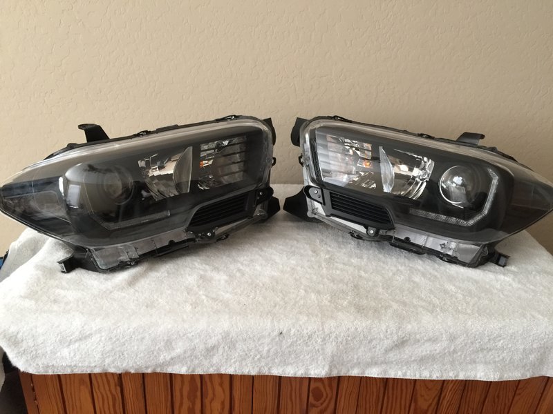

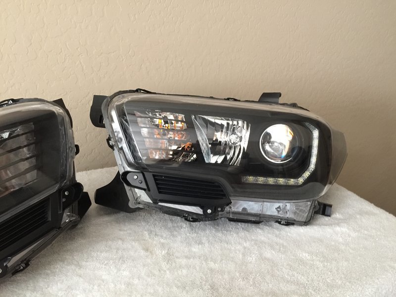

    Krylon fusion matte black. 240 starting at 15-20 and multiple reheats if needed

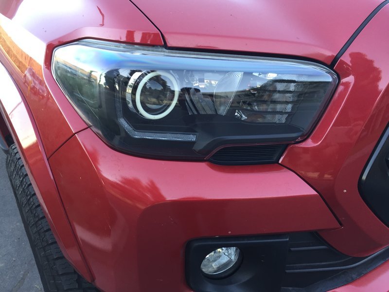

    Took me all day yesterday but it's done. I should have paid someone to do it haha

    Looks sweet! What size halo did you go with?

    ^ Those blend in sooo much better with red/black accents everywhere. In/Out and back together in 1 day is some work!

    I went with 80mm. took @Brick_26 suggestion on the size and it fits perfectly.
    Yeah needed the headlights for work haha. we took our time though. The paint you suggested worked perfect. The worst part was taking out the old glue. Other than that it went great.

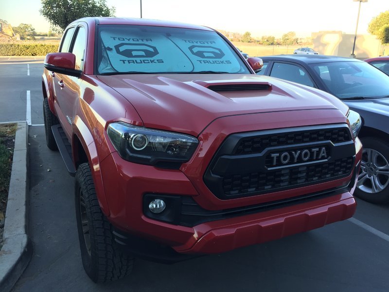

    Completed mine on Friday, What did you cap the back of the housing with? I put so much butyl in there and hope it does not leak. I added some morimoto fogs as well.
