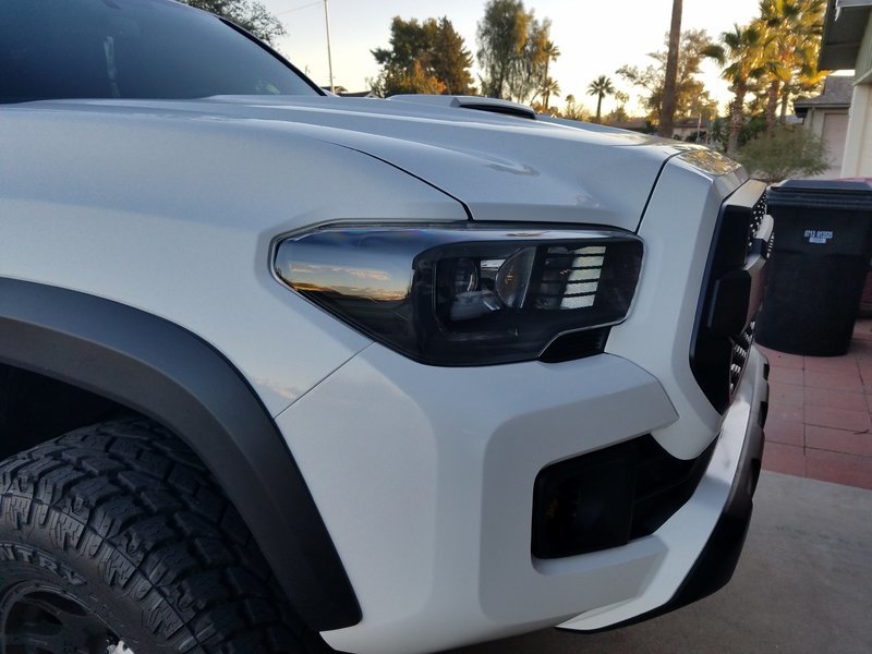

    Finally got these on! Thanks again Jason!
