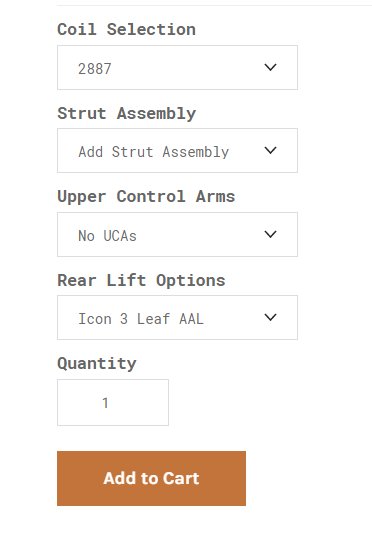

    I'm looking at the - COIL/BILSTEIN 5100 KIT (HS16BK-1) - kit from headstrong. 2887 coils, 5100's all around, no control arms, and an AAL.
    Should provide a clean lift from what I've seen. My question is what is the strut assembly option? Does that add the rear shocks? Or does that mean they put them at the notch a customer wants before shipping?
    EDIT: nvm they probably combo the struts and coils before shipping I'm dumb

    That would installing your 887’s on the 5100’s by default at the zero setting. You would have to call to request the 5100’s be installed with a setting other than zero. The 887’s provide the lift to the front just as the single or 3 spring provide your rear lift. The shocks are longer to provide the needed range to works as shock absorbers.

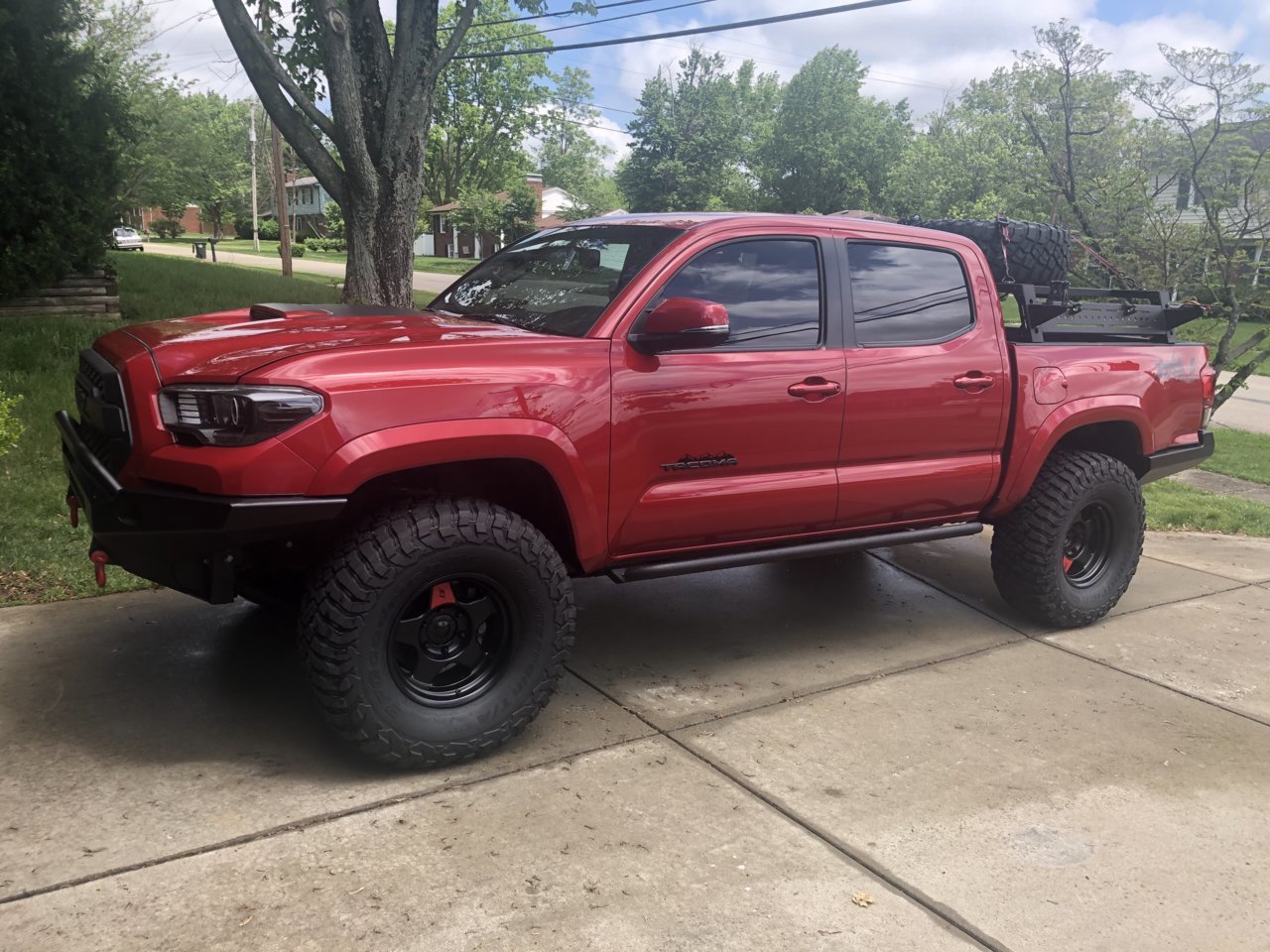

    Plastidip front grill and badges Bilstein 5100 shocks set at 0 OME 888 coils Lights Racing UCAs Headstrong AAL TRD Pro Wheels Matte Black BFG KO2 275/70/17 Rocky Mounts DriveShaft SD KB Voodoo Bed Rack ECGS 8 in clam shell bushing Custom Bedside Decals TRD MTB Edition CBI front bumper CBI rear high clearance bumper CaliRaisedLed 20 in single row bumper ARB CKMA12 Air compressor
    Figured I’d post an updated photo. Still same suspension setup as before but now with lots of armor and 315/75-16 km3s on scs f5 wheels 16x8 -25A01F045F-1571-4795-8F55-6D4EE40014AE.jpg7168A074-D455-417A-B19A-68CD7F2E5A6B.jpg

    1) If I do the following selection on the kit I linked below, this would give 2" ideally, correct? I think these are the new 3rd gen adjustables, right?
    2) Is the UCA absolutely necessary? If I can keep the UCA stock, that would be ideal.
    3) Would this keep factory rake? Leveled looks nice, but I understand if you haul things heavy, your end would sag.
    On a budget, but want a suspension good on & off the road.
    https://www.headstrongoffroad.com/store/p401/Coil/Bilstein_5100_Kit_(HS16BK-1).html

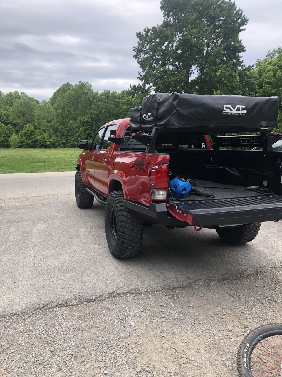

    Bilstein 8112/8100 ICON RXT Stage 2 JBA UCAs Archive Garage HH w Shackles Archive Garage U Bolt Flip kit Nitto Ridge Grapplers 255/80/R17 TRD Front Skid and RCI Transmission Skid Kenwood DMX 1057XR Head Unit Focal Utopia WM 3 way plus WM10 Sub Mosconi 5/30 and Genesis Dual Mono Amp
    Correct I have the same lift besides I did 888s and got 2.6 in front and 2.1 in rear of lift. I also did .25” spacer driver side for taco lean. I love my lift been on for nearly a year now. 5100s are great choice for those who want a firmer more responsive ride on road and some capabilities off road but nothing too crazy imo. UCAs were not necessary on my truck and I’d be willing to bet your tire size and that lift they are not necessary neither

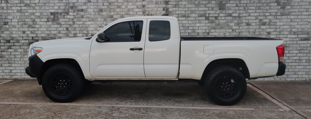

    3rd gen 5100's @ 1.55 factory coils and stock rear
    Before:
    DF 20 3/8
    PF 20 3/8
    DR 22
    PR 22
    After:
    DF 22 3/8
    PF 22 3/8
    DR 22 1/4
    PR 22 1/4
