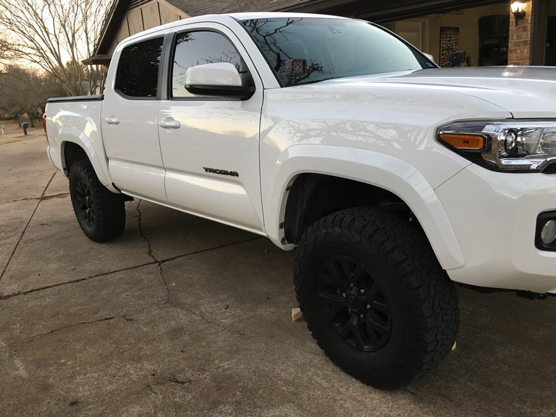

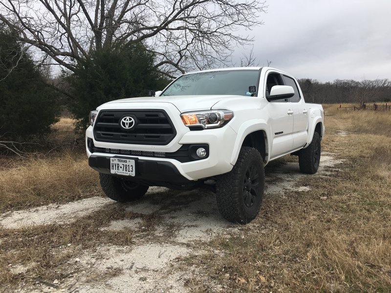

    Here's your 3rd gen on my 3rd gen

    What exactly did you order and how much did it lift it. Did you order just the adjustable Bilstein or did you order the kit with the coils where you set Bilstein to zero to get 2"s. Thanks
  19. Feb 24, 2017 at 12:30 AM
    #59
    TexasGunGuy88
    TexasGunGuy88 Insta: @midnite_taco
    Sep 21, 2016
    #197881
    270
    Burleson , TEXAS
    2017 Tacoma SR5 4x4 SR5sMatter
    6112 / 5160's w/ DAKAR Heavy 285's KO2
    I used the stock springs. Stock leaf pack with 1" spacers with 5100's all the way around.
