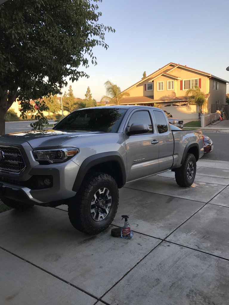

    IMG_2112.jpg 6 months and still loving the setup
    5100s all around
    Front set at 3rd notch
    Nothing else
    275/75/16 Bros

    Looks great. This is the 0.65" setting? How's the ride changed from stock? This is what I am after.

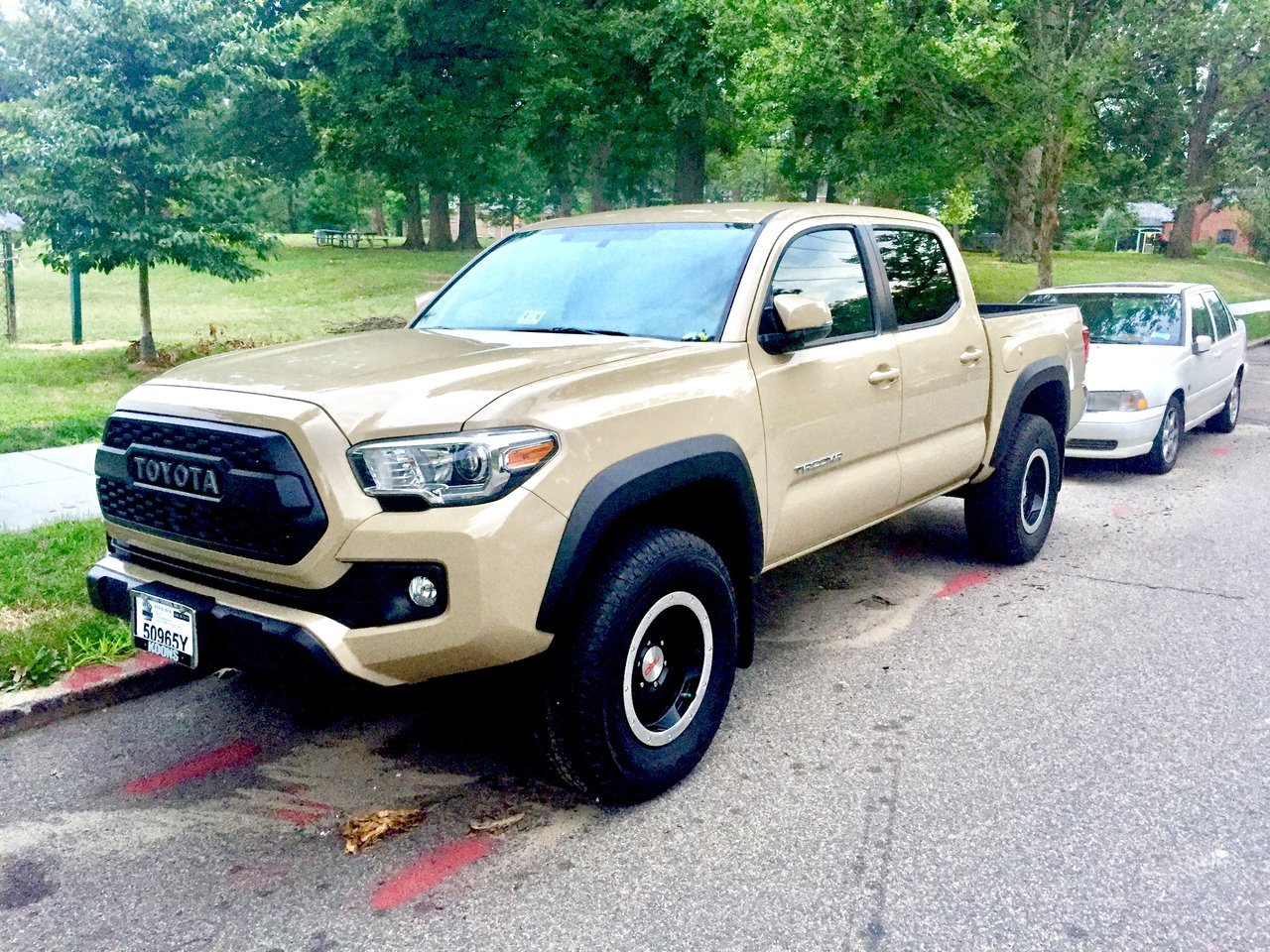

    Hi @HeadStrong Off-Road:
    OK, if I'm reading this thread correctly (LOL), Bilstein 5100s can replace OEM shocks using stock front coils and bolt-in rears, correct?
    On my 2017 Tacoma TRD Off-Road, I'm running stock tires with stock (Bilstein shocks) suspension and TRD 16" wheels. I want to replace the OEM shocks with the front and rear Bilstein 5100 set, with the front selected at the second clip, .65 and the rear set at 0.00. Obviously the rear would be "standard" NOT the "extended" length, right? Will this work?
    Here's a picture of my rig. All stock, no lift. I know you like the Quicksands, LOL.

    My bad, 3rd notch (1.1')
    The freeway and street ride is stock smooth. On street bumps its just a tad bit stiffer, not much really. On the dunes (Pismo Beach) it did good. Im still diggin em:kona:

    @joestacos Factory coils? What did you do for lift in the rear?

    Factory coils, nothing in the back just Bil 5100s all around

    HeadStrong Off-Road
    HeadStrong Off-Road [OP] Well-Known Member Vendor
    May 28, 2015
    #156242
    4,018
    2011 Toyota Tacoma and 2019 4Runner
    Correct and the standard length would be all that you would need :kona:
