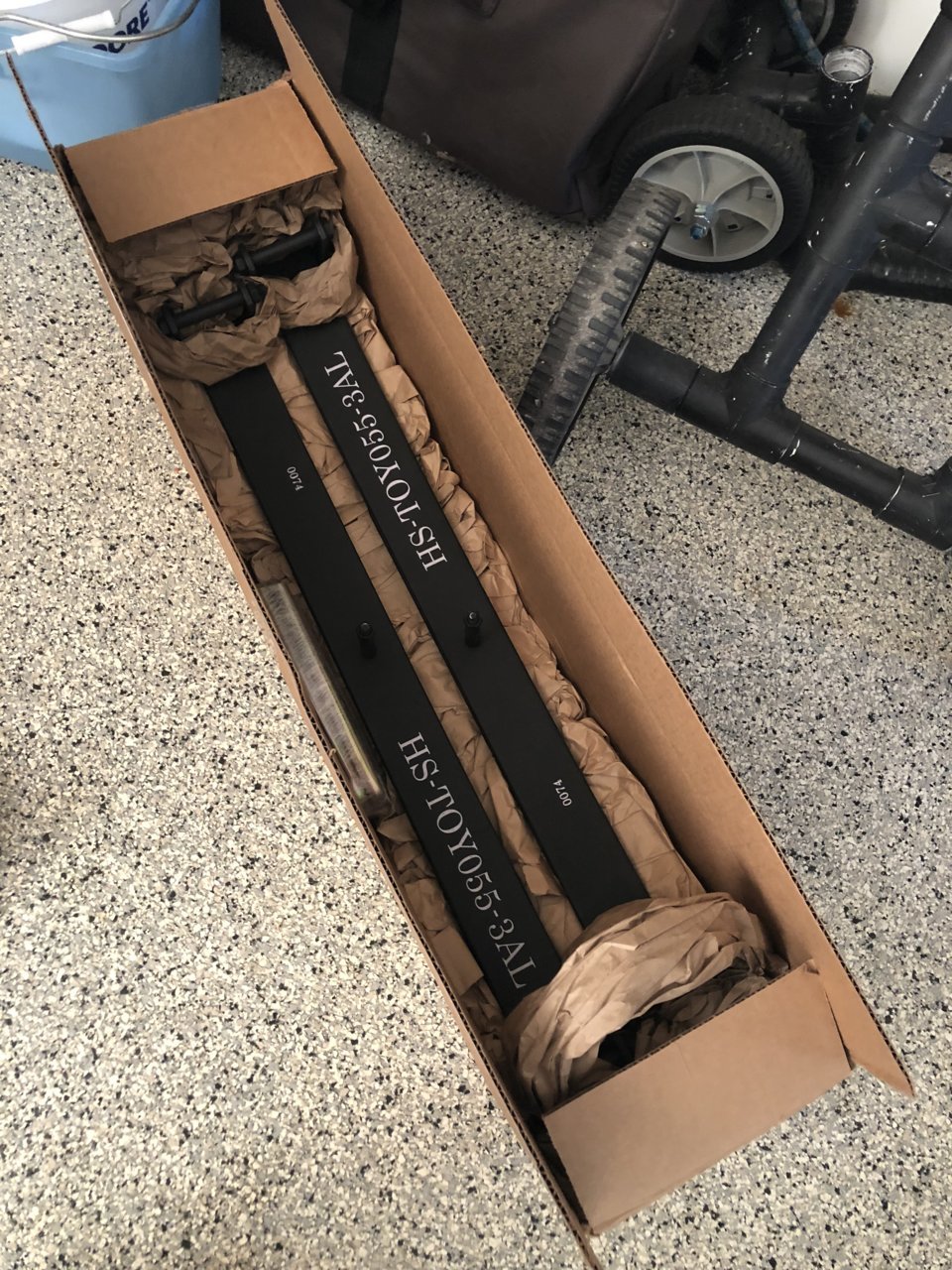

    Just got the first box of several for my weekend project. Decided to go with the Bilstein kit from @HeadStrong Off-Road and substituted 5160’s with the rear reservoir instead. Looks like I got my work cut out for me this weekend. Thank you Marie for all your help and insight.

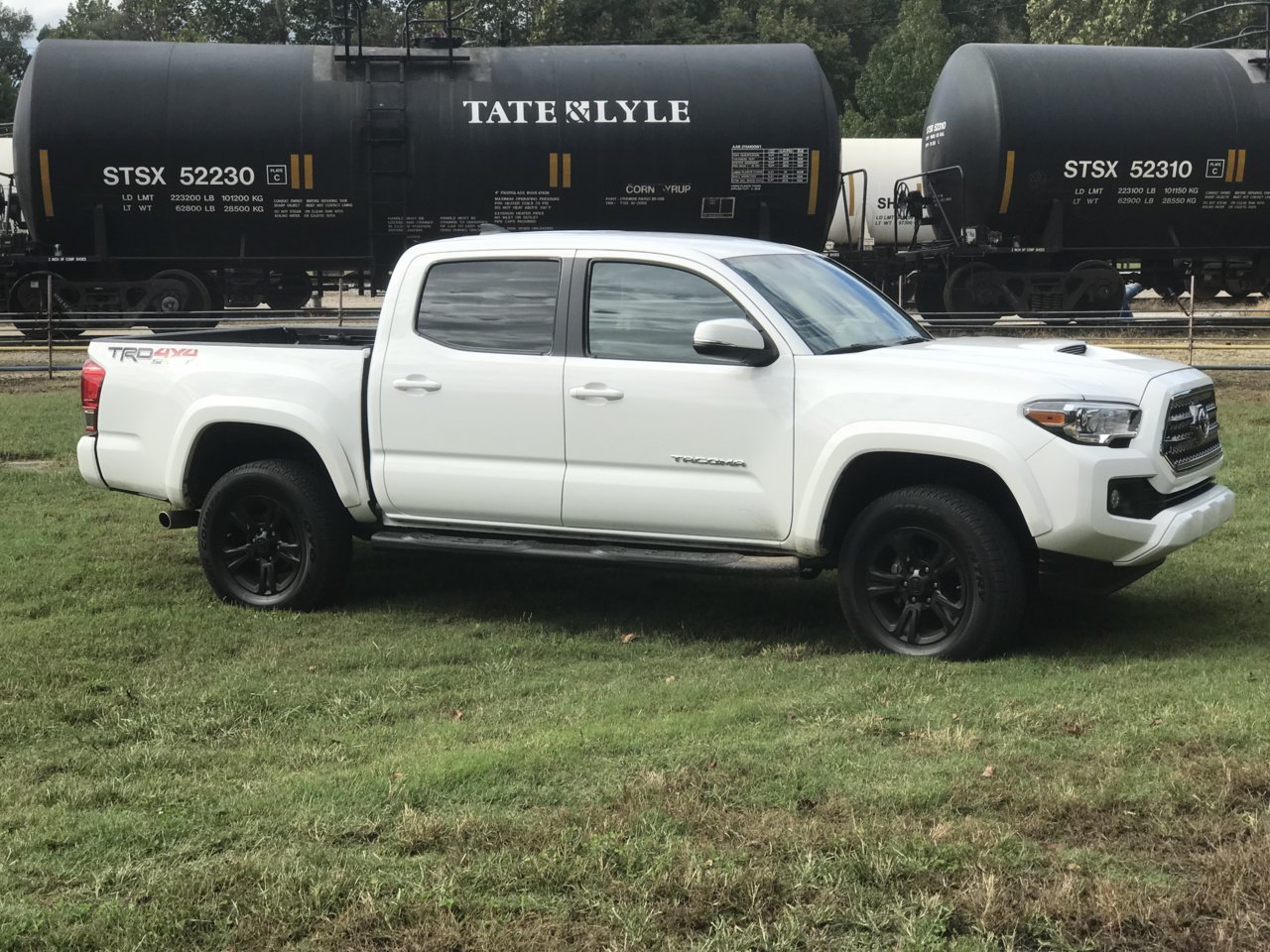

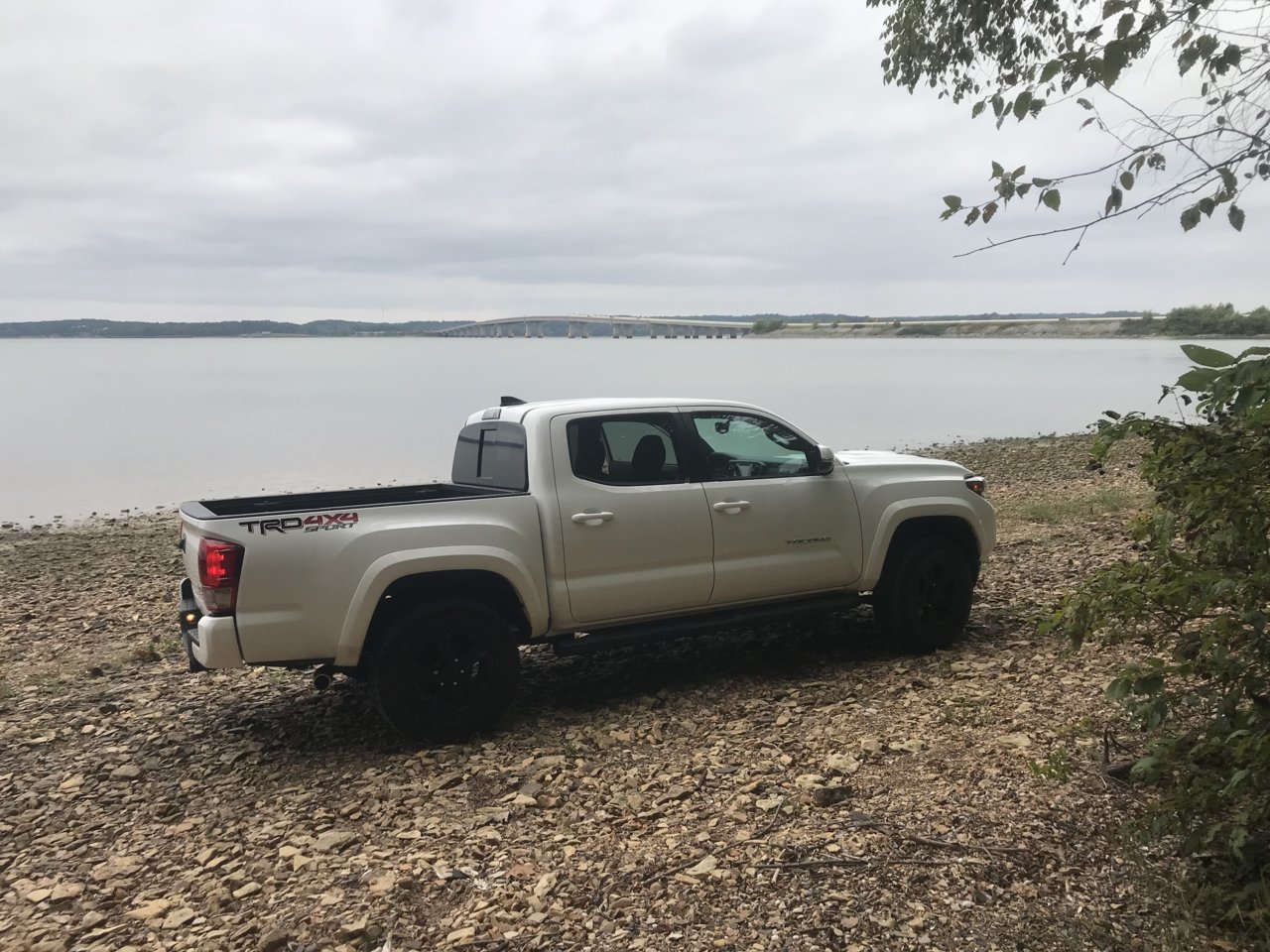

    03391F51-0535-4A60-9CA1-E3C0210BFE1A.jpg 03391F51-0535-4A60-9CA1-E3C0210BFE1A.jpg 225B7F04-6A4F-4976-9AB5-617DA68EF61C.jpg Marie at @Headstrong has been extremely helpful to me in answering my noob questions but I’ve still yet to decide for my 2017 TRD Sport 4x4 double cab standard bed. My tires are 265/65/17. I have measured all four corners and I have 21.75” from middle of wheel to bottom of the fender everywhere except LF I have 21.5” so I assume that means I have .25” taco lean.. Ive read and read and I’m now considering the 5100 kit with OME coils in front and 5100s in rear w a Deaver AAL. I’ve read so much I’m now considering 6112s in front and 5160s w reservoir for the rear. Will I need anything as far as AALs with the ladder consideration? I’m trying to get 2.5-2.75” lift with minimal rake. I will rarely ever go off pavement but will from time to time drive through field off road and I work at railroad repair plant so I do drive on some semi rough terrain daily at my job. I would like a stiffer drive bc I’ve noticed when hitting small dips and bumps on pavement my front end seems to hop every now and then. My truck only has 3,500 miles on it so all my stock components should be in good shape id think. Any advice and/or experience with either of these setups would be greatly appreciated! Thanks Chris

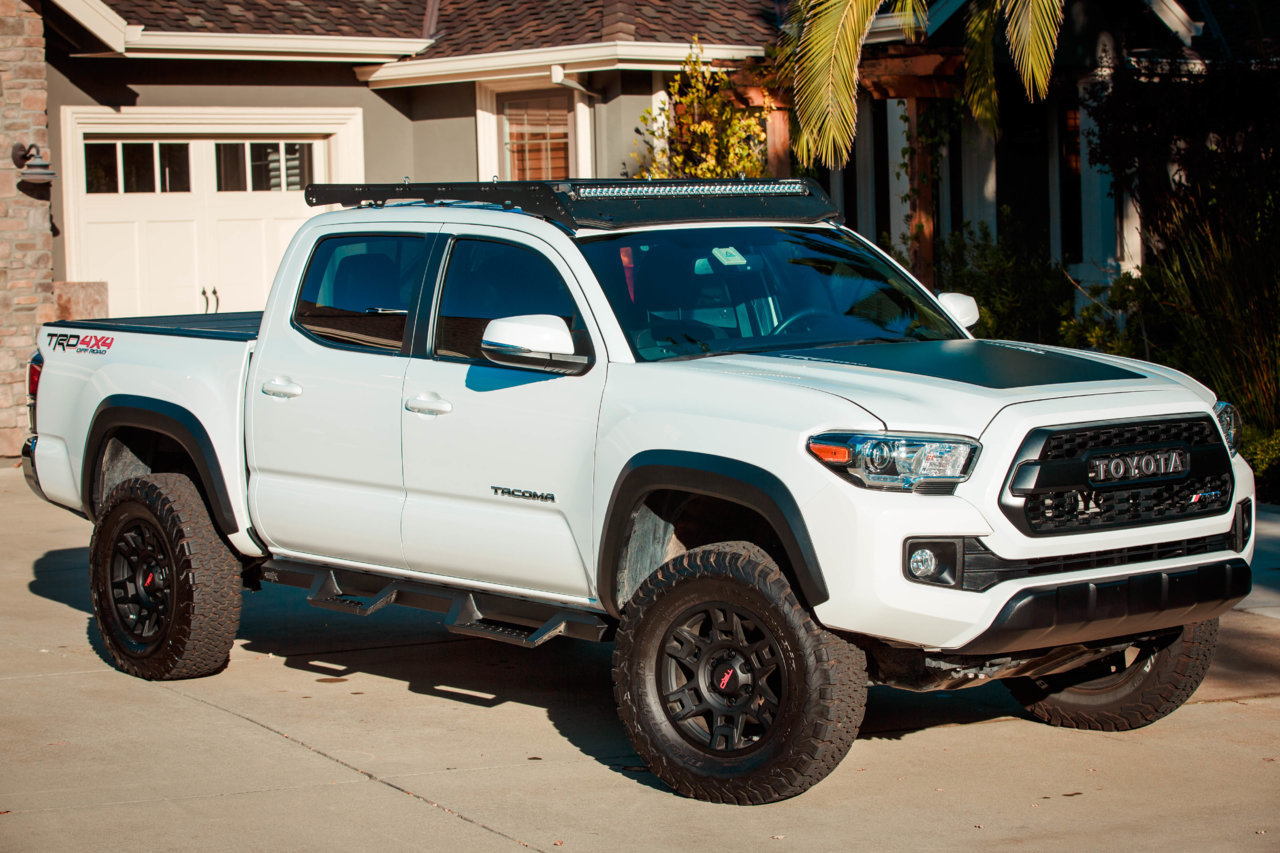

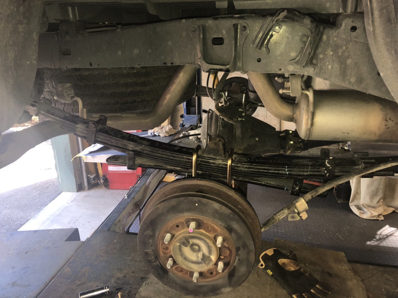

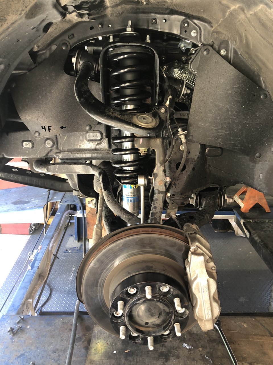

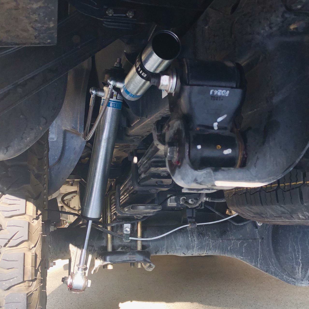

    Chris, Chris here... I have the same minus the hood scoop that looks cool but does absolutely nothing. As for your setup, take a look at what I have done, all parts are from @HeadStrong Off-Road. I did the 5100's in the front with OME 887 coils all setup by Headstrong with the 1/4" spacer on the drivers side. In the rear, I installed 6150's along with Headstrong 3-AAL. I have 265/75/r17 BFG KO2's and from floor to center of fender I am at 37.75"

    Great looking setup and truck! Sorry but I’m not familiar with 6150s but gonna check them out! I think the 5100s with 888 OME coils would get me an extra .25” in front end so that’s why I’m conaidering them instead of the 887s now! Thanks for sharing! How is the ride quality vs stock?

    I always hated the ride quality of Stock as it felt like I was hitting every bump but the ride quality now is way better but still drives like a truck not a Denali.
