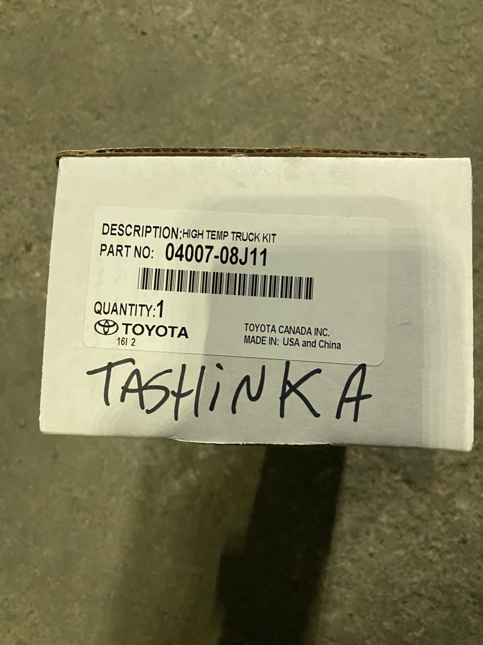

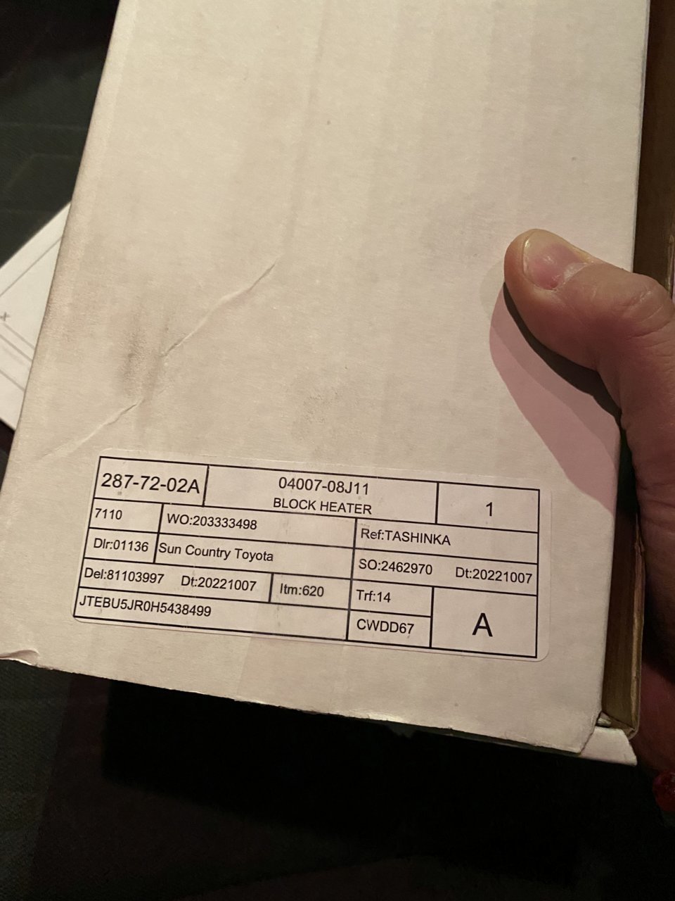

    Dealership did it in under an hour. New block heater, the box it came in and the new cords were sitting on the seat. They put in the shielded cable - the foil looking thing in the picture- there is a bundle beside the battery and then it's cable tied along the lines to the back of the block.

    Good deal. Do you happen to still have the paperwork or box? Wondering what the part numbers are so we can compare to the originals
