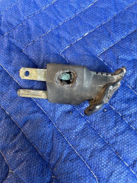

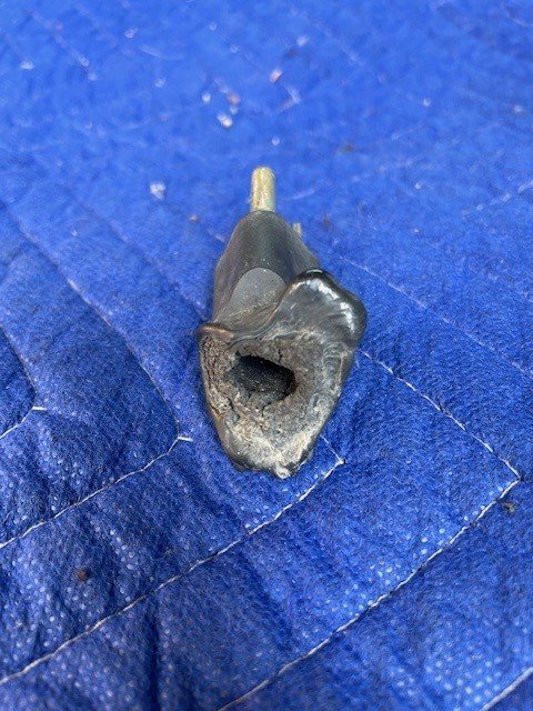

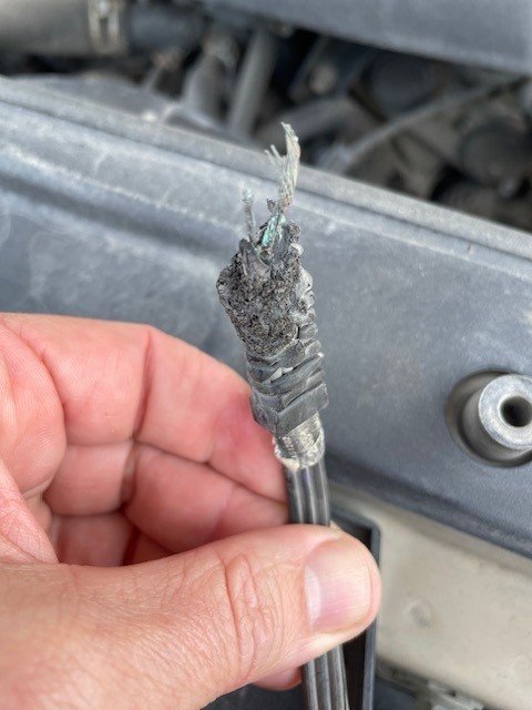

    Imma resurrect this for informational purposes. I had the recall on my block heater done in Aug of 2018 on my 2017 Taco, it was the Canadian recall on American truck (Alaska). Everything was fine and I checked the replacement regularly to ensure the *new* heater was not melting or causing any issues. Fast forward to 2024 and a workmate had inquired about installing a head bolt heater as he moved up from Colorado to Anchorage for work. I went to show him my dealer install and found the plug had completely melted at some point during the last winter and I was oblivious to it. I was lucky that it melted at the plug, even when I plugged in the poles were separated and I never had a tripped GFCI or powered up.
    I have since opened a case with Corporate Toyota because local (Kendall) ignored my concerns and said they would only 'cut the cord' and install battery blanket and oil pan pad but I would have to pay for it, and Corporate has closed the concern and sent it back to Kendall to deal with. So there has been no actual recall on the recall itself, so even if you had gotten the recall done there is still a chance of melting and failure. I've called Kendall 3 times requesting it be elevated each time with no response, pretty soon I'm going scorched earth on socials to get attention to it. I've never had good luck with Kendall anyway but to ignore a recall on a previous recall seems negligent. Yes, I will end up doing the work myself but there are folks in the region who should know that even a recall can be recalled and there is still a risk.

    yikes - lucky catch. I ended up leaving mine in and just not using it.

    Early this year I managed to forget my block heater cord was plugged in and ran it over, heard the worlds worst bang when I did it. Thankfully that was the last time it was plugged in for the year. Fast forward to a week ago and I had the dealership give it all a look over before winter approaches and they gave it the all clear. It’s a 2021 but I’m still shocked there isn’t anything being mentioned about the fires that have taken place. I brought it up as well and they said “you’re all good”….
    My plan has always been to only plug it in when it’s -25c or colder, and only with a GFCI breaker. I have a battery blanket too but I’m not left feeling confident about the block heater with folks having melted wires like our man Gooch
