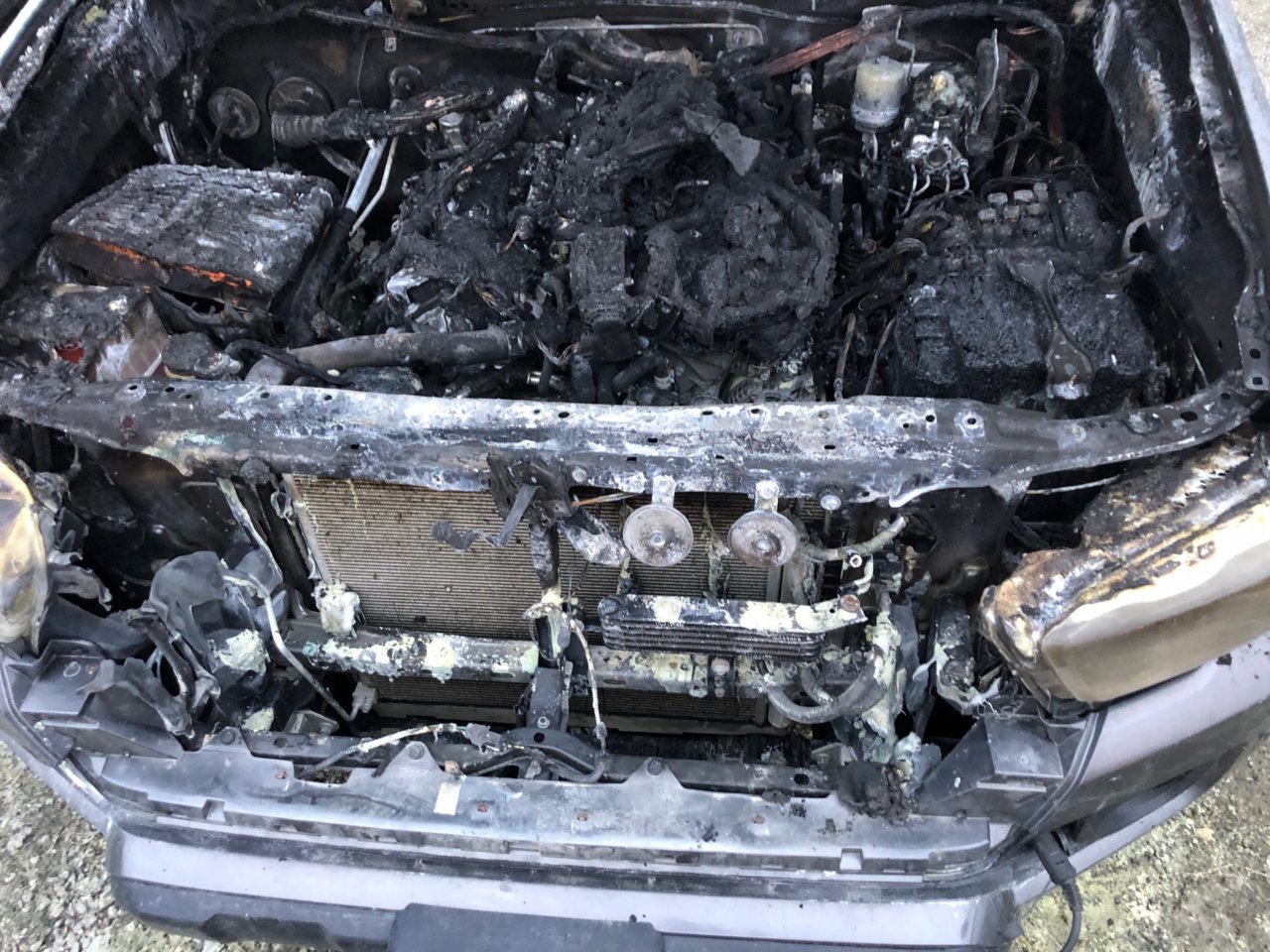

    My 2017 off-road burnt to a crisp as well....

    It's under investigation right now, but it was plugged in and started afire. I had the dealer installed block heater, no mods or additions to the truck. Waiting to hear back from Toyota Canada. Thankfully no one was hurt and hopefully this doesn't happen to anyone else!

    I believe it's a different style of block heater in the 2nd gen. Yours should be a conventional one with the heating element in the cooling jacket. The 3rd gen is an element that actually keeps the block warm. If not fully locked into place, it creates excessive heat externally from the block which is how the fires start.

    On my 2nd gen 1GR-FE the block heater is a cartridge that snaps into place in a cast in pocket on the left side of the block. Is that the same concept on the 3rd gens? On mine there was no draining of the coolant or popping out a freeze plug like in olden days.
    The problem I understood was in the wiring of the cord and a potential to short. But I bought and installed mine (the part number is PU140-00913-1) after I bought the truck so I never got a notice based on VIN and don't know anything for a fact.

    Okay, so the 2nd gen is the same as the 3rd. The investigator showed me a demo they did for the engineers at Toyota with the heater cartridge not completely snapped in place, and the exposed elemnt got so hot that all the wiring surrounding it caught fire. My dealership never made me aware of any recall for the heater... :mad:
