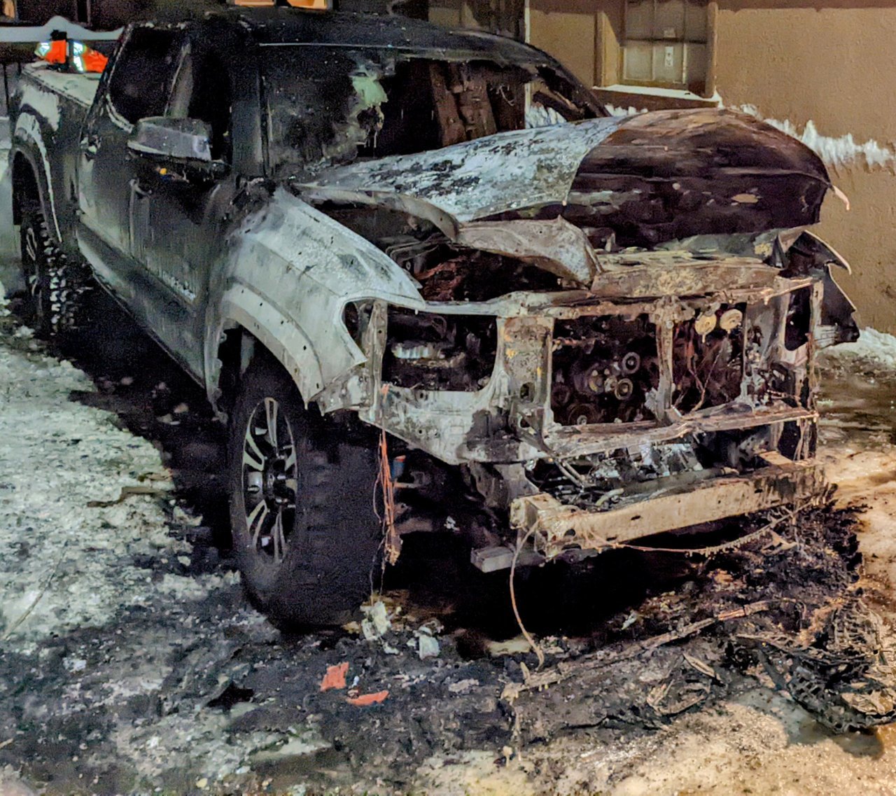

    '17 Tacoma block heater fire - Winnipeg, Canada, 2021/12/28:

    I plugged it in last night and the block heater failed within 2 hours. Horn was blaring continuosly and I saw smoke through the window of my house. I raced outside to unplug it and blast it with a small fire extinguisher, but it was too late. It took the fire department about 15 minutes to arrive. The flames must have been up to 20' high. The firewall worked well as all contents inside the cab were fine.

    Damn. Glad you’re safe. Hope you didn’t have any house damage.
    Since you’re in Winnipeg I’m guessing the block heater was working fine the last couple years?

    Thanks Antoin. Luckily no damage to adjacent buildings, and the fiber internet cable running directly above the truck withstood the heat of the fire.
    Until now, I've had no issues with the block heater for the past few years, and I only use it when it's sub -30C (-22F).

    From reading this thread, I gather the problem occurs when the block heater is not fully inserted (clipped) into the "pocket" in the engine block. The problem could be a faulty install OR could the heater work itself loose over time and rough roads at speed?
    Can a visual inspection reveal a not properly seated heater? And if not a visual inspection, what about using a heat sensing gun around the heater area of the engine block after it has been plugged in for a while....I will be doing both.

    that's incredibly lucky. You'd better play the lottery today.

    or could be worn wires shorting out between the block heater and the plug

    wow, anyone determine what in the heater is causing this?
    To me this sounds like a very high amperage draw causing the cable to basically overheat and catch on fire, which in turn lights up all the plastic in the front. Wonder if that's what's happening here?
