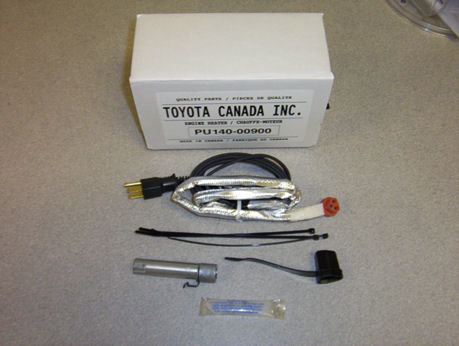

    I looked up my VIN and it came back with nothing. This was a dealer installed Toyota option that I had asked for on my 2020. I guess I just have to watch how this plays out. Thankfully I don't require the block heater at the moment.
    Does anyone know what the 3rd gen block heater looks like? Either photo below? Any speculation on what is the weak point is?
