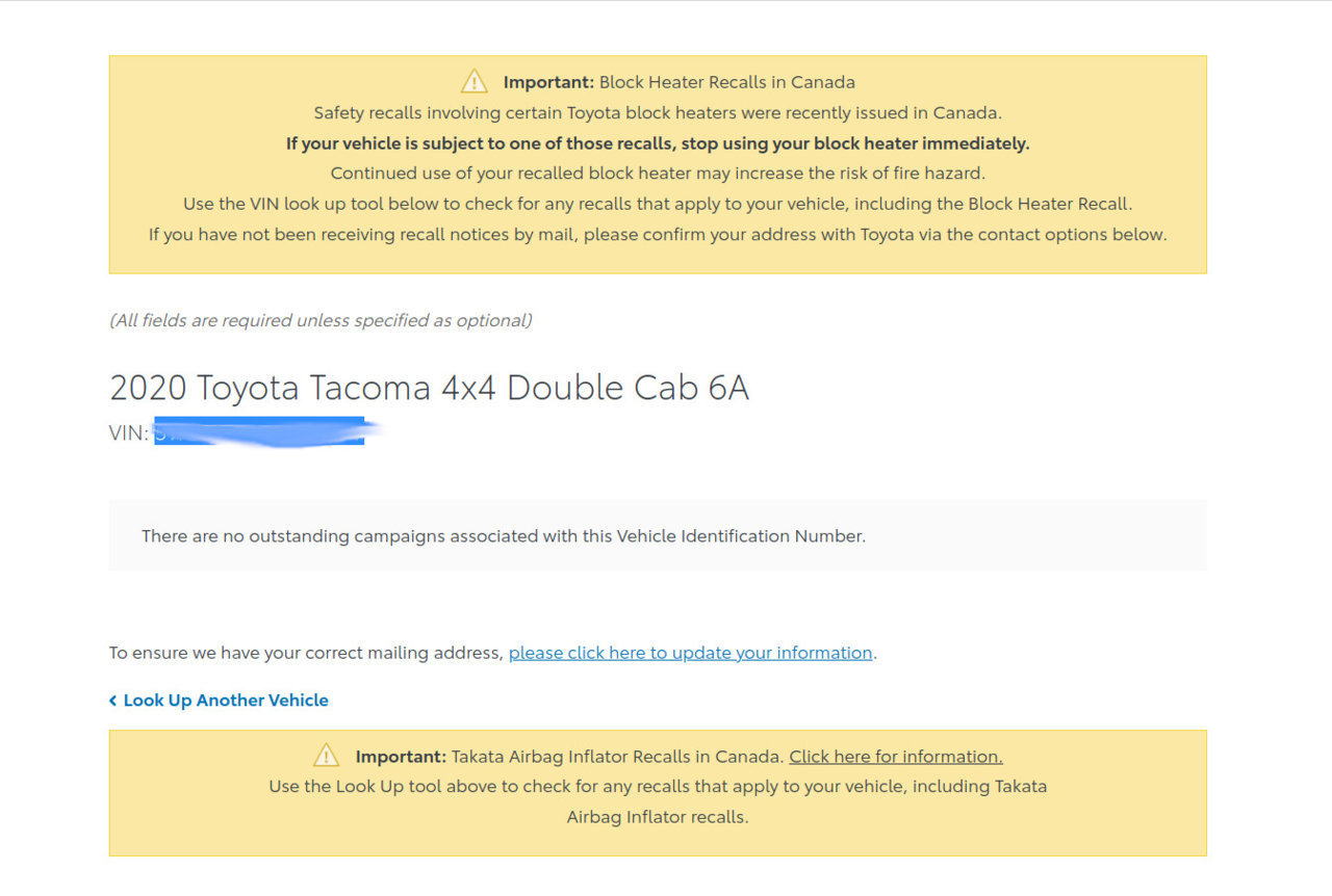

  13. Feb 13, 2022 at 12:47 PM
    #173
    Canadian Caber
    Canadian Caber R.I.P Layne Staley 67-2002
    Oct 28, 2020
    #345206
    2,768
    Les
    B.C. Canada, eh
    2020 TRD Sport DCLB 4X4 Super White
    @mrbeggins Have you made any progress with your case. Did your car insurance help you out? I checked my VIN on Toyota.ca and it is appaerently not affected. However they now have a big disclaimer notice at the VIN check.
