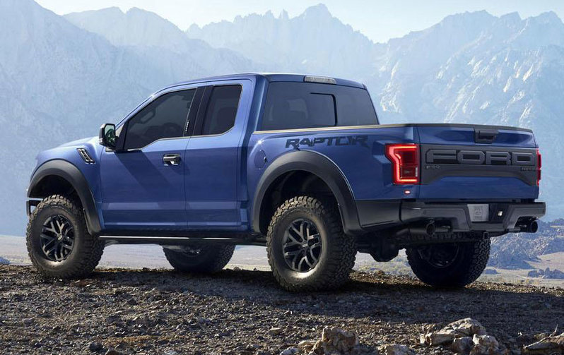

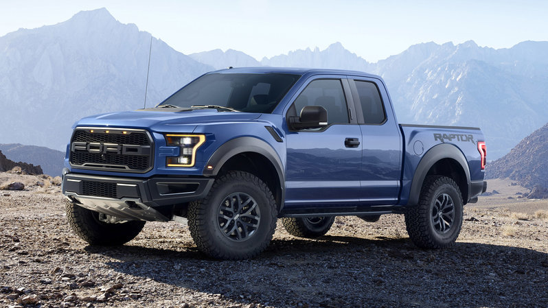

    I think that was an interesting idea for sure. Can you post pics of what it looked like without the red cover on it. I agree that DLR would be a cool addition. I was actually thinking of getting the ford raptor front and rear LED lights that go either in the fender or front and back bumpers. What are your thoughts? I attached a front pic and back pic of what I'm talking about. Front are amber and back are red.

    Did someone mention RAPTOR STYLE???
    If I can squeeze the Glow tube around the perimeter...it would be the cherry on top:fingerscrossed:
    Stop giving me ideas..otherwise I'll never finish these things!!!:turtleride:
