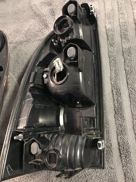

    Reverse bulb adapter Prototype lookin' good.( few minor design changes)
    This is how you stuff a 7440 Turn signal(or switchback) Into the TINY 921 reverse socket.:taco:

    No updates, but I've got cutting these tail lights DOWN.
    And just to rub in... AMBER turn signals and 5k White reverse(red turn is soo 3rd gen)
