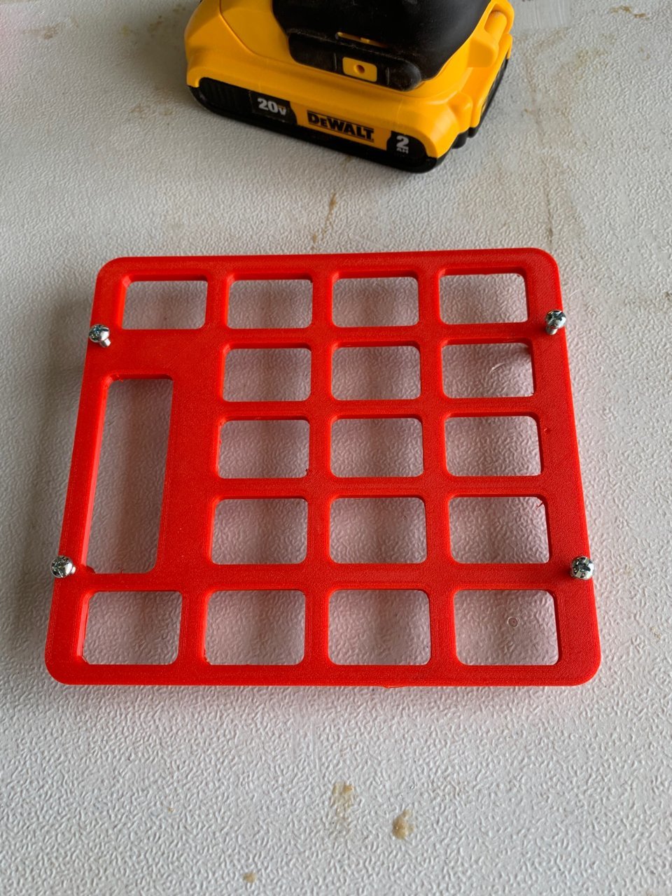

    Got inspired by seeing my friend's MOLLE panel in his 4Runner in the back window, had searched and found that some people had center console MOLLE panels from elsewhere and thought, dang I could use one under my armrest to help organize a little!
    I dabble in 3D modeling using SketchUp and decided I could make something that fits perfect in there to hold my flashlight, knife, and maybe a small pouch. Couple days after work of playing around with ideas, an additional week of scrapping the idea and starting over, a few cocktails and voila... version 3.5 was ready for printing.

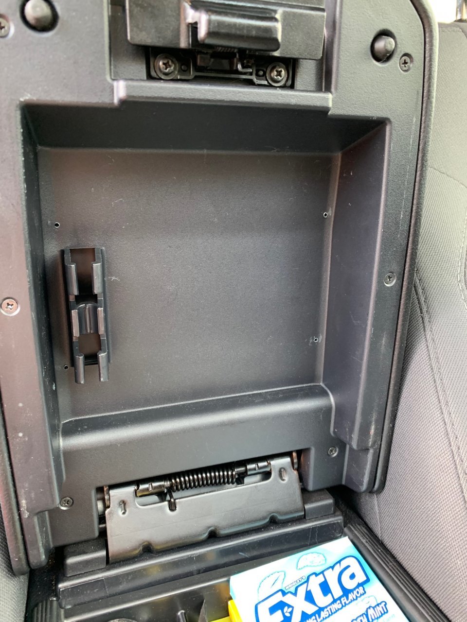

    I held the panel up to the bottom of my armrest and took a super small drill bit through the holes to get them predrilled slightly.
    I printed this using PETG which is supposed to be stronger, more flexible, and lighter than normal PLA that is used for most 3D printing. Once I got the design finalized and finally printed the dang thing out I screwed in some 6-32x3/4" screws to have them ready to go.
    Here's a backside view to see the built-in spacers I designed to give myself some space in order to be able to weave through the slots.
    Then I just lined it back up, screwed the thing in, and boom, MOLLE panel under my armrest. I debated spraying it black to make it hidden, but the TRD 4X4 decal on the side and the cupholder/cubby liners/mats I bought on Amazon are all this bright almost neon red, and this matched nearly perfectly so I decided to leave it as is. Hope this inspires someone else to do the same!

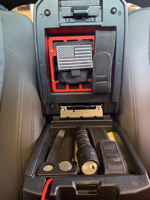

    Thanks to all of you guys for the kudos! Glad it was received well. Here's a pic with a small pouch and a knife holder/sheath/whatever (yes it's mounted upside down intentionally, knife slides right out into my hand when I open it that way!) I wanted to have the knife pouch and flashlight pouch mounted horizontally to fit both, however the flashlight is JUST too big, so for now it's sitting there underneath. But overall SUPER stoked on how it worked out.
    Still some kinks to work out, I want to make each square taller, straps had to be folded somewhat to fit in sideways (in my pic you'll see I ended up mounting two things vertically) and I'll therefore have to redistribute the spacing of each cut out. The spacers I have behind it were the perfect height to be able to weave the straps behind it while getting as close as possible so as not to waste space.
    After a redesign and refitting I'll see how it turns out and then can make some for you gents!
