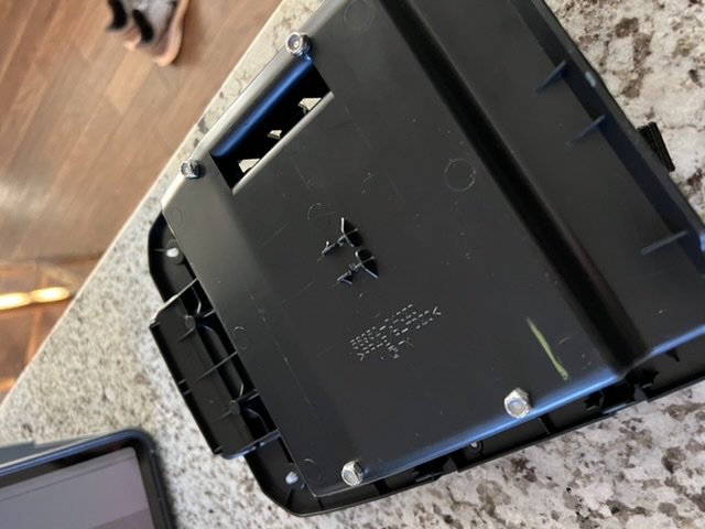

    Gave it a shot today. Used #6-32 3/4” screws with a lock washer and a nut. Worked out great and holds the molle panel in there solidly. The center console plastic insert really doesn’t fit all that well back into place (bc of the nuts), but it will mostly click back in (the 6 screws are what holds it in there). Overall very happy the product and it turned out great!

    Great to hear that the 3/4" was long enough to get nuts on there. Thanks for the pics! Based on those, I may try to run the bolts through from the back to get a lower profile to snap it back together. We'll see,

    That is actually a really good idea and would 100% fix the fit issue
    Follow up: did the swap, and it fit right in

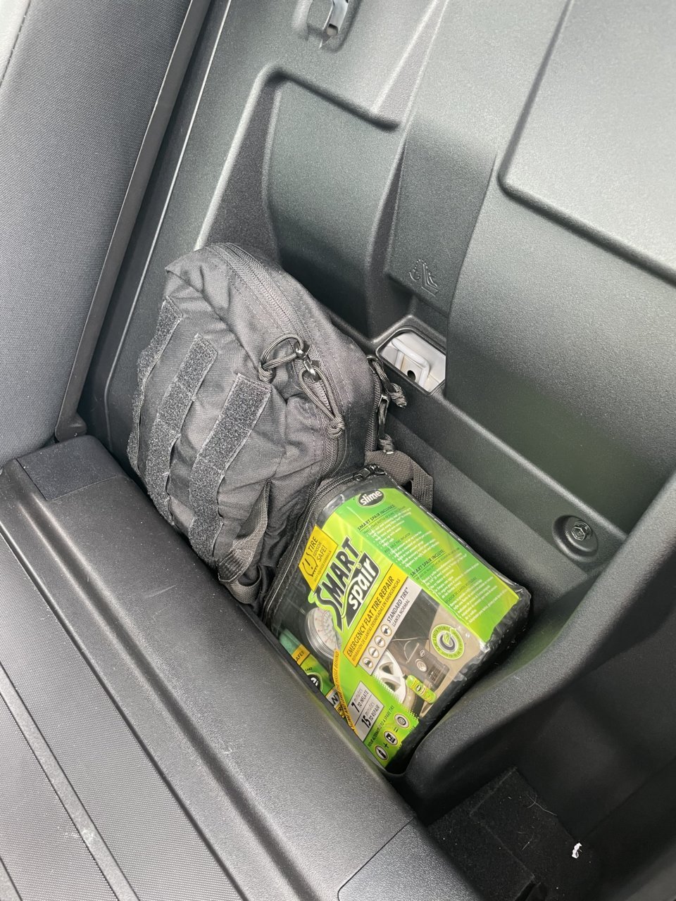

    How does the molle pouch fit with the organization self you have in the picture? Is the pouch bulky enough to rub or catch on the shelf?
  20. Jan 11, 2022 at 9:02 PM
    #140
    fishing4boulders
    fishing4boulders Well-Known Member
    May 27, 2020
    #329577
    137
    AL
    2020 OR Tacoma 4x4
    I tested it a few times. The arm rest closed without any resistance or noise, so the pouch may rest on the items on the shelf, but I don’t think it’ll be an issue. If I had taller stuff in the shelf or maxed out the pouch, it may cause a problem.
