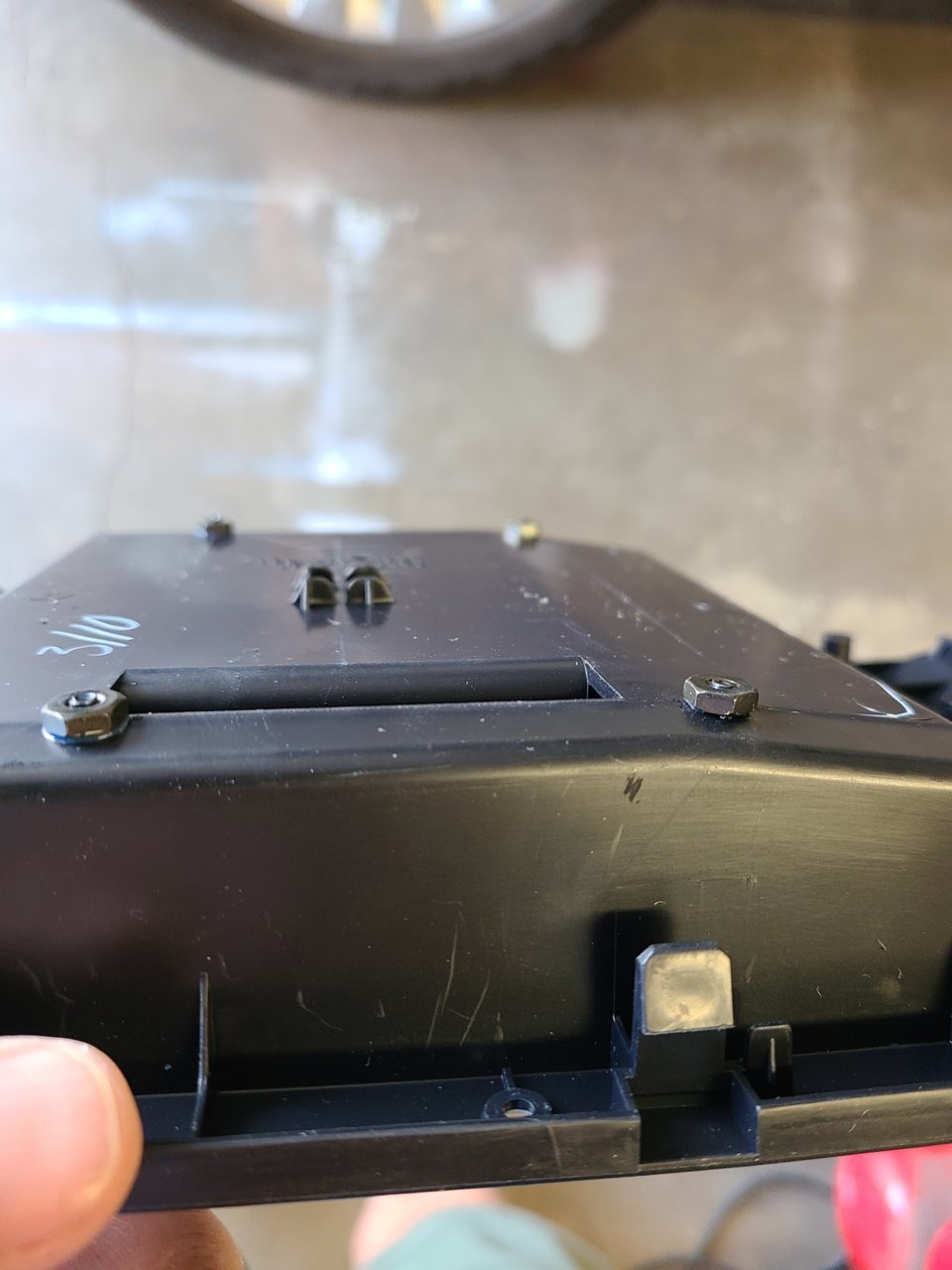

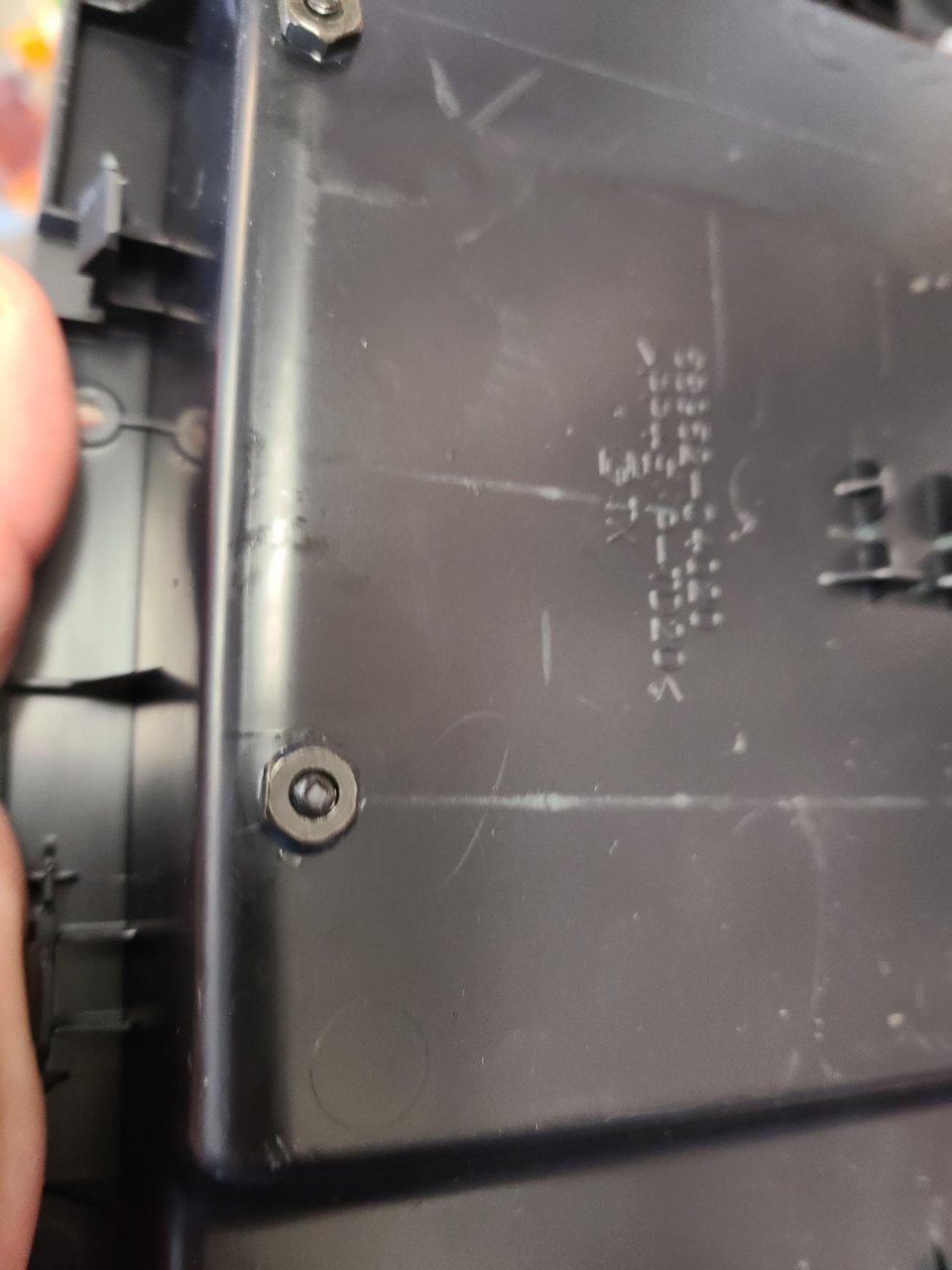

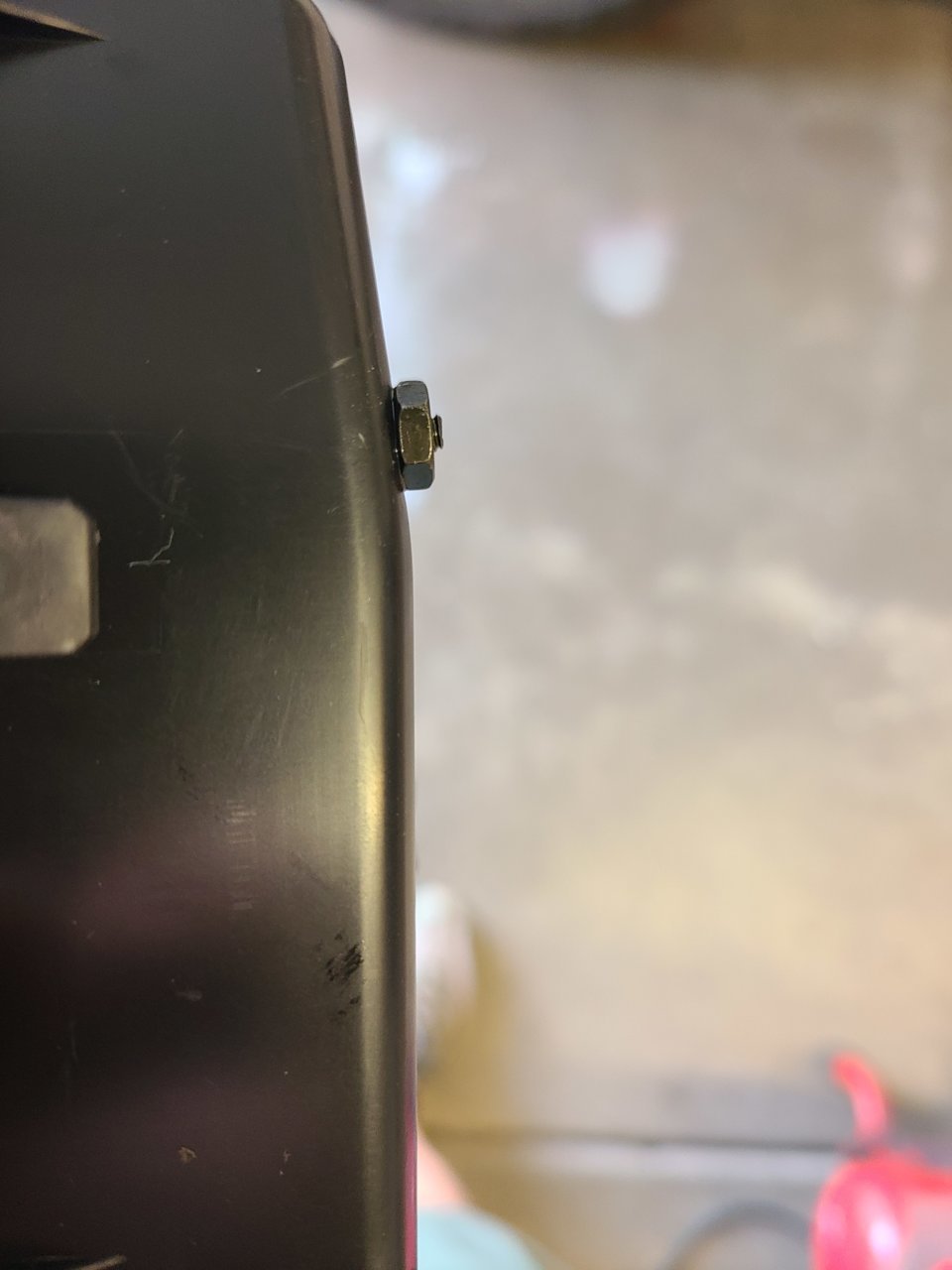

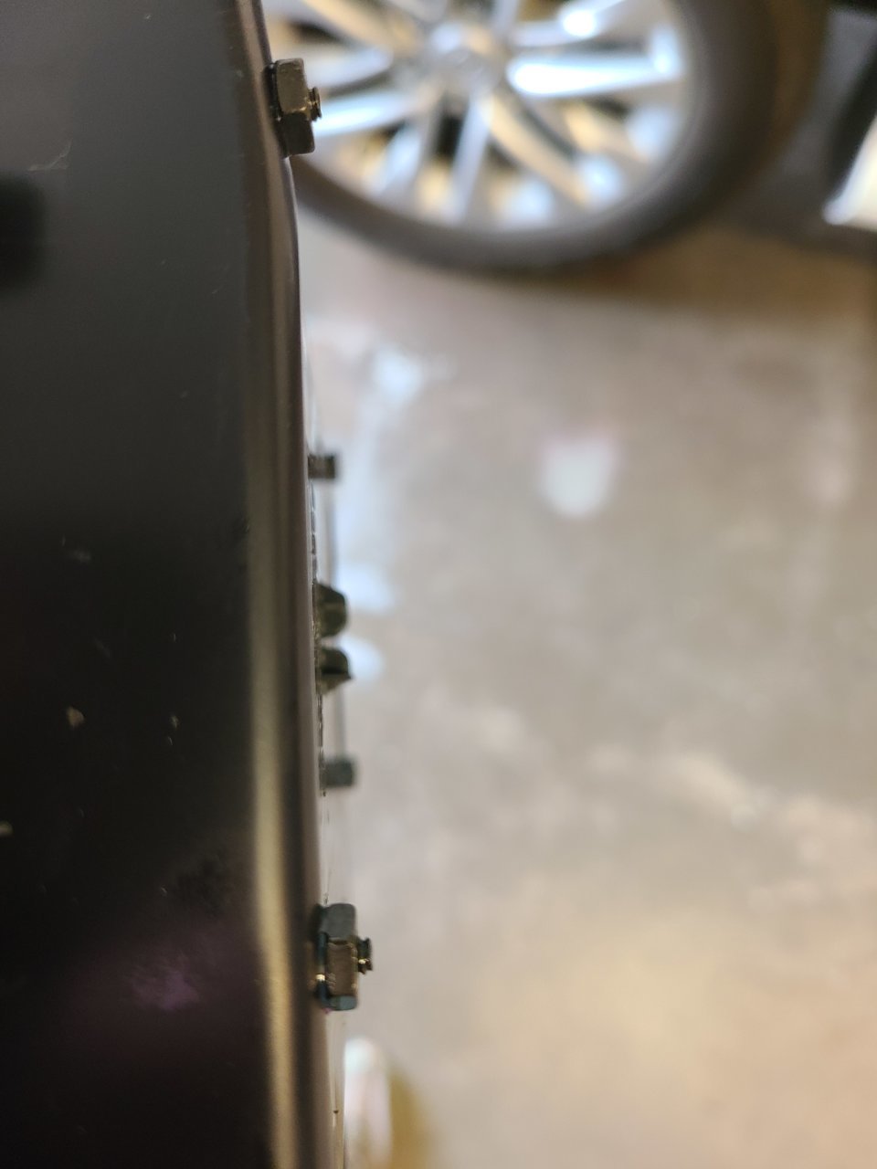

    Easiest, 10 minute mod ever. Thanks El Tigre!
    I did the bolt thru method. Pop the 6 screws out of the center console, popped the stock piece out, drilled 1/8" holes through the 4 bolts-hole locations, installed 6-32×3/4" bolts through, and used low-profile nuts (and a dab of blue lock-tite cuz I hate rattles). PERFECT length. No interference putting it back in. A pic is worth a 1,000 words...
    Now to figure out molle pouches, etc...
