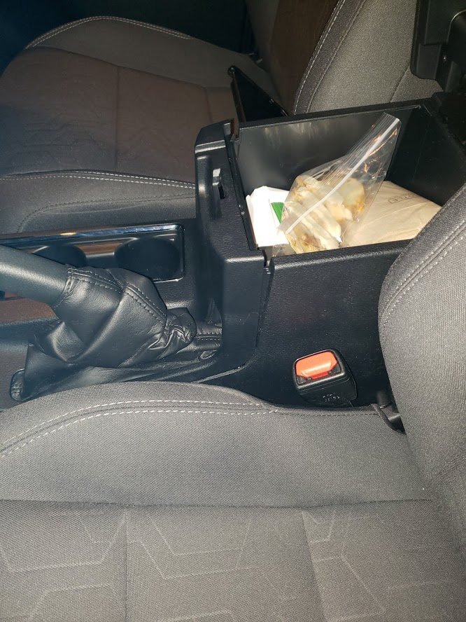

    Blarg, I am actually having trouble snapping my center console back in on my 3rd gen manual Tacoma.
    Anyone have any tips?
    It snaps in from front to back when re-installing but the part that hits that center glove box won't snap back together....
    Figured I'd ask in case anyone has any tips.
    ps - URD Short Shifter is RAD.

    What the fuck is that in your center console?

    You have to get the lip up and over the console for it to snap down.

    That is home-made drugs, I MEAN biscotti, for coffee.
    Which is essentially crack, so it's drugs lol. :cookiemonster:

    Ohhh, I will try that.
    Thank you!
    Again, had to ask as it's easier then breaking something and then having to fix it.
