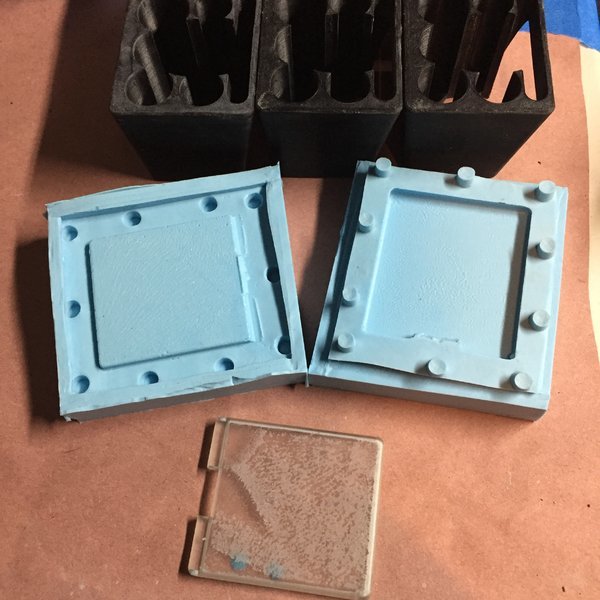

    A small update, I worked all weekend to get some new molds done. All seem to be working fine except for the lid. However the lid is looking promising. Below is a pic of the lid fresh out of its mold which I cracked open tonight. The issue this time is the mold. Unlike the other molds I made at the same time, the lid did not cure 100%. But I'm not discouraged, all it needs is a bit more time to cure. I have some ideas on accelerating the curing time.
    I'm shipping out the regular coin holder tomorrow and have some more ready to go for those interested.

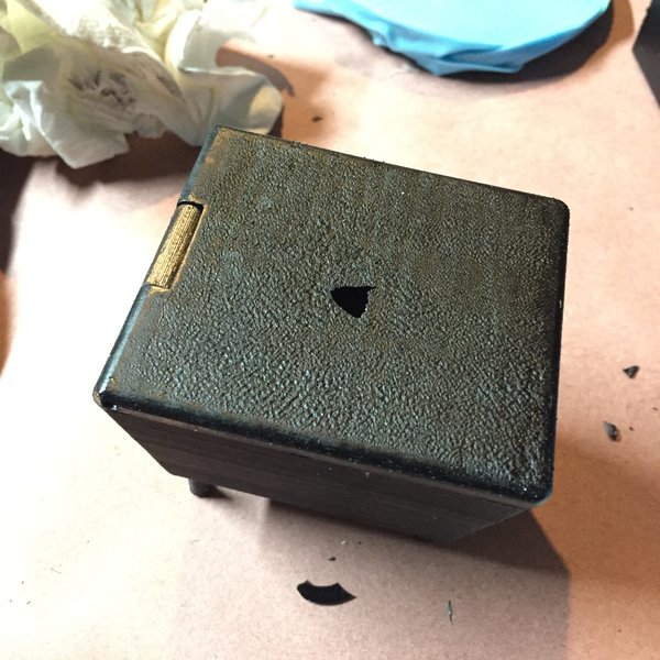

    Lid update:
    I cast the first lid today out of the new mold. It came out with some texture due to the mold taking longer to cure. But it worked.
    I'm gonna work on it again tomorrow night and sort out any kinks left in the process. Crossing my fingers here in hopes I can get these in the mail right away.
    Here is a picture of the first lid sitting on an organizer. The hole in the middle was caused by me applying too much pressure while removing it from the mold. I promise none of yours will have that hole.
