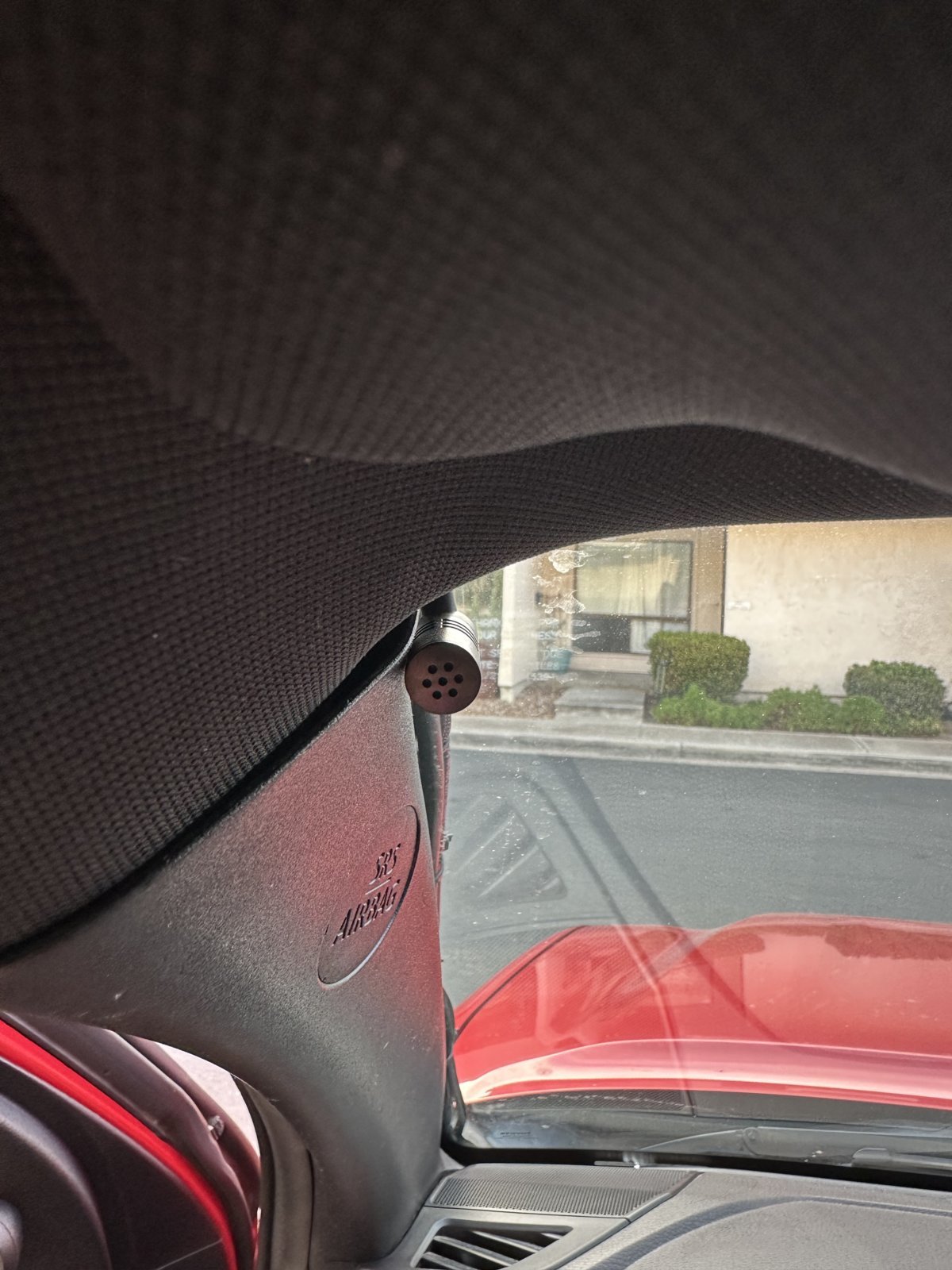

    I have the same head unit, I put the mic in the A-pillar, safely out of the way.

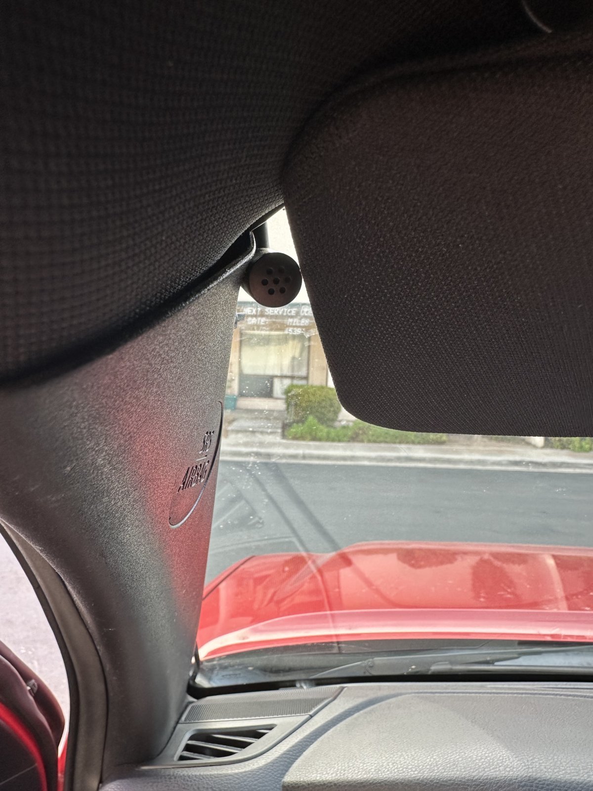

    not exactly safely out of the way though. that is exactly the panel that blows inwards when the side curtain airbag deploys. depending on your wire routing, it could easily become an additional projectile in an accident.
    i routed mine to just above the rear view mirror, and kept the wire to the glass-side of the a-pillar to avoid airbag deployment issues.
