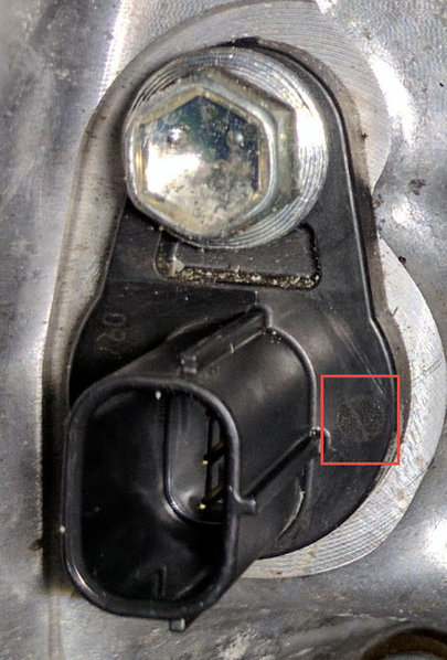

    An easy way to confirm if you have the new CPS installed or not is to disconnect the harness and use your smartphone to snap a photo.
    No hash marks = bad
    Hash marks = good
    MOC221_, over60, shakerhood and 4 others like this.

    Great to know, so just to clarify.. your picture is of a good one, since it has the "hash" marks, right?

    Yes sir!
    I should mention the rubber boot protecting the harness makes disconnecting it from the CPS a bitch to release. Go gentle. The tab to release the harness is located on the left side of the CPS. One member here pulled the wires out of his and ended up having to solder everything back together.

    When I changed mine I had trouble getting the connector off while the sensor was still in place in the engine block, so I pulled the sensor out first then disconnected the connector. Easy peasy.
