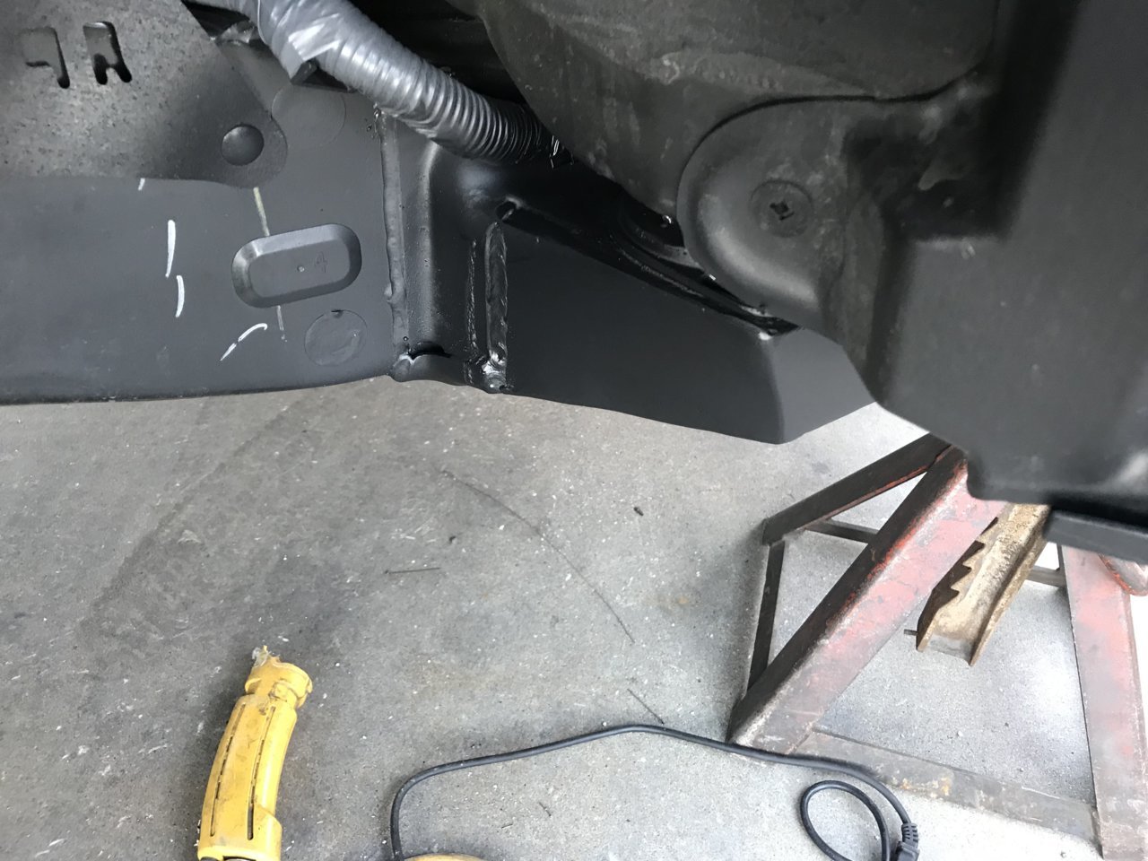

    feel like hoping a plane to jersey , that's a great job , even did the side as well nice , anyone in upper jersey want to do mine ........... anybody ?

    I'm sure they do and I could see it taking longer to cut the tip off as well. But most shops dont do that so if they are billing more then an hour to do a standard cut they are billing too much.
    I've seen shops in the bay quote my customers 500 for a cmc and it's just crazy.

    I’ve heard that as well. Generally when Ive seen prices like that it was from off road shops that don’t specialize in tacomas or body shops. I’d imagine a lot of shops really would prefer not to do cmc’s or definitely wouldn’t view the $100 as enough to make it a job worth performing. I’d say it’s definitely one of my least favorite jobs to do.

    Holy smokes that looks good!

    Seriously. I mean, I have the skills and tools to do a CMC and pinch weld, but honestly, not the time. If he's still watching @schmellmopwho can we talk? I'm in Carlsbad, CA and will gladly drive to wherever you are in So. Cal with pizza, beer, carne asada fried, whatever the fuck you need. :D

    Damn, that's sexy. I want that right there. JUST LIKE THAT!!! :D
