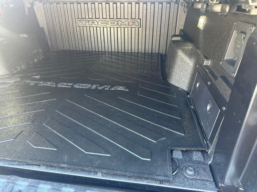

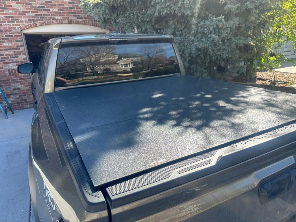

    Hey Guys - Thought I'd share in case anyone wondered if this would work, I searched for info everywhere but couldn't find an answer. I have a Lomax Tri-fold that I put on my '22 and took it off before trading it in, their site shows the same part number for both 3rd & 4th gen's. After looking at it I could tell there was no way it would work without some alterations/riggin. I had to cut a 1/2 inch slice in the front and bend it to match the new front bed angle and rig up the rear mount. It's very solid just need some new seals to fill the gap between the rail and the side of the bed and it should be perfect. Also trimmed a half inch out of the wheel well angle to fit the rubber matt from my '22, you can see the front section has about a 1/2 in gap on each side but it doesn't move since the back was the same size. Saved me 1300-1400 bucks!
