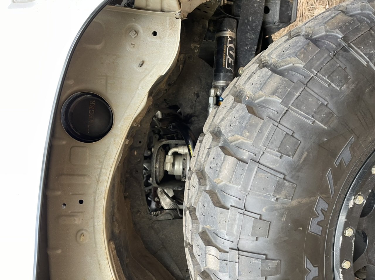

    Well............. I finally did the deed...
    I recently removed my fender liners and chopped up my fenders on my 2018 Pro, knowing that I would have to figure out some solution to the air intake that was not exposed in the fender well. I have taken some headlight deep water crossings before this moment, and considered a snorkel, but I personally cant stand them. Here is what I came up with.
    Inspiration from the DIY happy 2nd gen's owners of course. ANDDDD
    Appears here at 4:25--->
    https://m.youtube.com/watch?v=sgxXlParoRM&feature=youtu.be

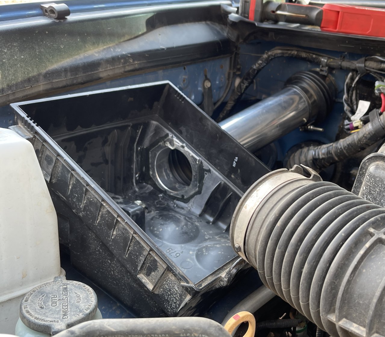

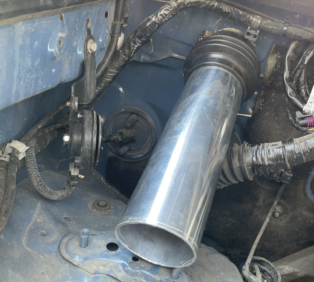

    So to start off, to those who don't know, this is where your airbox pulls from. You can see where this would create a major issue during water crossings, and even issues during rain, mud, snow, dust, dirt, bla bla bla bla. If you don't want to figure out how to protect this, leave your fender liners on..... Of course the obvious option is either get a snorkel, or fab your own liner. What I wen't with is a less known option, but one to think about if you are handy with a saw and have a free day or 2.
    I'm going to keep these split up so I can be as detailed as possible. Here is the crap you will need, to get this done:
    https://www.homedepot.com/p/Milwaukee-4-1-8-in-Hole-Dozer-Bi-Metal-Hole-Saw-49-56-9646/202327762 ((TO CUT THE BOTTOM OF A BUCKET or whatever... OUT TO PLUG YOUR INTAKE))
    https://www.homedepot.com/p/Milwauk...h-3-8-in-Arbor-Pilot-Bit-49-56-9670/202327741 ((TO CUT YOUR TRUCK!!!!!!! ))
    https://www.amazon.com/gp/product/B005M1Z1D8?ie=UTF8 ((2 OF THESE, ONE FOR AIRBOX, ONE FOR COWL))
    https://www.amazon.com/dp/B00HG7D56G?ref=ppx_yo2_dt_b_product_details ((2 OF THESE, ONE FOR AIRBOX, ONE FOR COWL))
    https://www.summitracing.com/parts/sum-294512 ((I ONLY NEEDED 9 3/4" RESULTS VARY))
    *Epoxy/Silicone/Clamps/Beer/Patience/More Beer*

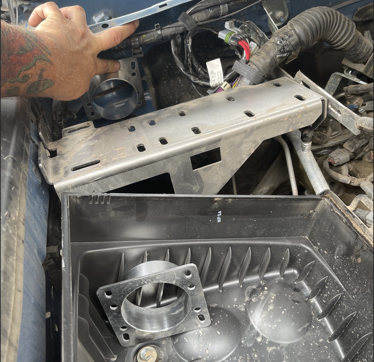

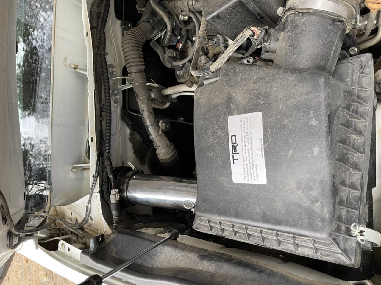

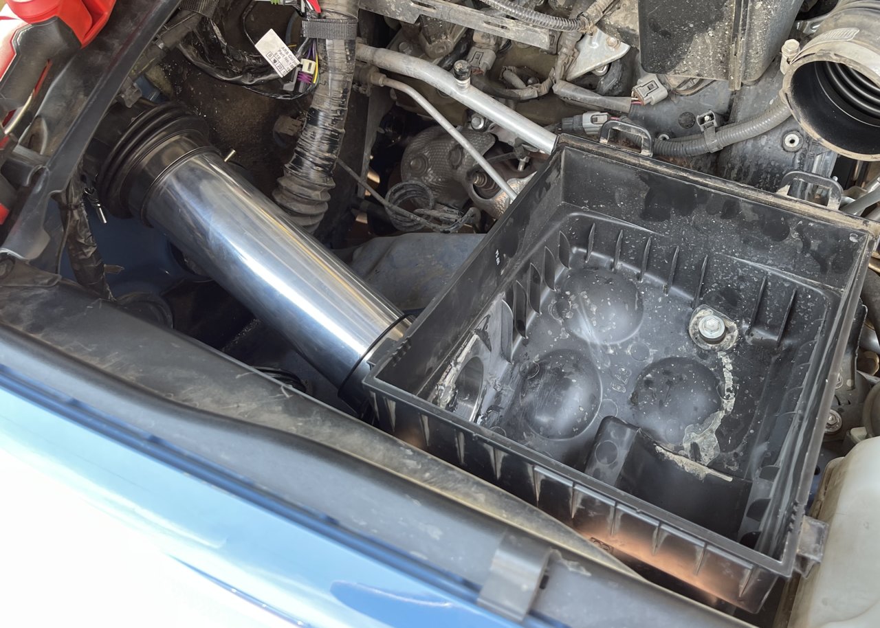

    Alrighty huge thanks to OP for taking this on and documenting it, I finished up the install this weekend. One thing I will clarify and something I learned from this is that the OPs solution will not work for all trim levels (ill go into detail below).
    Here are the parts I used:
    Spectre Air Duct Hose
    Spectre Air Duct Mounting Plate
    Clear silicone
    Tools are the same as OP, and I will emphasize the beer and patience again!!

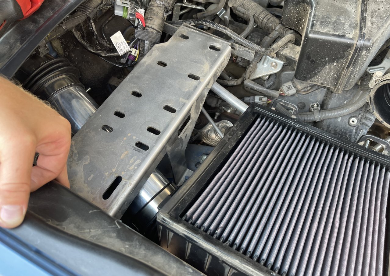

    Originally I saw this post and was going to order the same parts asap, for a while I have wanted to cut fenders but would need to figure out a solution to the intake. I don't like snorkels and I don't want an aftermarket intake so in steps this mod. However, I figured I should look under the hood just to get a visual of what is going to be done.
    Come to find out the SR5, TRD Sport, and Limited trims have the ABS module in a different spot than the TRD Offroad and TRD Pro (I don't know if its different from year to year, I have a 2017 SR5). This ABS module is right in between the firewall/cowl and the intake box, this keeps us from the various dual battery solutions, compressor mounts, and also we cannot use the same method as OP. You will see in my parts list I used a flexible hose, this was my solution to get around that ABS module.

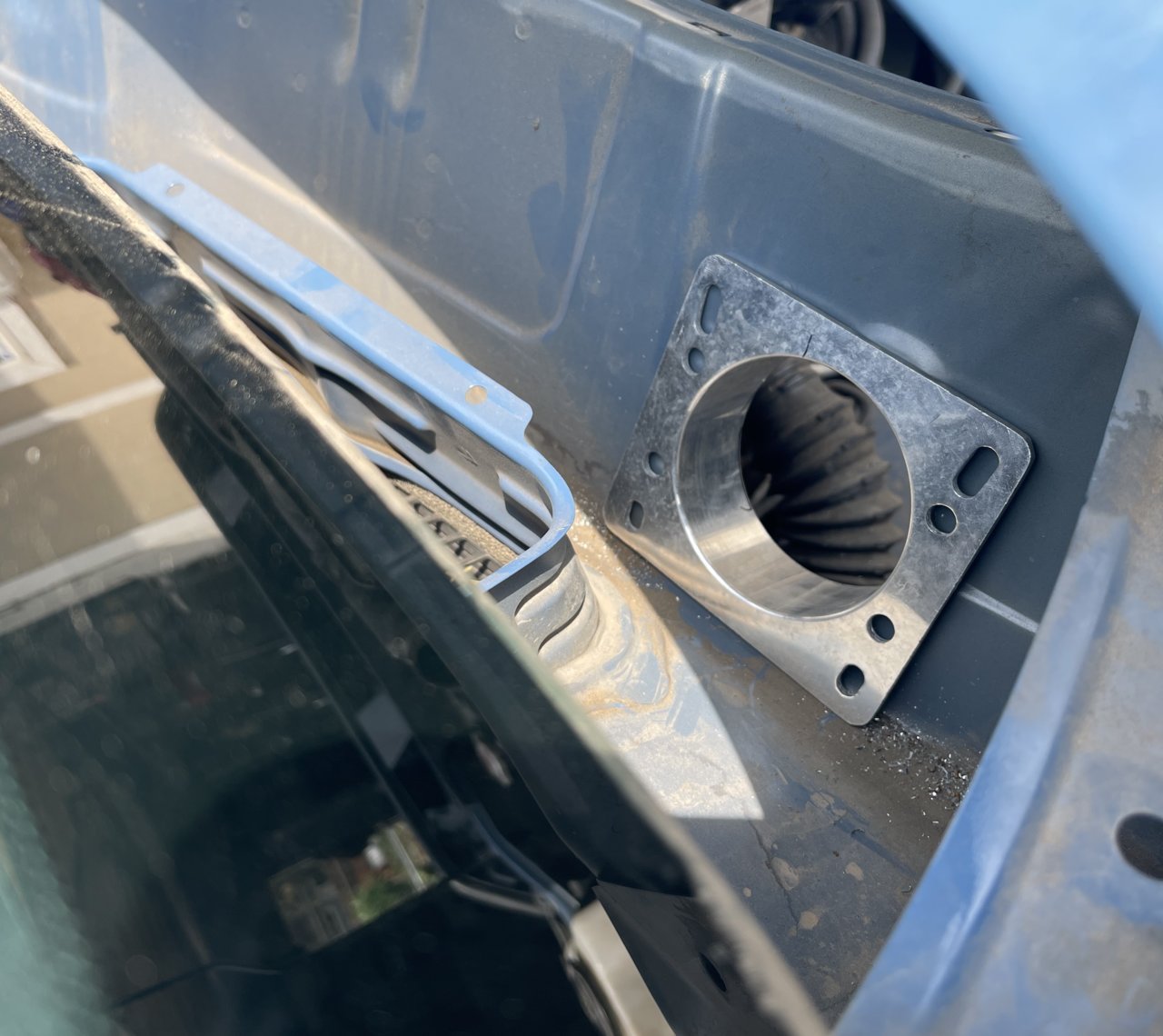

    The work is exactly the same, drill into the cowl, silicone the plate, drill into the intake box, silicone the plate, connect the two.
    Location on cowl:
    Location on intake:
    At first I was going to leave the ABS module in its place but it would have been such a tight fit that I ended up removing the three 12mm nuts that secure it and shift it towards the motor and used only two of the nuts, when doing this be sure not to pinch your ABS lines.

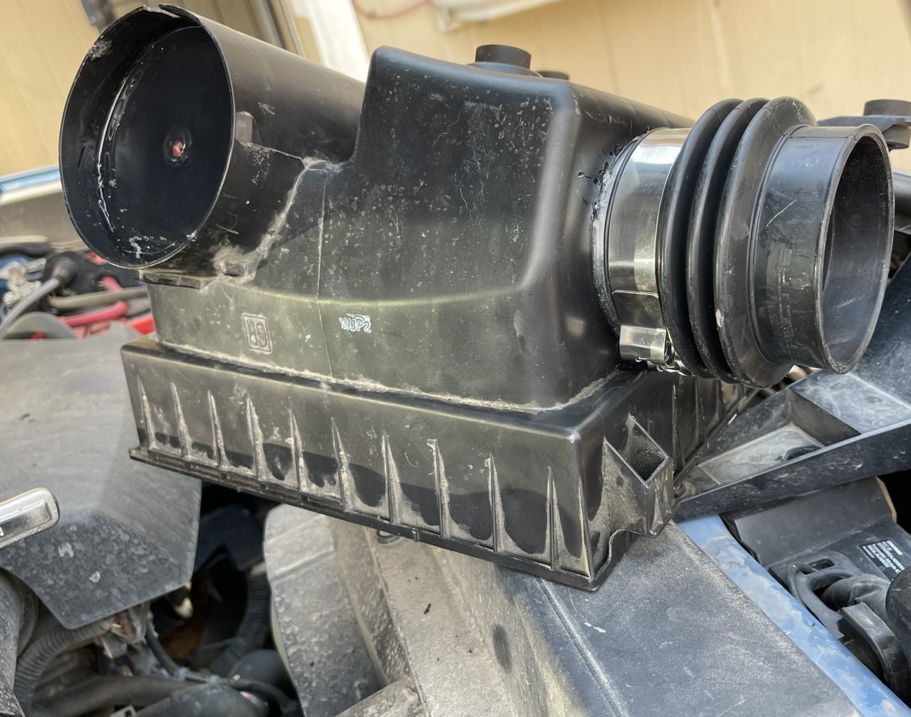

    Everything connected:
    Overall very happy with it, there is hardly a noise increase and we will see about MPGs as I drive it. Initially was worried about it staying connected but flew down some washboards at 30+ for a handful of miles and no issues so far.
    Let me know if you have questions and again thank you ZebraScissors!!

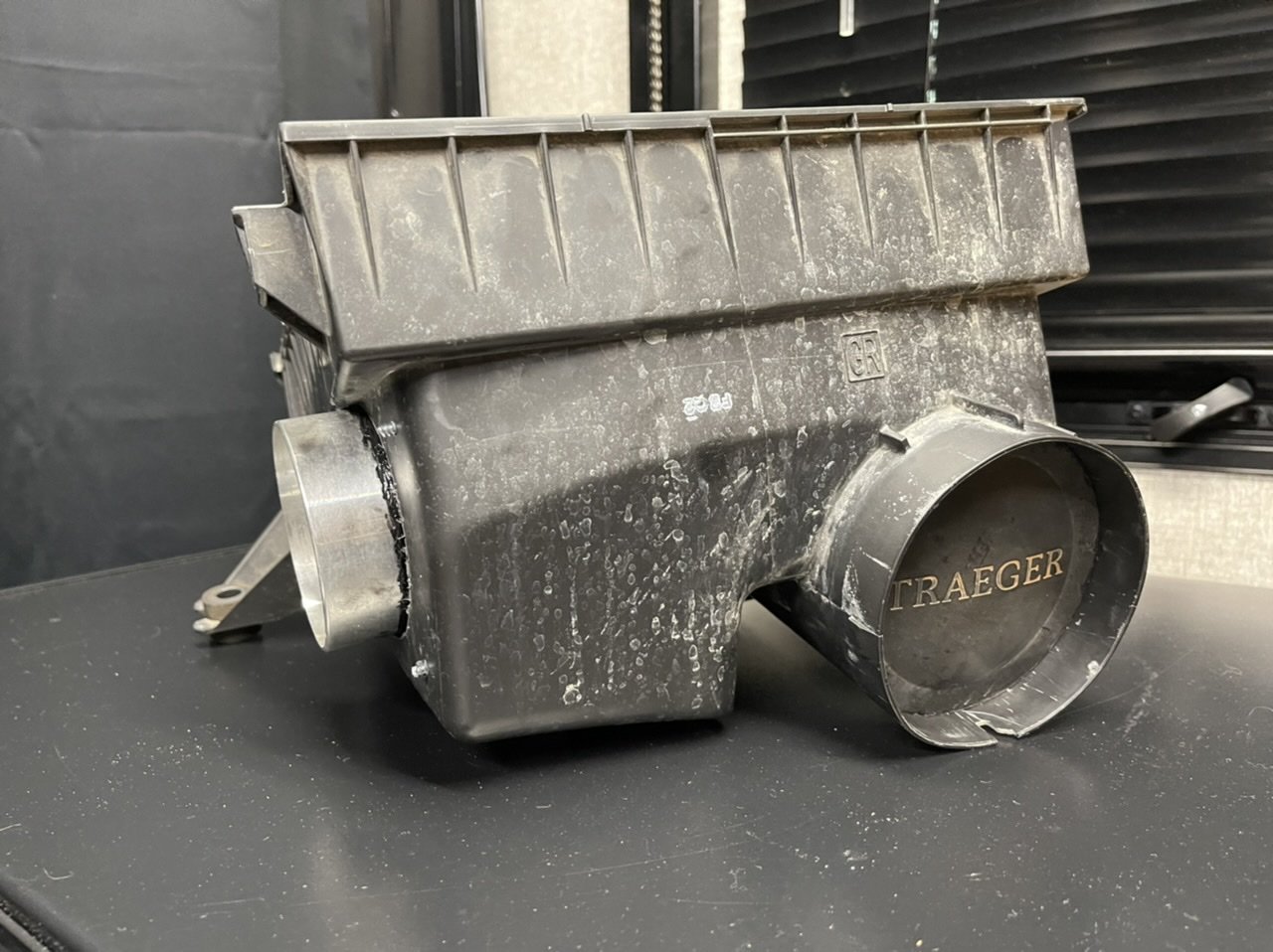

    Cowl induction intake finished and sponsored by traeger lol.
