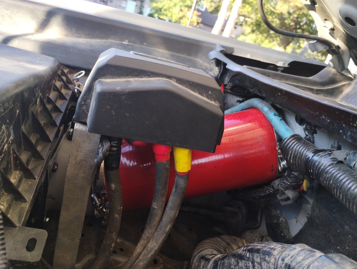

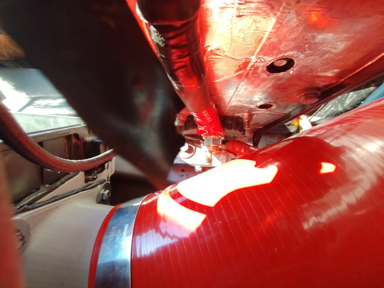

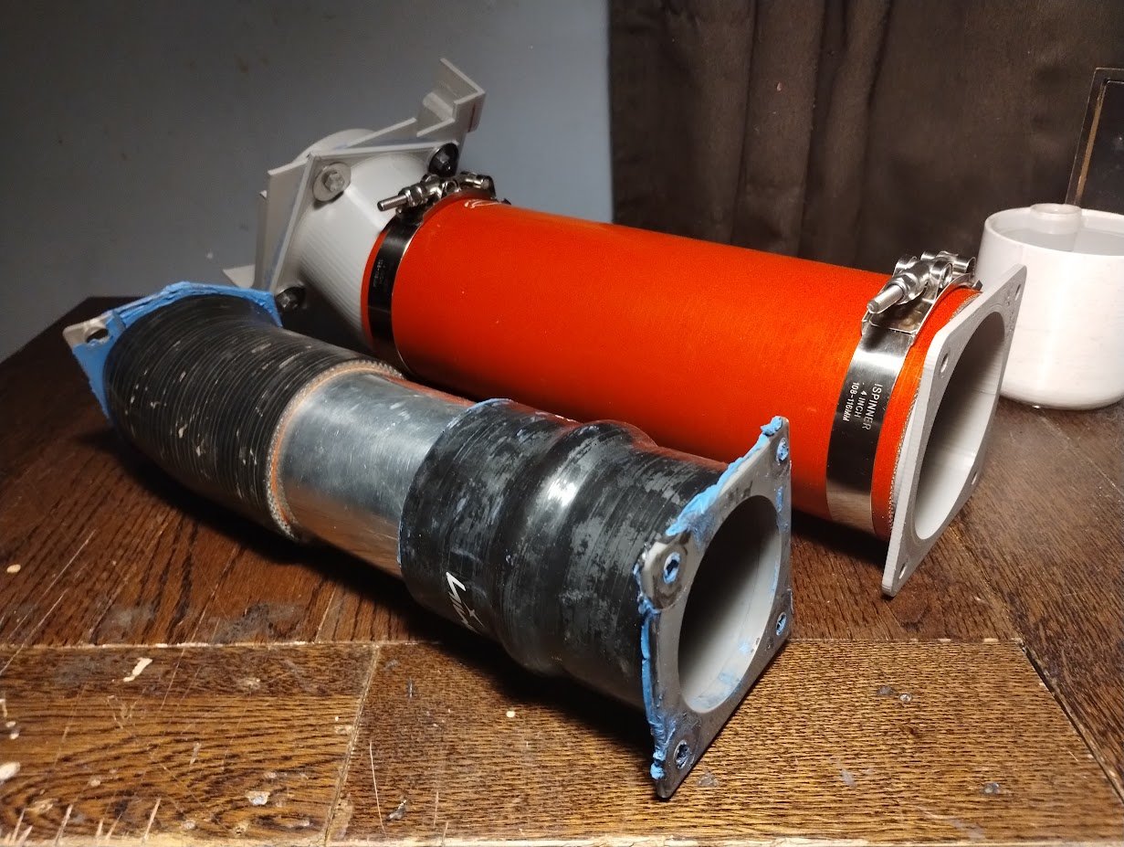

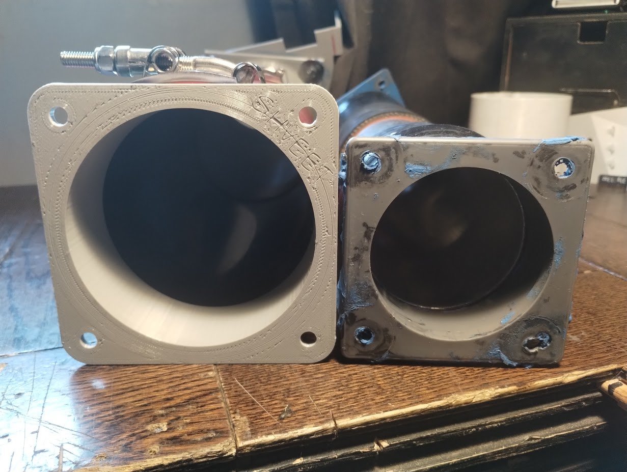

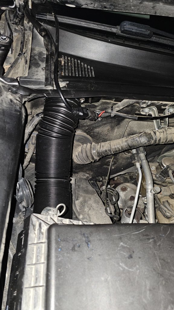

    OK! so, got the 4inch tube in, installed, and have initial thoughts/ review about it. 4 inch induction snorkel sucks...
    ...like a lot of air and it feels so much better than the 3 inch especially feeling all the "lag" and "stalling" complaints that people brought up in the past, i know as i had those complaints as well but it's all non-existent now. Truck doesn't need a second to get up and go meaning response is fairly good at higher RPMs. It just feels like the OEM intake and i think that's a good thing. The engine is pulling in all the air it needs and the 4" just lets prevents the bottle neck that was caused by the 3 inch. I wont say you gain anything by doing this other than the raised water line and maybe lack of dust at the end of the day? hard to say since i didn't throw sand into the cowl just yet... maybe come late October when all the leaves fall off, if i'll find one or something.
    Overall it's hard to say what's actually causing the "feels better" bit since i also just recently updated to the OVT9 tune from @dave82at at YotaTune. But having the 3 inch in for about two weeks with OVT9 and initial impressions of the 4 inch intake with the same, the 4 inch definitely brings in some life to the truck. However, there is one downside to the 4 inch up size.
    CHRIST it's loud at 4k RPM. @Saturnine can vouch, the truck certainly sounds different and not in a bad way.
    everything under 2000 RPM is quite, same as you'd expect with the regular intake.
    2500 you start heading a burble/ rumble
    3000 ish you start getting more volume
    3500 hear the engine's rumble, burble disappears and you have the higher-pitches come into the cabin
    4000 stars to really get loud
    4500 levels off
    Have a video here in hopes to capture what's going on.: https://www.youtube.com/watch?v=q57z9BhKnwU

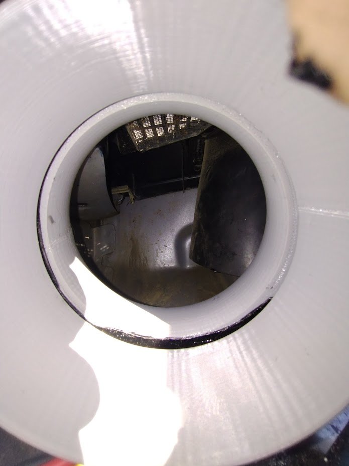

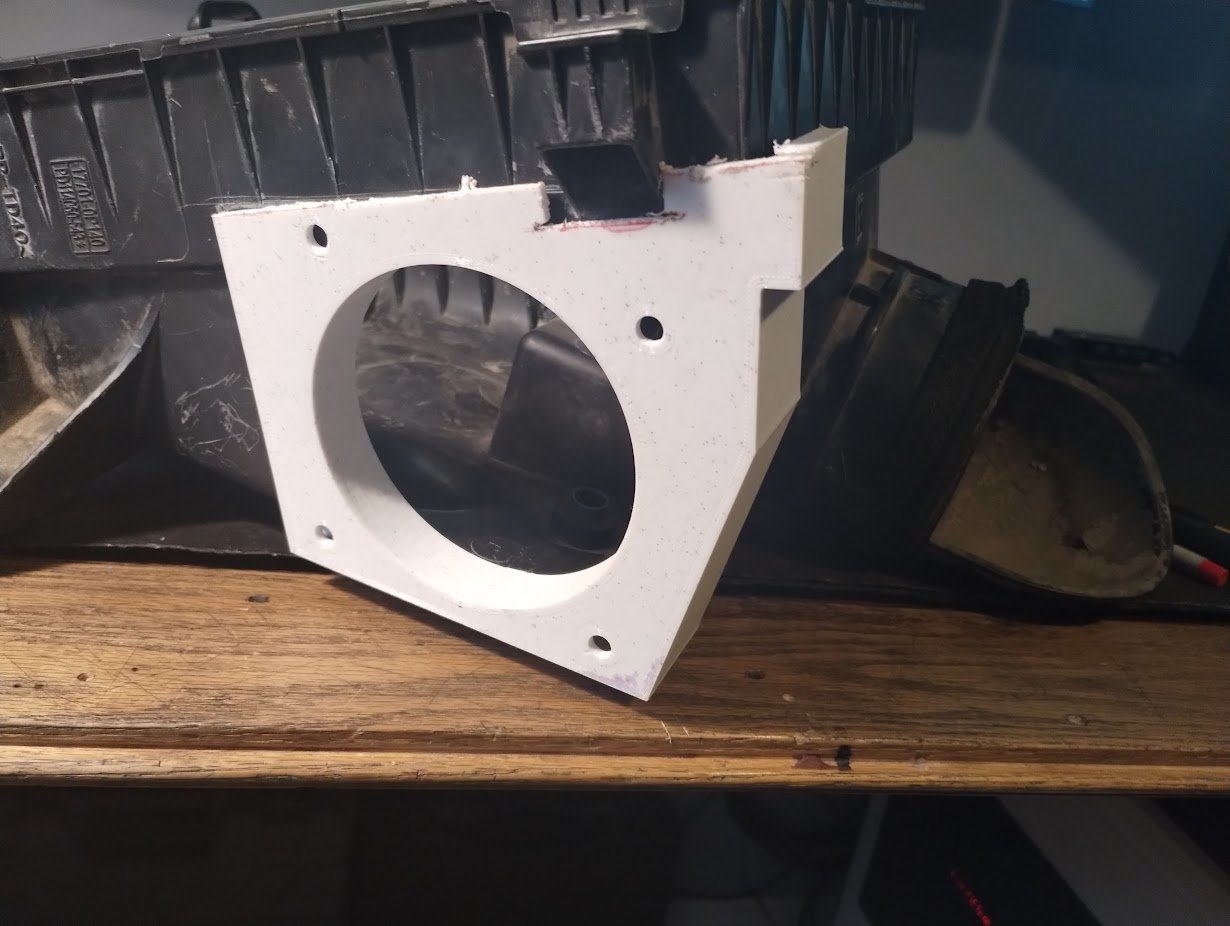

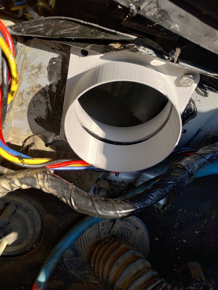

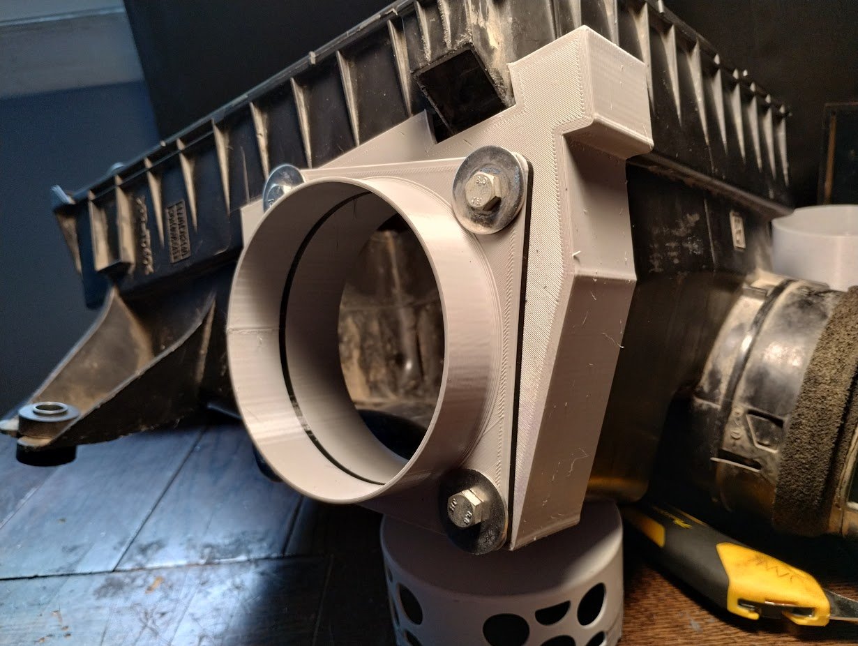

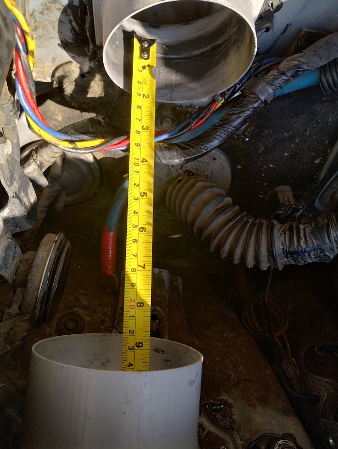

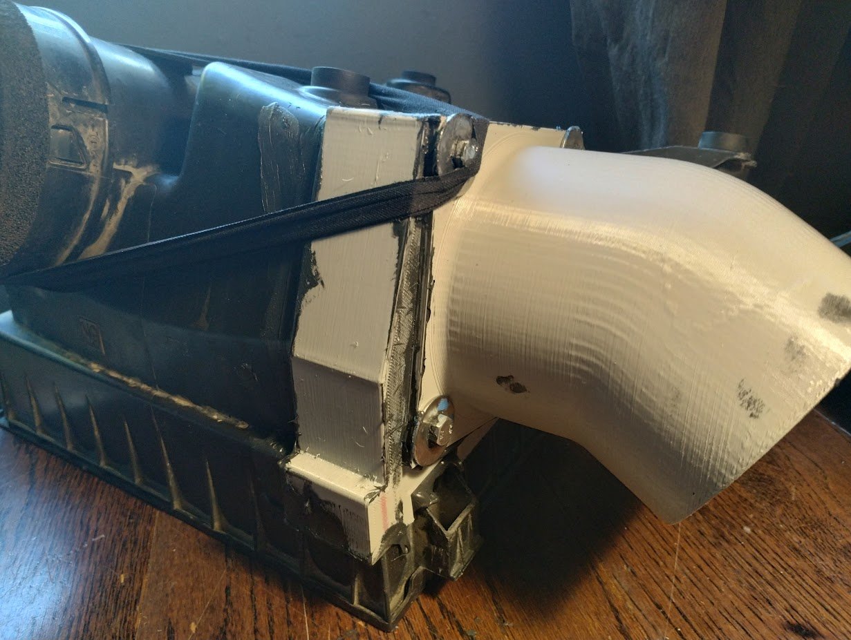

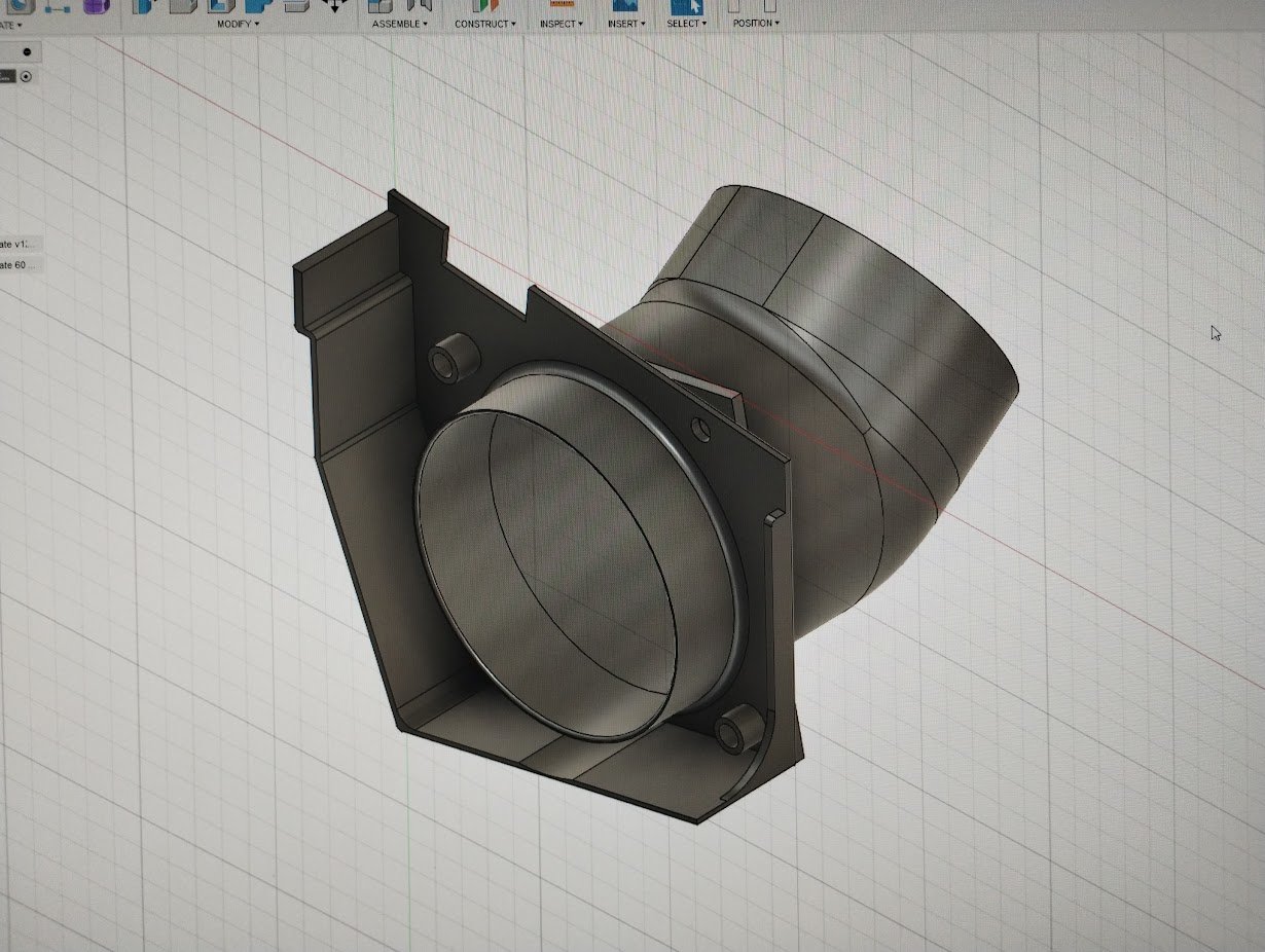

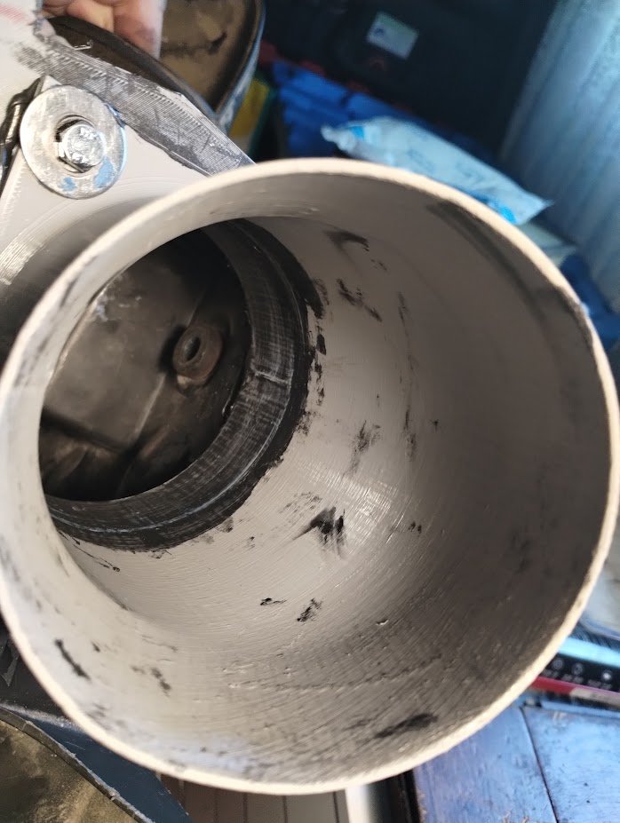

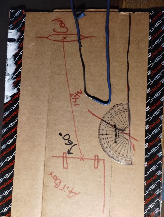

    Alongwith this, here is the "build montage"
    Step1) create an artificial problem, one that new tools with solve
    Step 2)
    design print and cut the template
    step 3) rinse and repeat, add extra parts:
    Step 4) measure and design shit in CAD. and then the other CAD
    Step 5) assemble and compare
    step 6) RTV everything in place
    step7)
    fill in gaps with more RTV
    step 6 (or 7?)

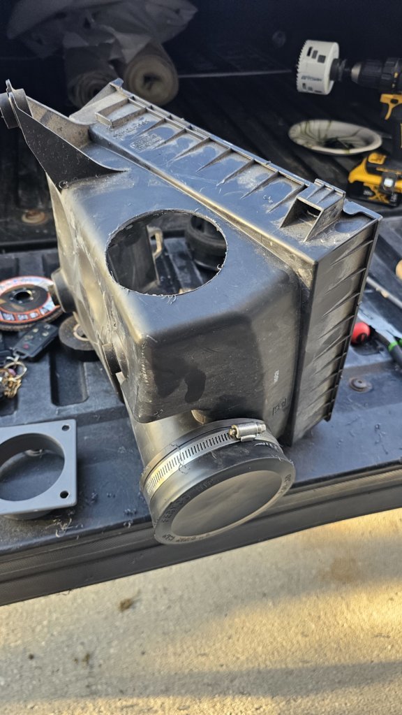

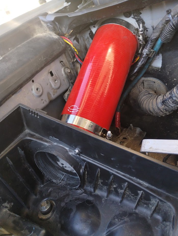

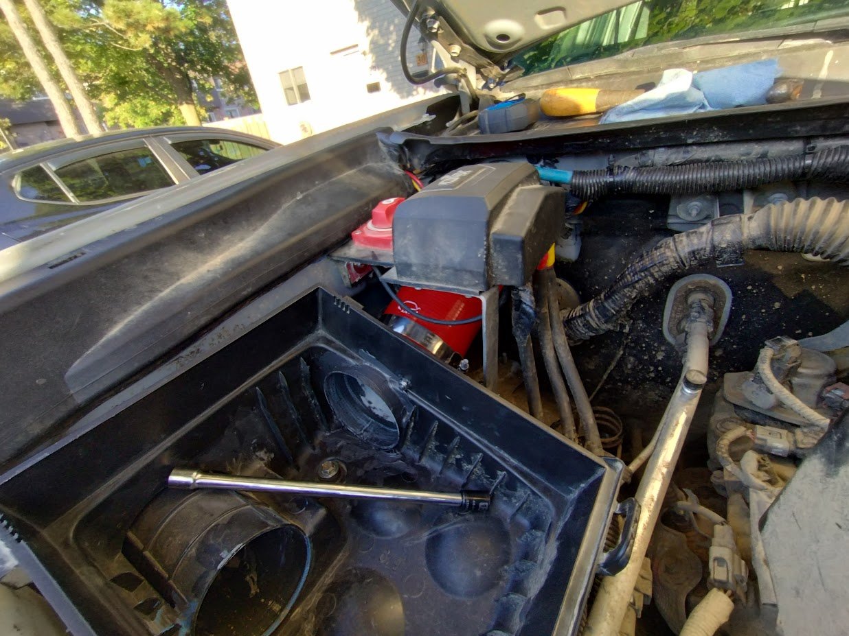

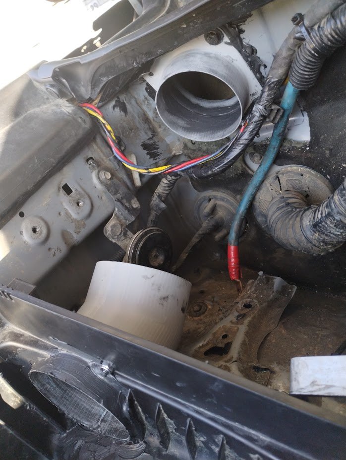

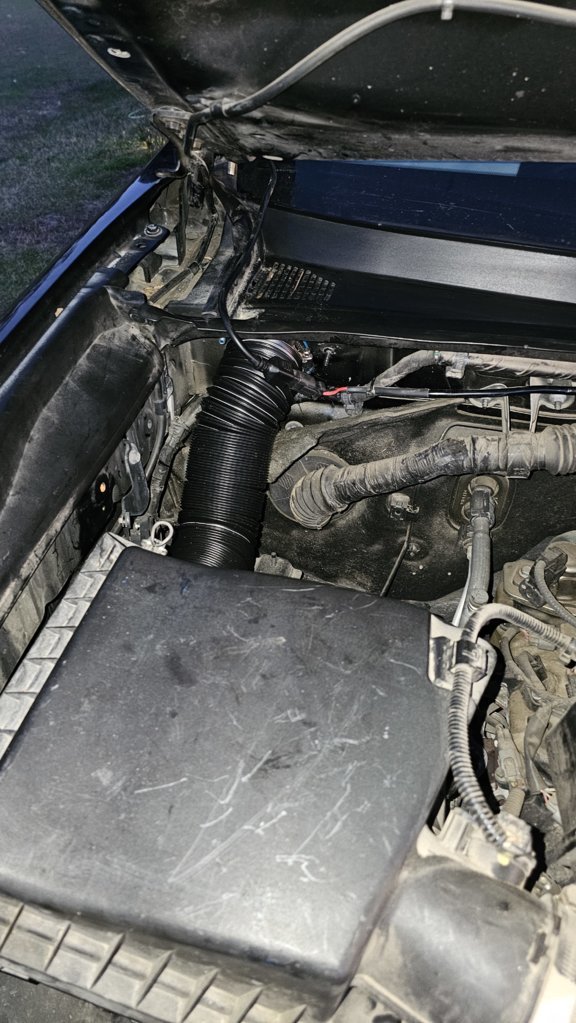

    When you installed this, did you take off the metal caps that come with it? Did you just attach it directly to the duck mounting plate with a hose clamp?
  6. Mar 1, 2025 at 3:49 PM
    #206
    Brownmatthall
    Brownmatthall Well-Known Member
    Jul 7, 2020
    #333712
    4,672
    Saratoga Springs, NY
    2016 TRD OR DCSB
    Metal caps off, hose clamped around the pipe onto the flanges, still solid
    Jblud1986[QUOTED] likes this.

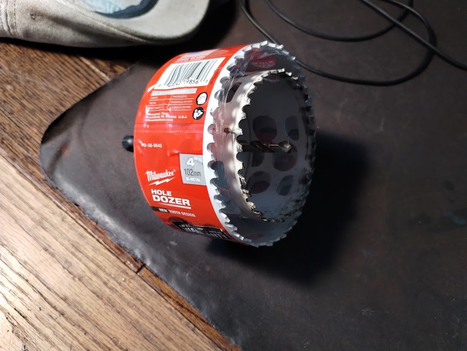

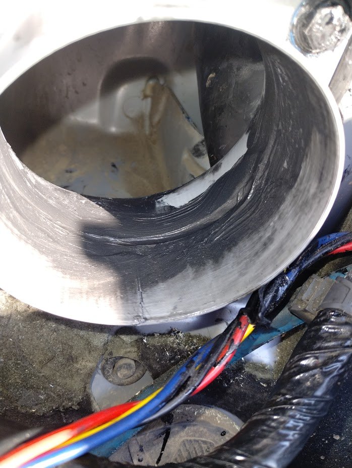

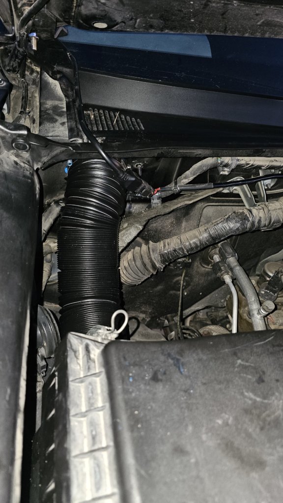

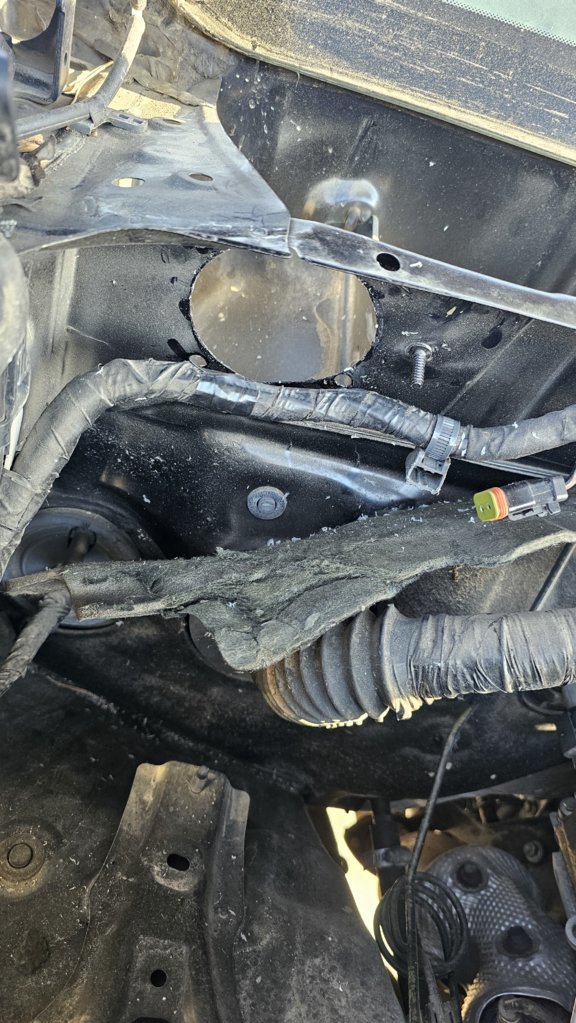

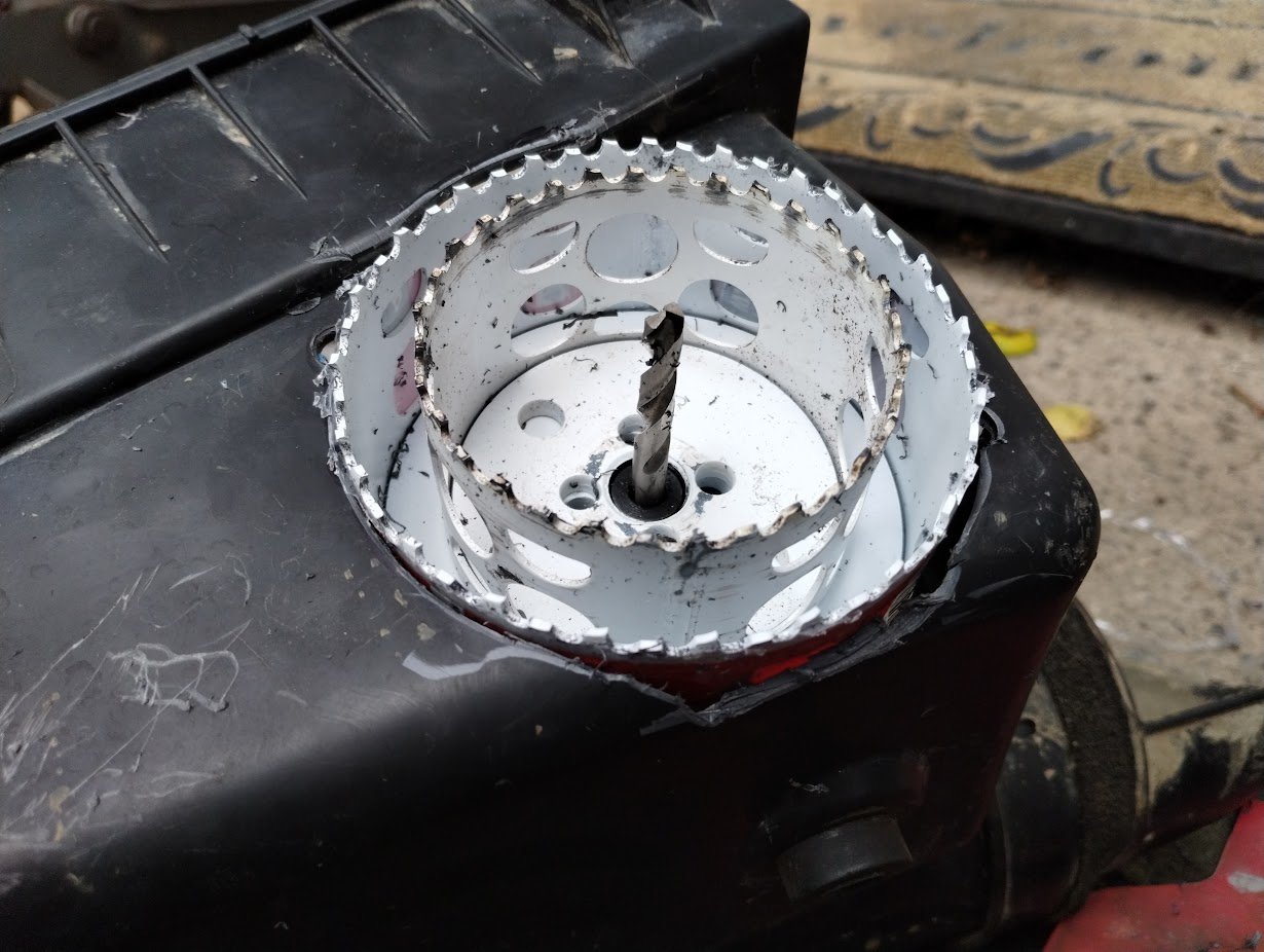

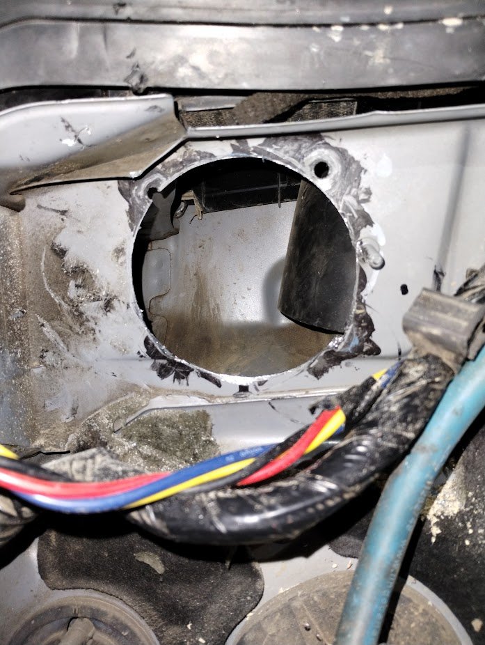

    Did you drill other holes in your crowl for more air? Do you have any photos? I only drilled the 3" hole into the crowl going to the air box
  12. Mar 16, 2025 at 12:03 PM
    #212
    Brownmatthall
    Jul 7, 2020
    #333712
    4,672
    2016 TRD OR DCSB
    Only drilled out the passenger side, I can't remember why but I think the driver side was more problematic and I figured I'd see how the truck did without it lmao. No issues at all in ~2 years of having the truck like this, no hvac backpressure or anything. But I would definitely take the time to open up that drain hole if you could
