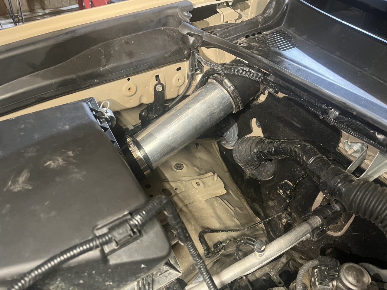

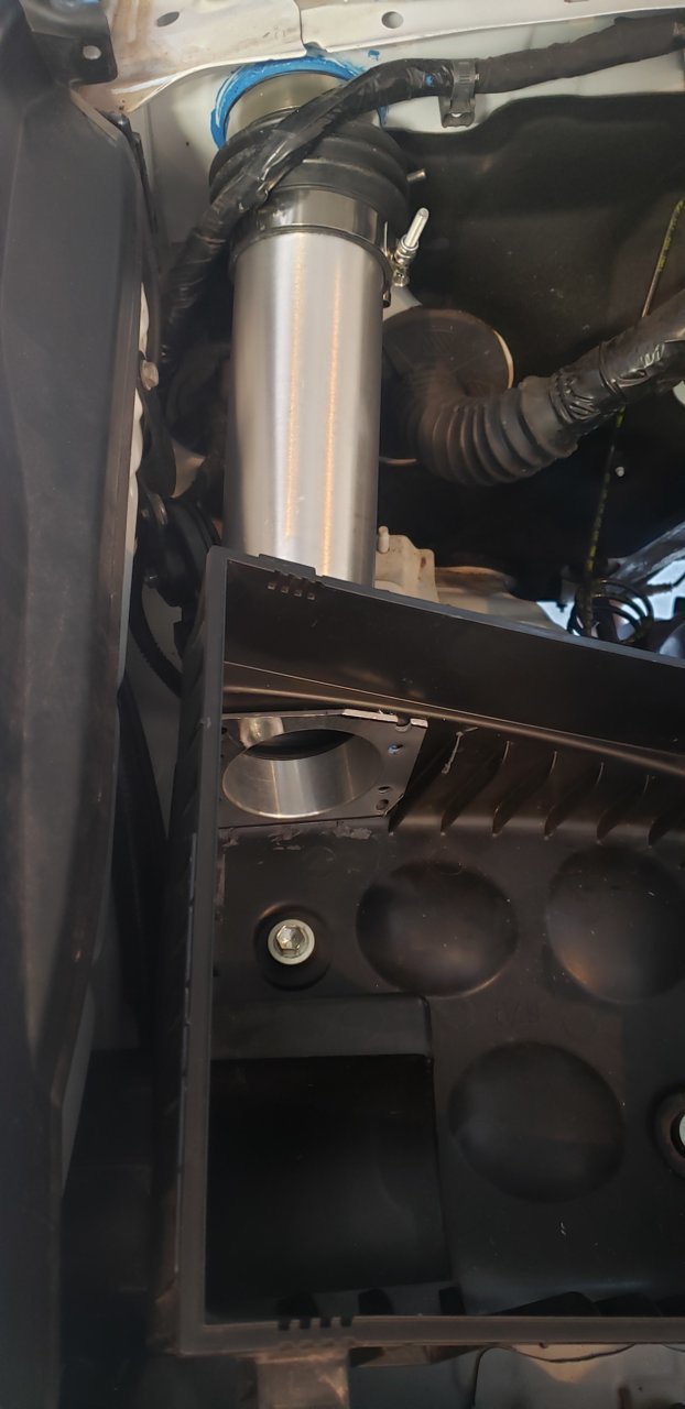

    Wrapped this mod up today. Honestly, it's pretty easy, just time consuming letting the RTV set up. Don't know if it was mentioned already, but I recommend using sensor safe RTV just to keep from screwing with the MAF sensor.
    The goal was to get it as tight to the fender as possible, and I think I did a pretty good job. Thanks for the knowledge OP!

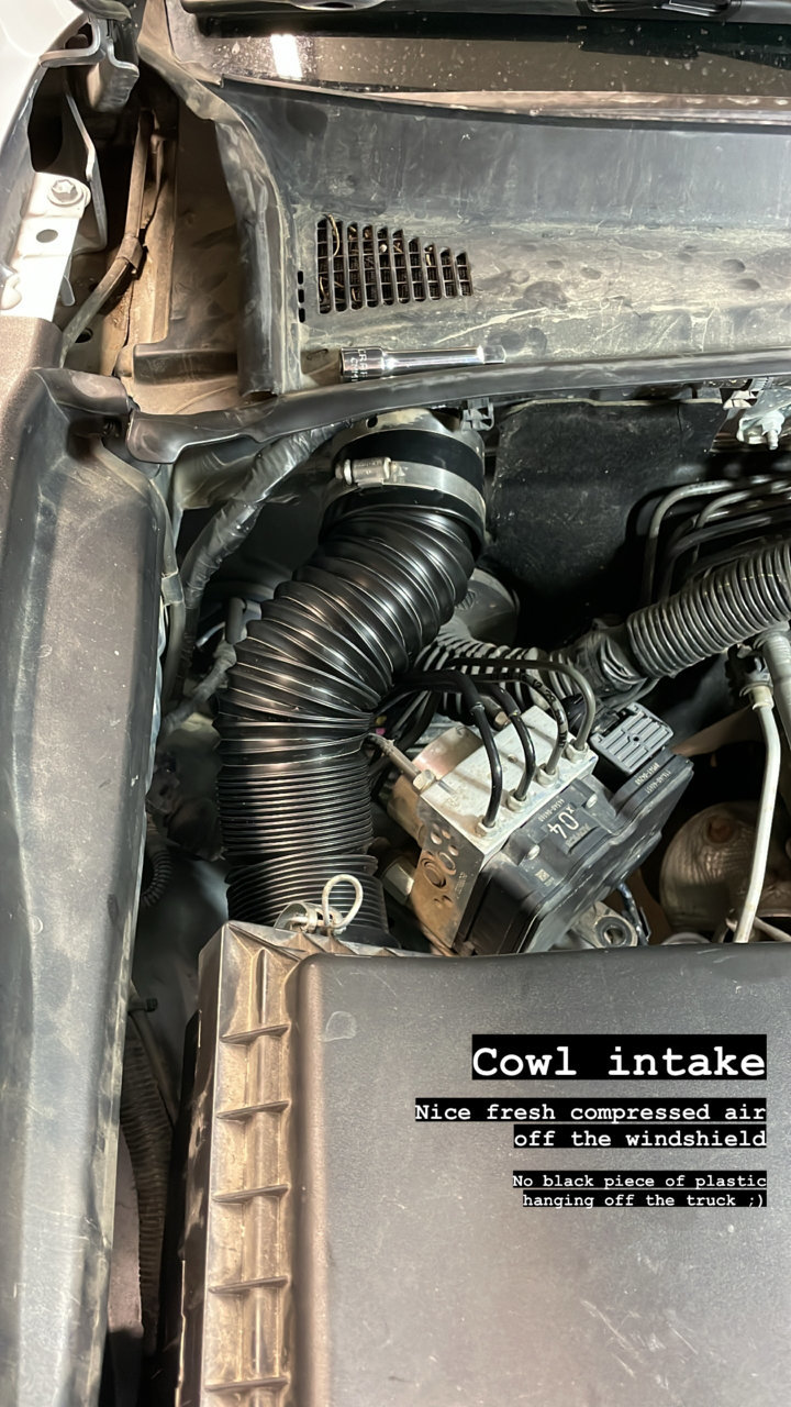

    17' SR5 DCSB

    Hey man wanted to report back as we have had a couple heavy snow falls where I am at. No issues so far, been keeping an eye on it and checking air box for water, nothing yet and getting air just fine.

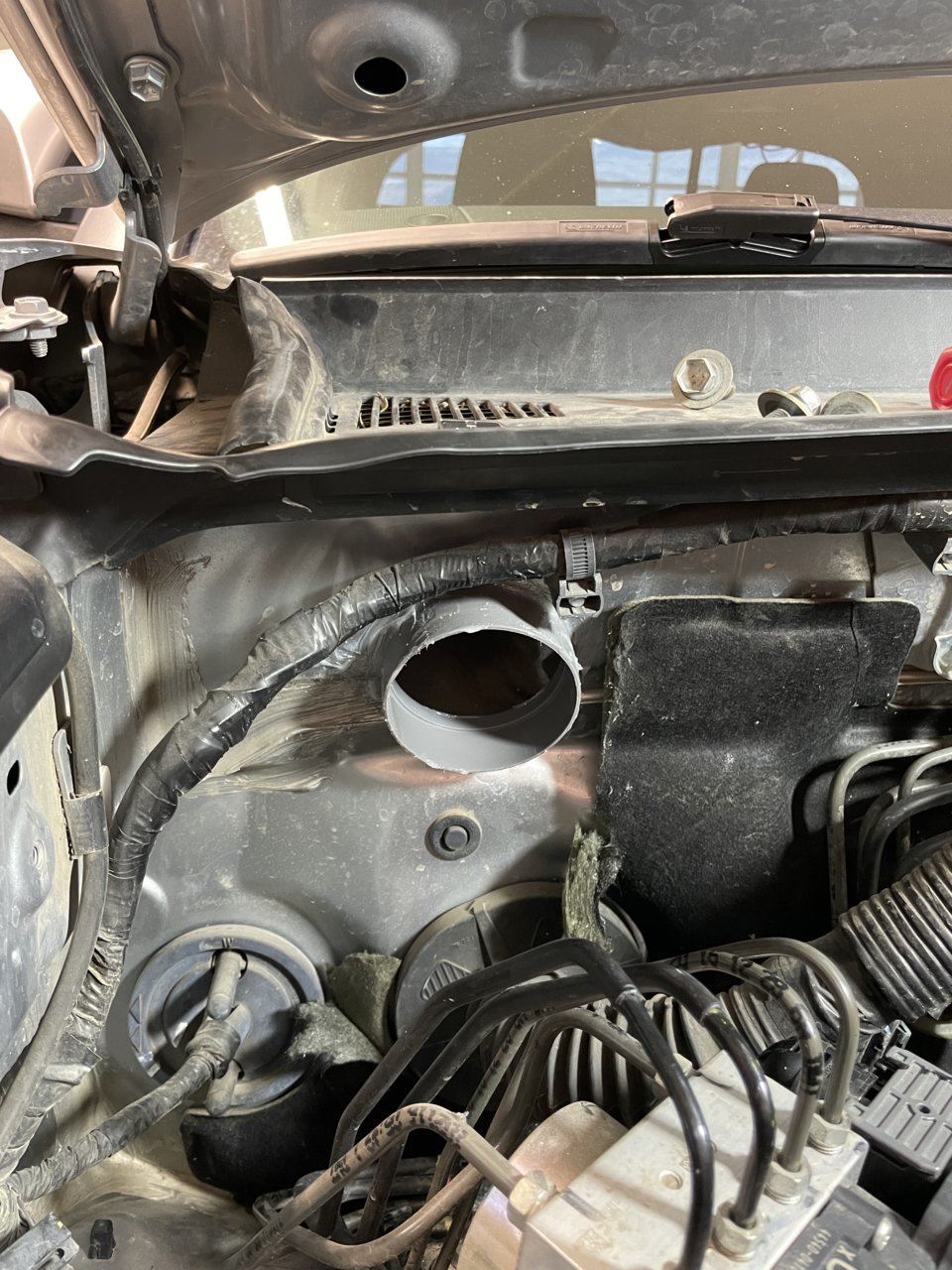

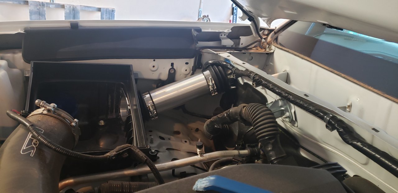

    I did this mod today, thanks for the write up to motivate me. Scariest part is drilling the hole in your firewall!!
    1F575004-8B79-4F77-AC9D-EF8B351707D4.jpg 743E3F53-29D9-44C7-BDC1-E6B0D94DD6FF.jpg
    I did have some help
