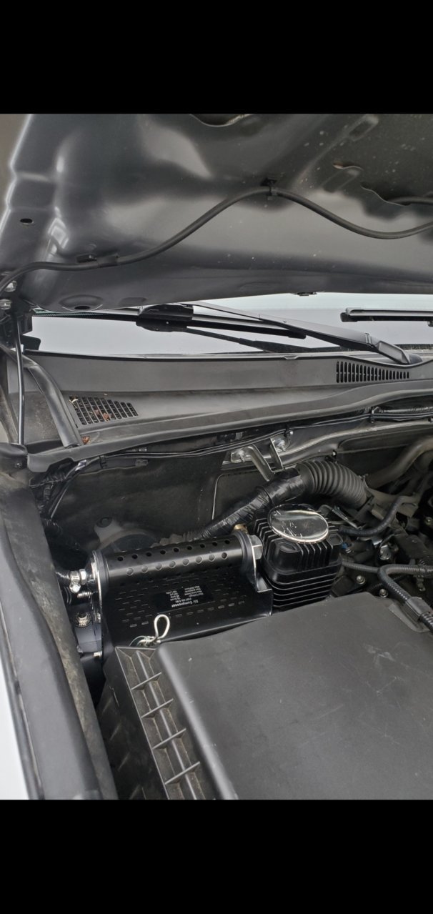

    About to do this, but run a tube from the stock outside location up into the cowl from the outside. Got a big compressor in the engine bay, and think I'm too lazy to move it else where :rofl:

    Part of me needs to move the compressor out of the engine bay though, since it starts out too hot in the first place on hot days. We will see what I do once I get around to it

    How big of a compressor? I used the flex line and ran it under mine. I did remove it for install though. No escaping that, ha.

    Big ole smittybilt, its mounted to the base of the fender.

    2019 Barcelona Red TRD 4x4 OR DCSB MT

    Not to derail this thread because I am interested in the cowl mod, but @Buttskevin21 how did you mount this air compressor there? have any other pictures?

    I’m curious about that as well
