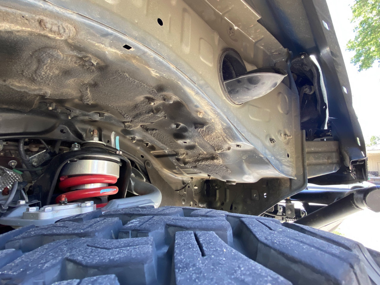

    Is that a spacer on top of aftermarket coils?

    Reason I ask is there is another member on here that put spacers on top of his taller coils. There reason was same as mine after beefy winch and beefy bumper lost lift . I'm just trying to do my homework cause I'm possibly thinking of doing the same .

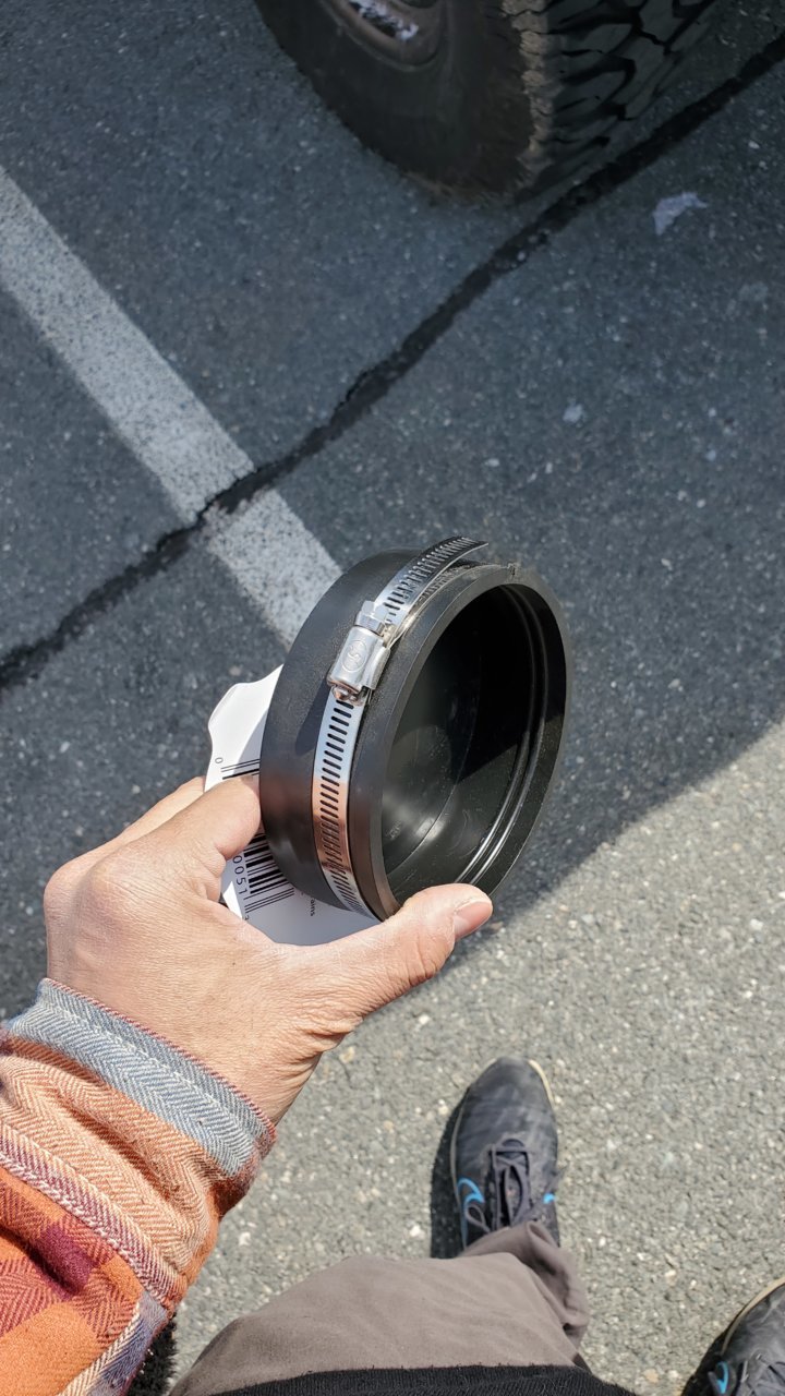

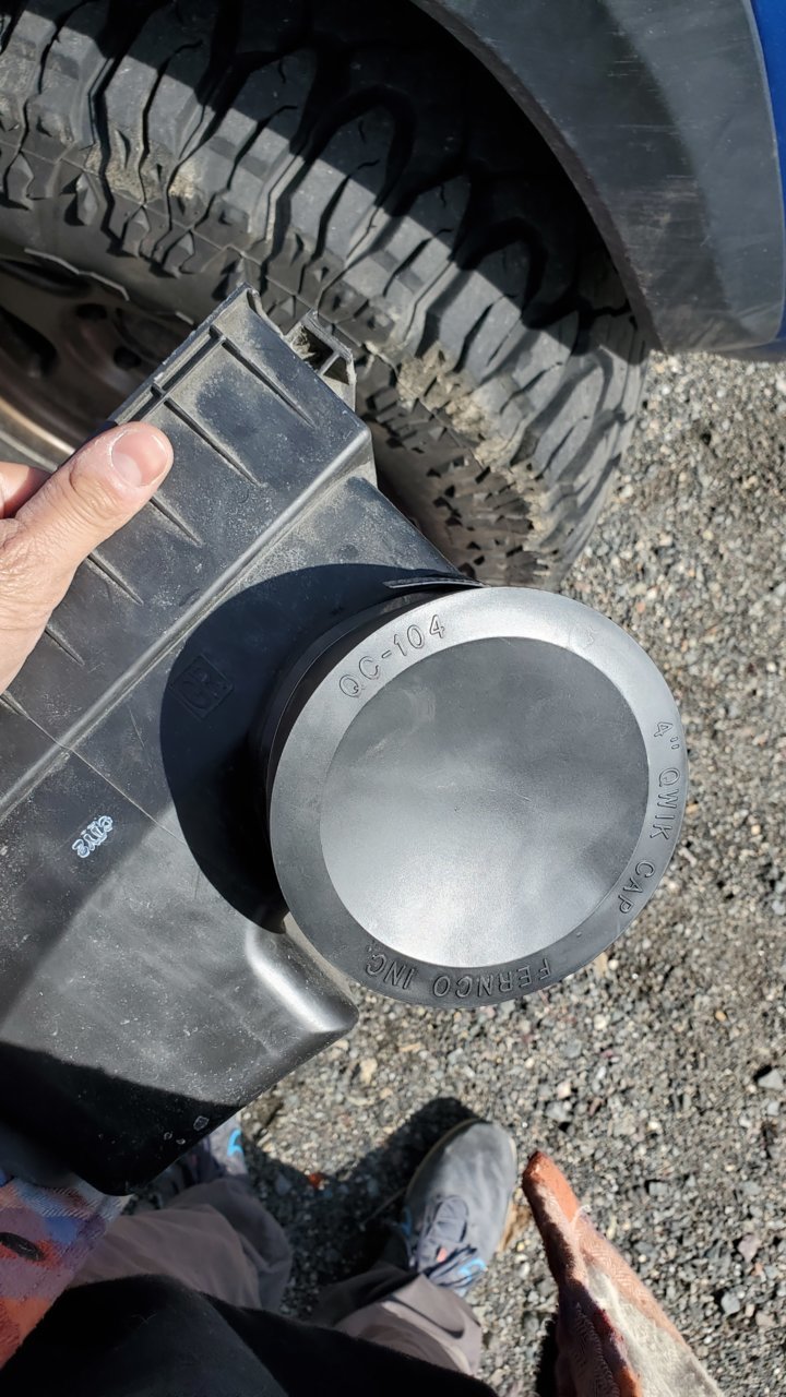

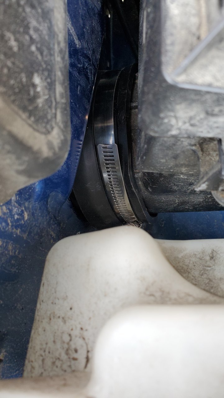

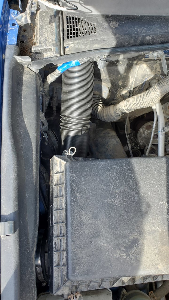

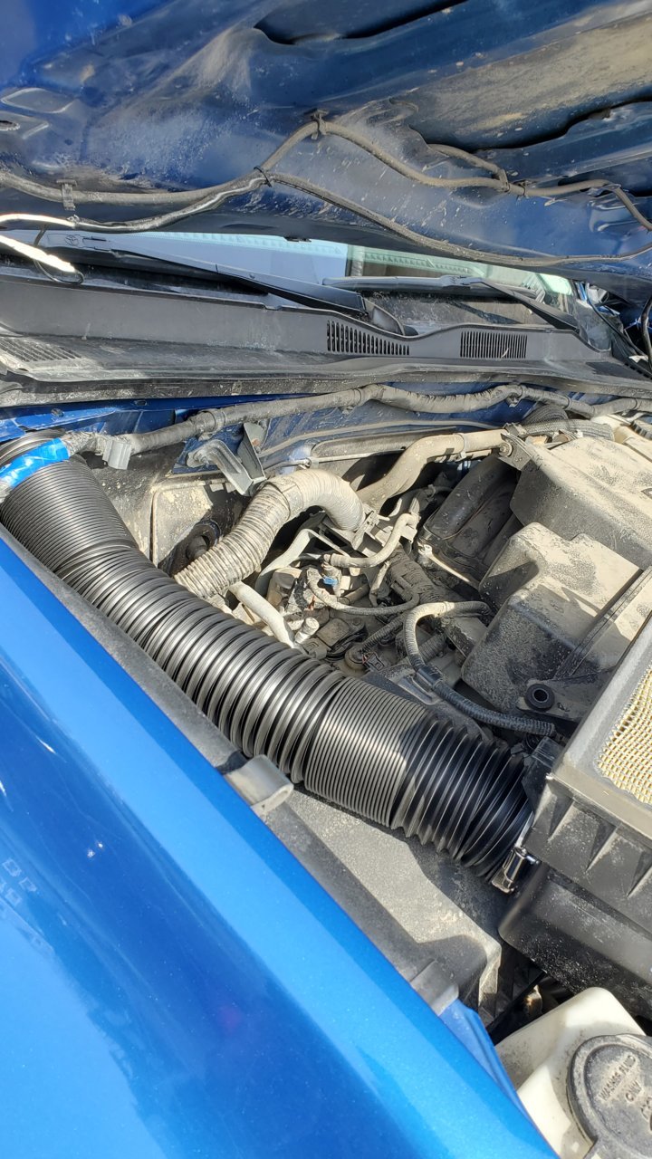

    Welp, installed the new intake pipe today and it went way smoother than I was anticipating. Once you pull the metal ends off of it, it seats into the flanges posted in the op nice and snug. Used some worm gears to fasten it on beyond that and I feel extremely confident in the seal. Also went to HD and picked up a 4" pvc flex cap to plug the old hole, tried a bunch of fittings in the parking lot (was planning on using pvc cement and sealing itb that way) but none of them fit. The flex cap was a smidge loose but nothing that cranking the worm gear down couldn't fix. All in all much happier with the mod like this and offers way more flexibility with it

    Nice work. I think I’m going to redo mine like yours.
    Also good call on the cap. I’m going to swap my glued in piece for the cap idea. Since in good ol’ CA this mod will fail emissions inspection. Being able to undo it easily would be nice.

    Being able to undo it was nice bonus to a clean, easy install. We've had snow since I did the initial install and I was super worried it'd find its way into the airbox so something like this was a no brainer

    It didnt but i have the fender "plugged" up, basically just plastic cover self-tapped on..so it does a decent job but not water tight by any stretch

    Yup, that was a big reason I went with this style over trying to make the silicone pipe work

    Into the cowl? I don't but i basically just traced the flange on the inside of the engine bay as high up as I could reasonably get it and just eyeballed it from there. definitely be careful with that wire harness though, i nicked the jacket but thankfully didnt see any copper so I retaped it. Also I wasnt able to fit my drill inside on the drivers side of the cowl so we just did 2 holes on the passenger side and really opened it up, no issues with airflow in the HVAC system
