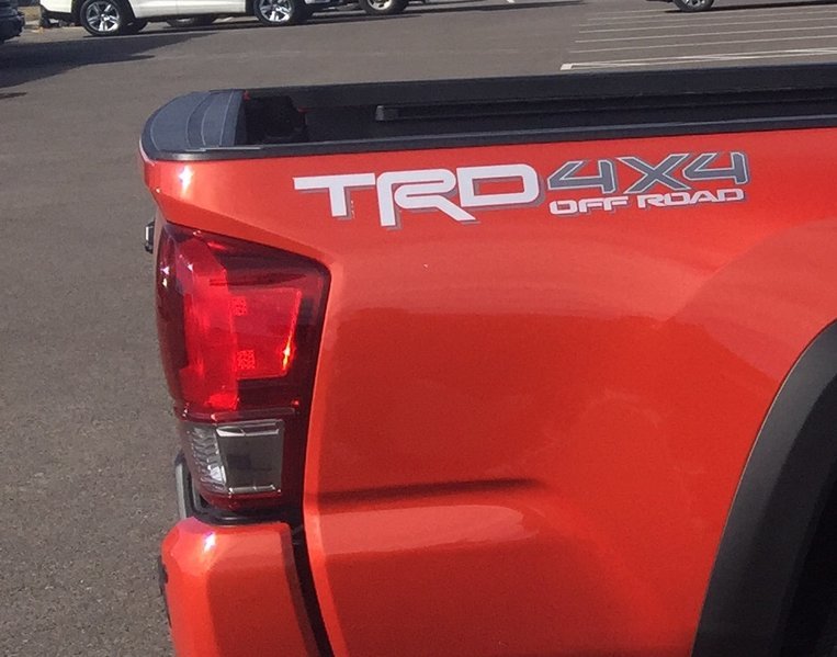

    I have a deposit down on a 2017 OR Access Cab Inferno. I had planned to move the Flip Pac from my 2004 OR, but noticed the tailgate on the '17 is about 1.5 inches wider at the center than at the edges (top of the tailgate). So it's not straight across at the back, like my rear window on the FlipPac is. Every topper I've ever seen has flat rear glass. In general, throughout time immemorial, tailgates, too, have been flat side to side. Now they're all faaancy!
    If you have a 3rd Gen and a topper, how does the rear glass fit the tailgate and close tight?

    IMG_3123.jpg. This is what I mean.

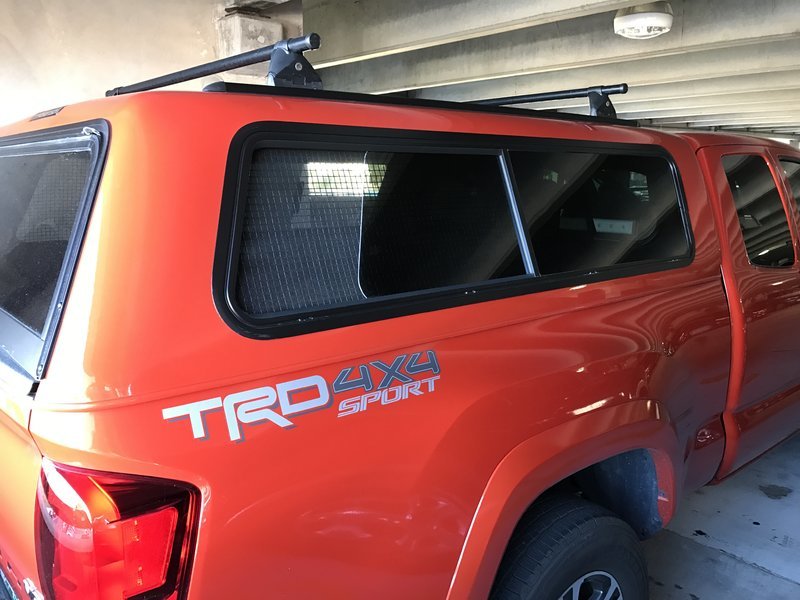

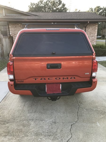

    Buy my topper, it has the molded piece on the bottom of the lift gate - it is listed in the For Sale section or you can PM me.
