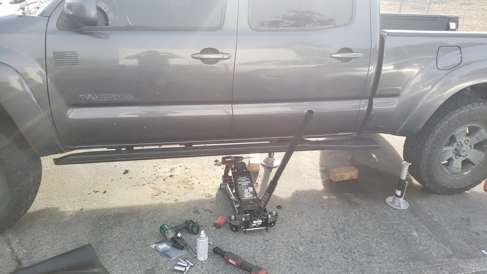

    I just finished the install of sliders, not ideal fit I have long bed and the rear brackets did not line up with the rear crossmember. I had to drill 2 holes on bottom. Most likely a couple more through the side and will need to buy more bolts. Other than that cannot complain for the price. I am going to figure out a solution to the crossmember possibly get welded .

    what if that’s just a longbed thing
    The wheel track is different
    sliders usually come in two fitment
    1. ACLB / DCSB
    2. DCLB

    Yes slider specifically said 16-20 shortbed and only in that configuration, for the price I had to take that gamble. They seem solid. Don't cover full length from tire to tire, but it'll save my cab from damage

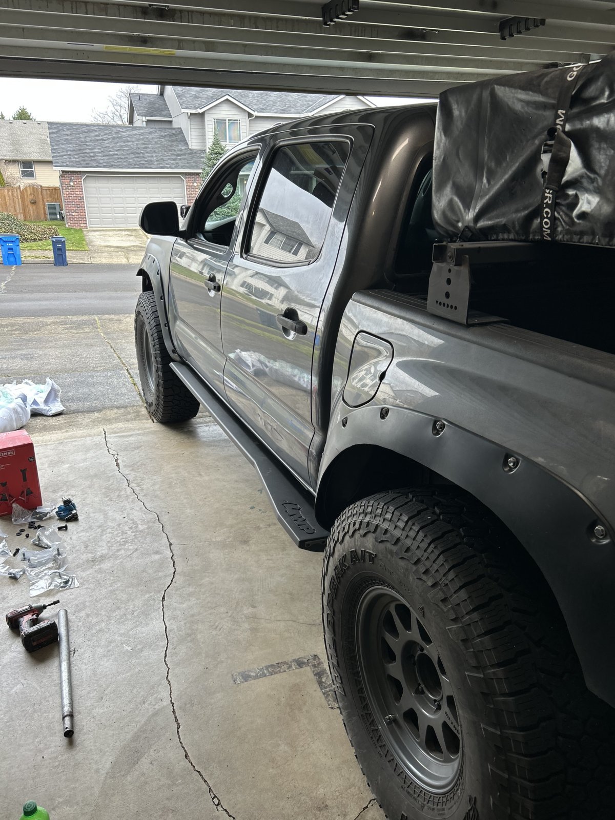

    Tried installing them and they didn’t fit due to misalignment on some holes for existing rivet heads to fit in. Looks like at least 5 holes will need to be widened/drilled per slider. I am going to sell them and look for another option. If I can’t sell, I guess I’ll try drilling. Such a shame.

    well, i chose to just drill. Took 6hrs and 2 friends. Only needed to drill one hole on the frame on each side.
    For anyone doing this in the future, go slow and use the front cross member mounts to line everything up down stream. There are relief holes in the slider to fit rivets on the frame so the slider sits flush that will need to be re-drilled. A couple holes in the frame will need to be expanded a little bit.
