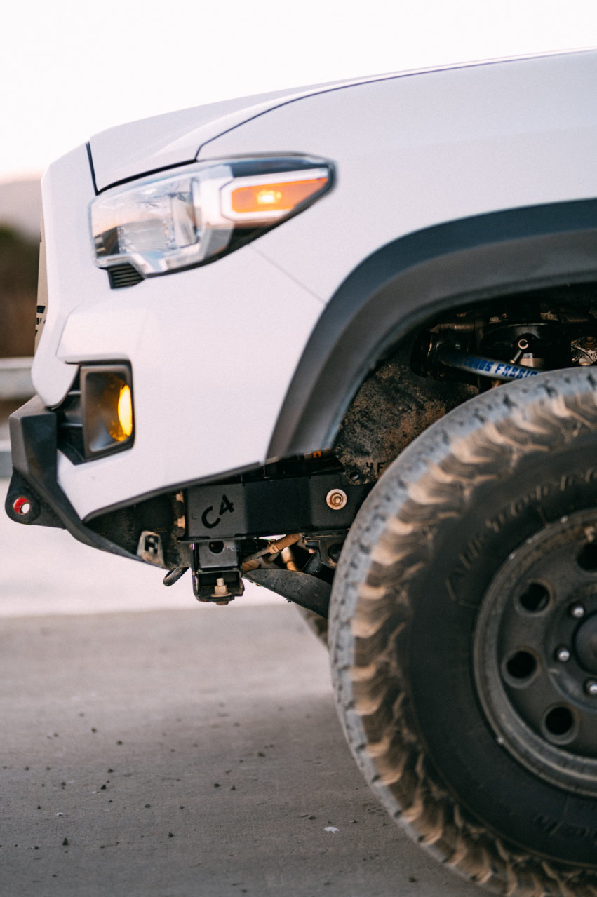

    OOOOOOO.... welcome to my world.... Im running two AGM Northstar's, BAMF Grill insert (heavy enough to mention.... trust me, BAMF full skids (all of them), C4 Low Profile Bumper, Relentless Fab Rear HC Rear bumper with swingout..... 33's.... and the truck sits level loaded down... and slight rake unloaded... DAKAR heavy packs...
    I preloaded about 1 1/4" or 31.75mm ... Thats what i needed to maintain a good height and I wheel the hell out of my truck, the valving is kept on the softer side of things with the rear in the mid to upper due to weight of all the stuff we carry on trips... hope this helps
    Here are shitty photos showing unloaded vs loaded.... shitty angles, but you get the gist...
