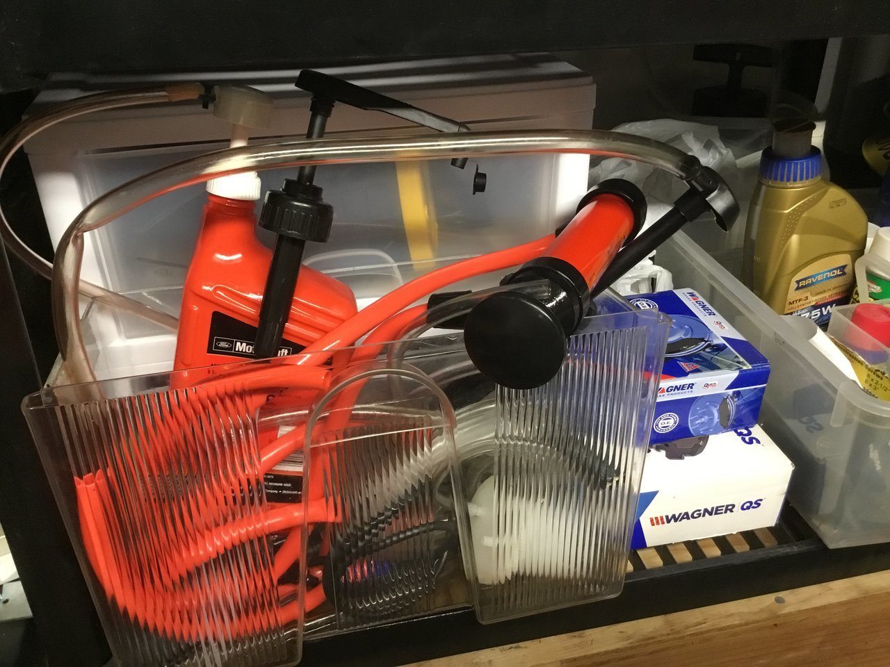

    May be a dumb question but how do you clean the pump between the manual fluid and differential?
    I had a neck sprain and a cold when I had mine done two weeks ago. The master tech who did it just pumped out the excess fluid and used the same 6 buck hand pump for all, trans, diffs, and transfer case.

    A small amount of slightly different viscosity gear oil mixed in probably isn’t going to damage anything,
    if that’s what they did.
    You could buy a second and third 6 dollar hand pump for different viscosity fluids.
    One can’t have too many hand pumps.

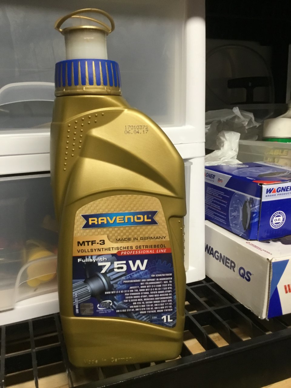

    To be honest, I believe most dealers do what you did. I’m just going to eat the cost on Toyota fluid when the time comes since I feel that it’s the “right” move for our transfer case. There’s a reason Toyota spec’d an odd fluid for the t-case and I’m not in a position to intelligently question it.
    Ravenol has come up multiple times but information on their fluid is limited at best. The Toyota cost is absurd but it’s the only choice I feel comfortable with. I’m halfway hoping someone uses magnuson-moss to make Toyota offer up the t-case fluid for free or a discounted rate.

    Toyota manual says use a 75w85 gl5 gear oil in the front and rear diff, and a 75w90 gl 5 in the transfer case.
    a personal observation is the 75w85 oil is very thin like water compared to the mobil1 75w90 oil is like syrup when I did my 30k gear oil change.i used Redline 75w85 gl5 in the rear diff and 75w90 in the transfer and front diff and noticed how much thicker the 75w90 is compared to the 75w85. that's probably why u lost 1-2 mpgs

    Cool, thanks. For the record, the manual does NOT say 75W-90 for the T-case. It says straight 75W, which is different. I did use genuine Toyota 75W-90 for the T-case because the straight 75W T-case fluid is $60 F*** that! However, I am probably going to switch to the 75-85W fluid for the rear diff (Redline's)
