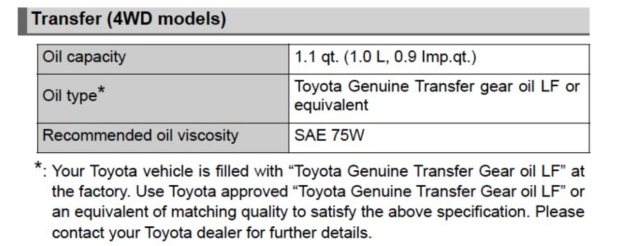

    3rd Gens (which is what we're talking about) call for 75w GL-4:

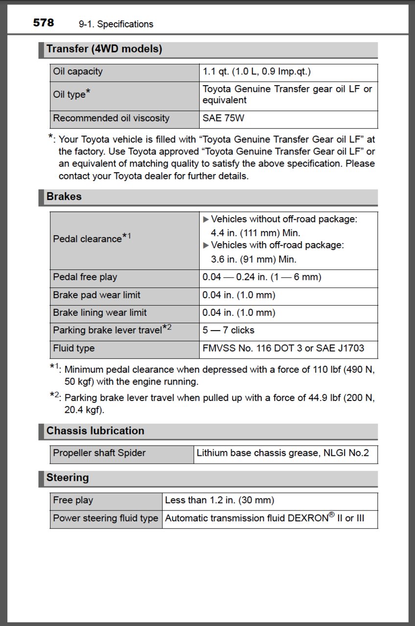

    GL4 for Manual maybe. GL5 for Auto.
    No mention of GL4 in the image

    You're right, doesn't say GL4.
    Just says "buy only Toyota's special sauce for transfer case" :confused:

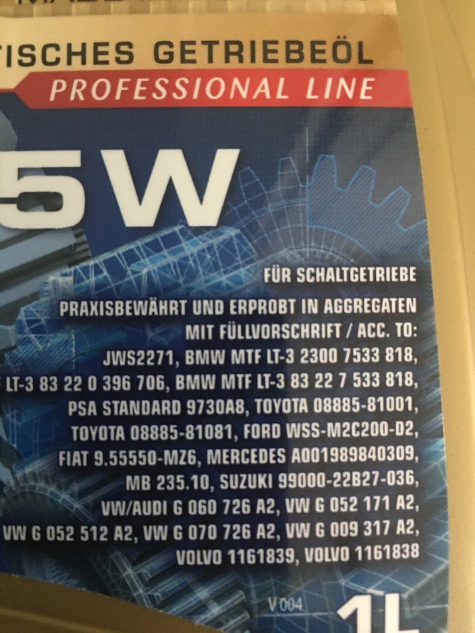

    So, I changed the T case fluid with Ravenol. A few notes:
    I didn't look closely, but I thought it was a quart. It is actually the full liter that we need. It was filled perfectly.
    The bottle is odd. I've used ones like Pentosin that had an integrated spout. This has a spout and a straw. I was able to fill the T case without a pump.
    The fluid in the case was in great shape. Much fresher looking than the transmission or diffs.

    Cool just ordered 3l. Have my Tacoma and a 4Runner to do. On the bottle it states it is a replacement for Toyota’s 75W transfer oil. Thanks!

    Got the goods. Shows it is a replacement for Toyota 75w transfer gear oil.
    $15 a Liter on Amazon.
    Thanks!
