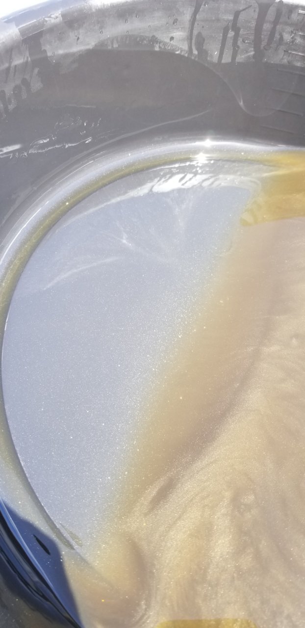

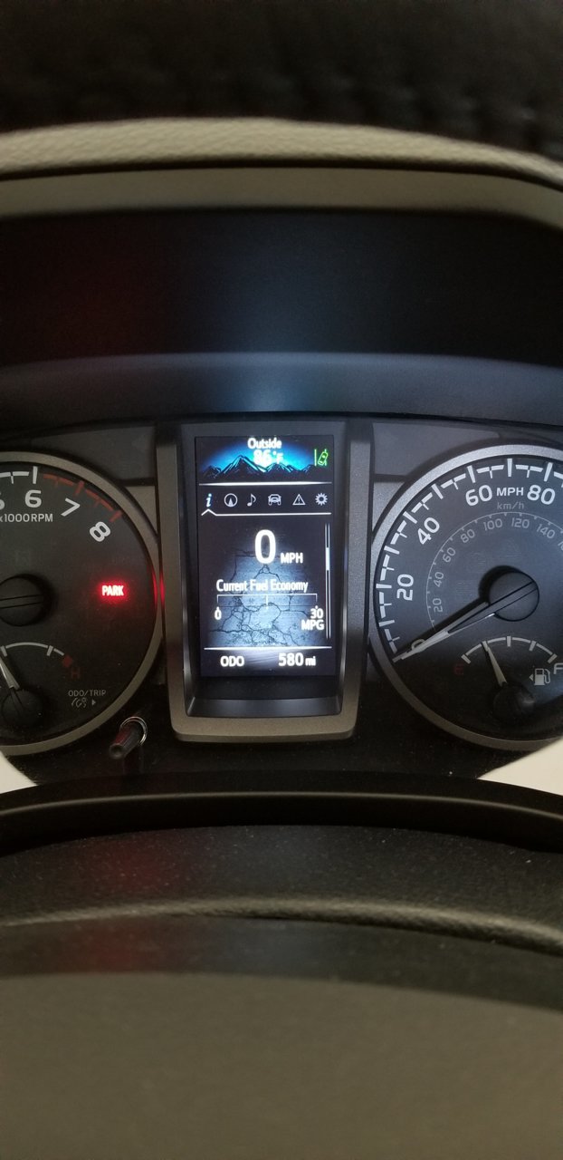

  20. May 5, 2018 at 2:09 PM
    #260
    TRDNoPro
    TRDNoPro Well-Known Member
    Apr 2, 2018
    #249184
    104
    John
    Queens, NY
    2020 Land Cruiser Heritage Edition
    @Omar RVA a big thanks for posting this. I changed out the MTF at 580 miles and unreal how shiny it was. Metal flakes galore. I only drove a few miles to see if there was much of a difference and it does seem to go into 1st from 2nd a bit easier when coming to a stop now.
    tonered and Omar RVA[OP] like this.
