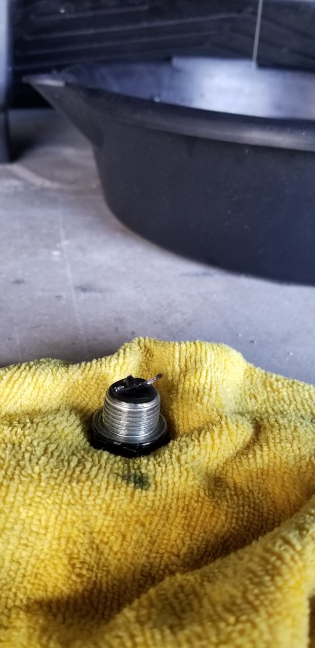

    Wanted to share this pic as I wait for the rest of the rear to drain. Protruding from the gunk on the magnetic plug is a nice sized metal shaving!
    Edits (added) - The drain plug for the front diff was caked up like the rear one except without any huge metal chunks.
    The rear drained barely 3.5 qts and took just over 4 qts to fill.
    The front drained about 1.5 qts and took about the same to fill.
    1558 miles

    How was the fluid color?
    OA

    Pretty dark compared to the Amsoil fluid. Dark dark grey/almost black if I had to give it a color if that makes any sense?
    Omar RVA[QUOTED][OP] likes this.

    Sounds as though it looked like mine. Odd QC from Toyota...
