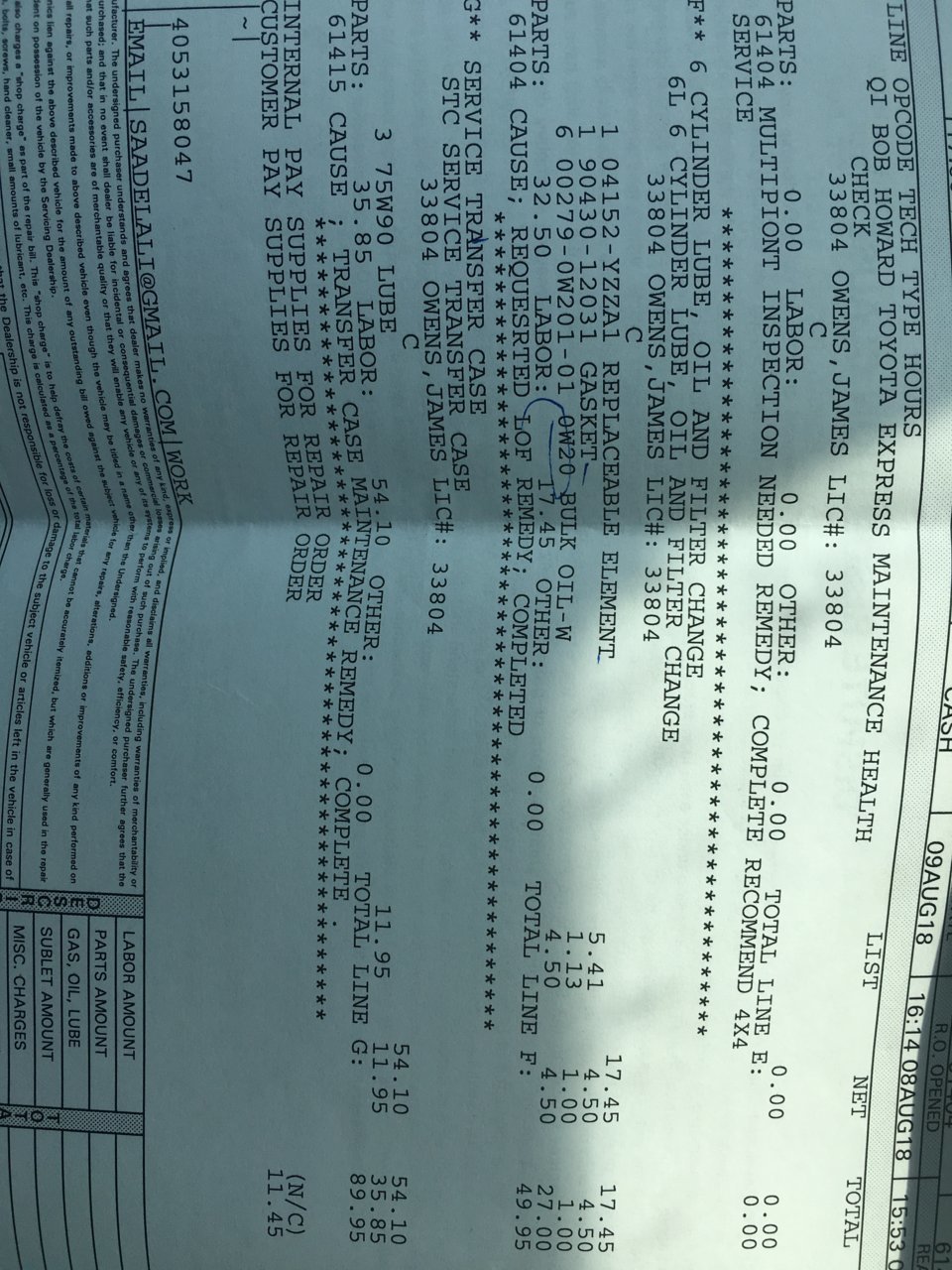

    So I figured I will use 75w90 for front and rear differential but did not want to mess with the transfer case oil so I went to the dealer and verified they use genuine Toyota oil and had them replace Tcase fluid! When I was reading the printout it looks like they used 75w90 on the TCase! What u all think of that!?

    You’ll likely be covered in case of issue since it was dealer performed. That said, this is a common anecdote and one that doesn’t make sense (that Toyota would spec such a unique and expensive fluid and the dealers, across the board, don’t care).
    I’m not familiar with 2nd gen common issues but I would wonder if they spec the same fluid and have issues after years of use on dealer replaced 75w-90.

    Well I thought I was getting a good deal by them quoting me 89$ to do it which is cheaper than Replacing it myself using there fancy oil! That’s the only reason I had them do it! I did my own differential with 12$ mobile 1 75w90 and if I thought that is what they were going to use I would of did it myself and saved time and money

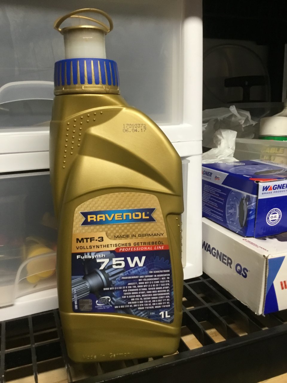

    #286
    tonered
    tonered bartheloni
    Sep 25, 2017
    #231055
    31,227
    tony
    Lynnwood, WA
    Ravenol, shown in the box below, is correct for the T case and is less than $20.
