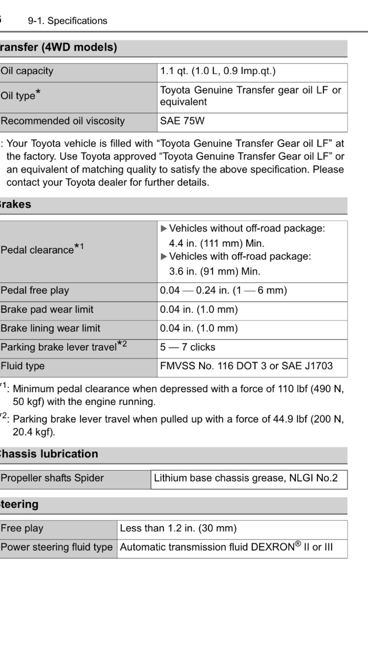

    This seems to be a standard experience. Many or most, perhaps not all, Toyota dealer service center have no knowledge of this magical LF fluid. Mine had never heard of it, and they probably service 5 Tacomas a day.

    Yeah, it specifically calls for straight 75W GL4 which has less sulfur than the 75W90 (75W85 actually) GL5 gear oil in the diffs.
    I’d make them credit you the cost to change the Tcase fluid and get a bottle of Ravenol and redo it yourself. It’s like $16 a bottle

    The owners manual doesn't specify if GL-4 or GL-5?

    I don’t have the manual with me, but I thought all straight 75W were GL4 specifically for Tcases and Manual Trans.
    If you have the owners manual info let me know

    Redline Oil make an SAE 70w/75w GL-4 and a 75w85 GL-5 that also subs for 75w. Not sure which would be appropriate as the owners manual doesn't specify GL-4 or GL-5.

    The manual only gives us the mysterious “LF” 75W label for the T-case. No Gl rating.

    I see, thanks for the info. My only concern would be that GL5 for the diffs has more sulfur which isn’t good for manual trans syncros. Wondering if this would apply to the Tcase, as well?

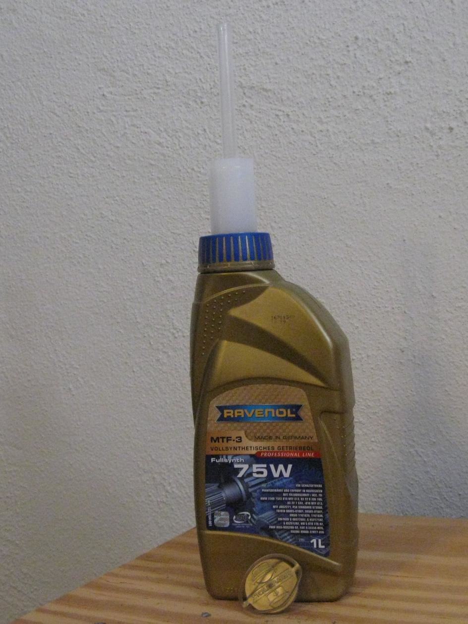

    It is just a simple fact that the dealer will never change any fluid other than the engine oil in my Taco and only for the length of ToyotaCare. I feel that Ravenol fills the bill as an option to the Toyota brand. Myself, I am not risking the t case by using gear oil spec'ed for the diffs.

    There is one bronze synchro ring in a T-case, which sees 1,000,000 times less use than the synchro rings in a manual transmission. The issue of sulphur eroding the surface of yellow-metal synchronizer rings is really only an issue when they are engaged or disengaged often, as the sulphur work-hardens the surface. Unless you are going back and forth between 4wd and 2wd constantly, it is likely not an issue.
    My best guess: this LF fluid stands for “low friction” and is used for fuel economy. In a Tacoma transfer case, the chain runs all the time due to the lack of locking hubs. I imagine a small amount of power is absorbed running the chain through the oil bath so they want as little fluid resistance as possible, hence the light oil. Same reason they are using 0W20 in the engine. It’s all about saving fractional amounts of fuel.

    It isn't so much that gear lube is good or bad. It's that there is an oil that meets the spec for a very reasonable price. From that standpoint, it cramps my brain (easy to do) to use anything else.
