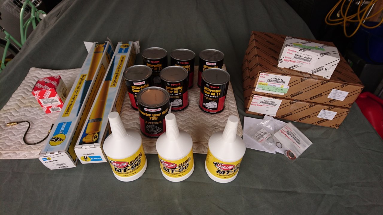

    Just did all mine at 60k as well (except transfer case) using Redline-
    Rear looked great, but the dealer changed it around 20k when I was complaining about the rear end whine.
    Front was pretty nasty... likely should have changed it sooner, but whatever.
    Transmission looked new and perfect. I really think it didn't need it.... but now fresh MT-90 is installed. I will likely push the change on that oil to 100k before I do it again. It might be shifting very slightly smoother, but the change, if it exists, is minimal enough it could also be my imagination.
    After seeing how great the tranny looked, I decided not to bother with the transfer case.
    Oh and note for whomever reads this... I got all new drain plug gaskets, but in my opinion it is not necessary, certainly not on a first or even second change. They are all copper washers, none of them are the "crush" style. With proper torque I show no signs of leaks. So, I would recommend saving your $7 on the new washers :).
    Curious.... also did the ECGS front bushing while all this was going on. I noticed they recommend Lucas oil 85w-140 non-synthetic for the diffs. I'm running 75w-85 Redline full synth. Anyone have any ideas why they might recommend that oil? Anyone running it? I might do my diff's again in another 30k and switch to it..... but then again not sure it makes a single bit of difference.... mostly wondering if anyone has spoken with ECGS ever on why the recommend that oil. https://www.amazon.com/Lucas-Oil-LU...0T0?psc=1&SubscriptionId=AKIAILSHYYTFIVPWUY6Q
